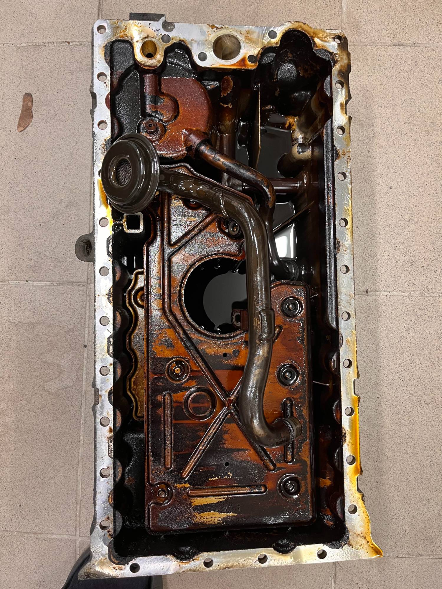

....and the results
Problem fixed, and it was the lose bolts that holds the torque converter.
So happy now because last week I had my mind set on a replacement engine.
Now I might have the cleanest oil pan in this forum also
Big thanks for your support

Nicely done! What did you use to clean it? I think this next on my list of things to do on my car, I was going to drop it in the hot caustic tank but would prefer a gentler method of cleaning.

New here, new to Volvo. I changed a rod bearing a few weeks ago. Pan was horrible. Tried different solvents and cleaners. On a lark I used powdered laundry detergent and my before and after look like greffel's, maybe more extreme on both ends. I didn't take pics, but pan was shiny like new.

We filled up the oil pan with this exact detergentBlacklab467 wrote: 12 Aug 2023, 18:39 Nicely done! What did you use to clean it? I think this next on my list of things to do on my car, I was going to drop it in the hot caustic tank but would prefer a gentler method of cleaning.
https://www.biltema.se/en-se/car---mc/c ... 2000041533
Not sure what product you have available in Canada
