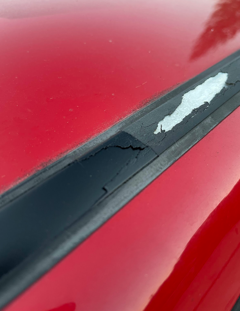

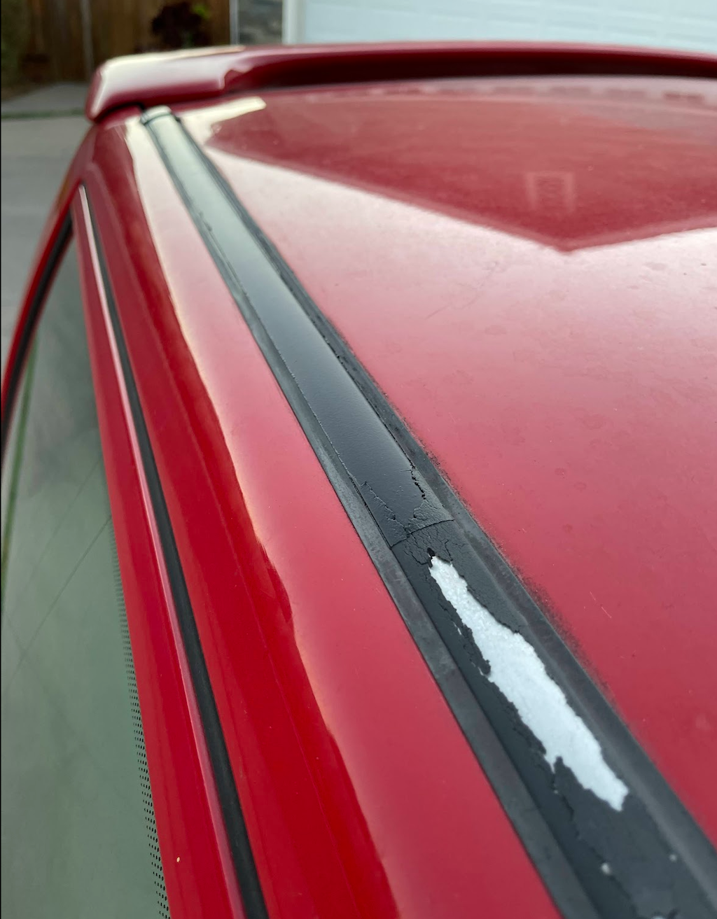

So I don't have an 850, but my V70 had the same issue. I ended up using a razor and cutting off all the old cracking vinyl. Then I used acetone to clean up the aluminum and finished with black Plasticote. It turned out pretty good, but we will need to wait a while to see if it lasts.
Here's a picture of the transition between the refinished Plasticoat and the original flaking parts.
Refinish with Plasticoat?
I did only a portion to see how it holds up before I do the whole thing.
I had also tried some undercoating and that was a disaster. It turned grayish and had a rough stipple finish.
Here's a more expansive view so you can see how much I experimented with.
Testing a section for repair.
More Plasticoat.png (1.56 MiB) Viewed 235 times
I may do the rest of one side and then wait a while for a final verdict.
