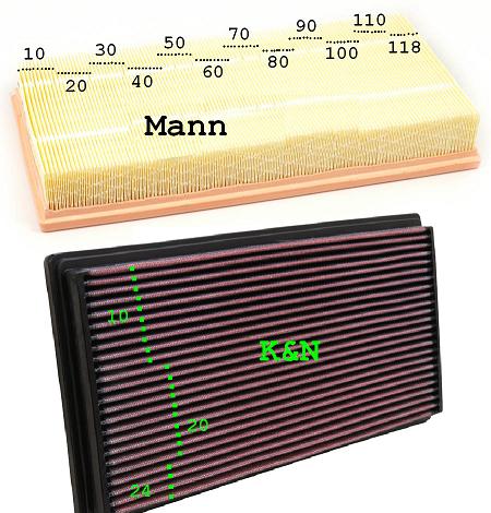

FILTERS BEST: plate welded over hole = no dirt gets in, but neither does air.
FLOWS BEST: totally open to atmosphere = no air is kept out, but neither is any dirt.
ENOUGH SMALL HOLES WILL FLOW AS MUCH AIR AS A BIG HOLE, and only "small" dirt particles can get through, nothing "big"ger.
So comparing a K&N to a Mann filter, and using the K&N's dimensions for both (H: 1.5", L: 13.625", W: 7.125", because I'm too lazy to go out and measure my non-K&N), let's compare the surface area of the two filters. K&N has pleats running the length of the filter.
P(leats) x 2 x H(eight) x L(ength)
24 x 2 x 1.5" x 13.625" = 981.00 in^2
Mann has pleats running the width of the filter.
P(leats) x 2 x H(eight) x W(idth)
118 x 2 x 1.5" x 7.125 = 2,522.25 in^2
K&N has 39% the filter are compared to Mann.
Mann has 257% the filter area compared to K&N.
Now, how much "bigger" would the "holes" in the K&N have to be to "flow better" than something that has two-and-a-half times more surface area?
Here's a test. Disconnect the and wipe clean with a water-dampened paper towel (A) the inside of the tube just downstream of the Mass Air Flow sensor, let dry thoroughly, install a fresh Mann filter, and run your car back and forth 10 times down a dusty, dirty road. Disconnect tube, wipe with another towel (B), install new K&N filter, repeat 10x trip up and down same road, disconnect and wipe with yet another towel (C). Which is dirtier, B or C? For good measure, clean tube again and this time run the K&N first, wipe, then Mann, and wipe. Compare towels again.
Question: Why would an auto maker (e.g. Volvo) go to lengths to design a motor system efficient enough to balance mileage and power, then "choke" it with a "restrictive" air filter, especially when competing makers could do it so their motors out-perform [Volvo's]?
Question: If K&N is so good, why aren't they or a similarly-designed filter OEM?
Question: Since dirtier air wears things like piston rings and valve guides faster, how much does one have to save on air filters to offset the loss in performance in the long term from leaks (not to mention more PCV system fumes) as well as hastening the need for a head job?
Question: Are racers who use K&N filters concerned about piston ring and valve guide wear considering they rebuild their motors between race weekends? How often do non-racers rebuild theirs?
Question: With paved (non-dirt) roads and generally good air quality, how long could someone "get away" with running no filter at all?
Question: If oil is so good at "trapping" dirt, why did manufacturers stop using oil bath filtration systems in favor of paper filters DECADES ago?
Question: Do people who compare the two by replacing a "dirty" paper filter with a "clean" K&N also compare replacing a "dirty" K&N with a "clean" paper filter?
