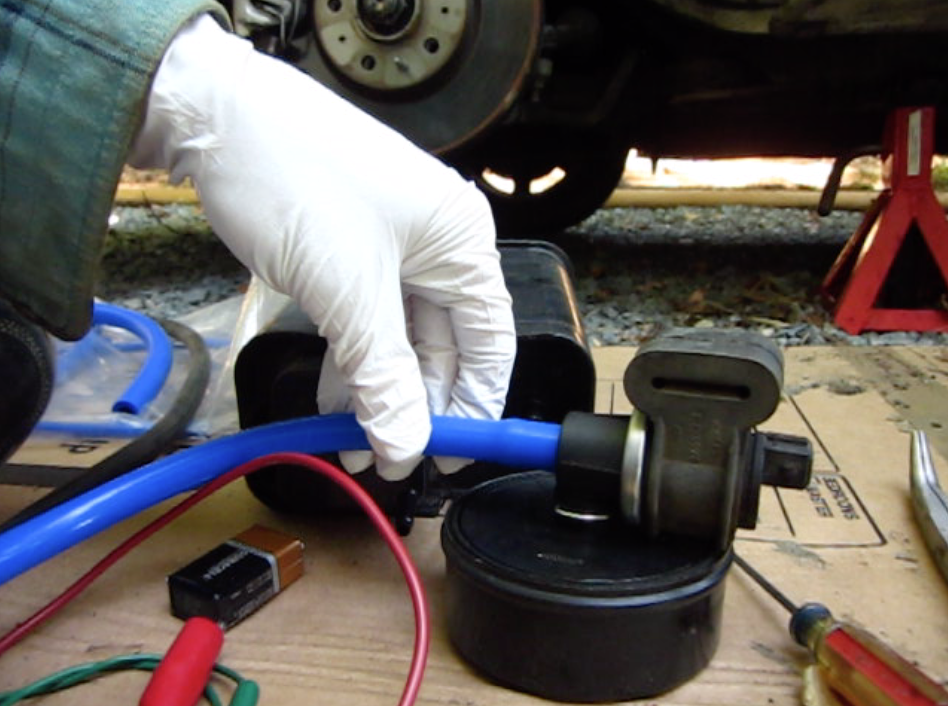

Ok, I took off the plastic liner, looked around the charcoal canister and voila! the hose going to the AIR nipple is rotted. Clearly I do not want to replace the entire hose so is there a specific type of rubber that I need to splice in? Since this is the vent, I should not have to worry about fuel vapor rotting the hose so can I simply buy something of the same size and "magically" splice it in? In the meantime, can I simply plug the AIR charcoal canister's nipple?

I had good luck using 8mm inner diameter silicone tubing to replace the line between the charcoal canister and the air vent valve.
8mm ID silicone line
