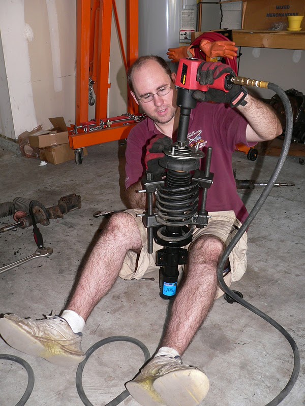

Wanted to add my notes and pics as when I did it I was a bit lost a few times but got through it.
I was working on a 95 850 NA. Ordered from FCP all OEM. I thought about going aftermarket but thought better of it, it was about a $120 savings. Not that much over 100k miles.
If you have an air compressor it makes it SOOOOOOOO much quicker and easier. I had the struts out in about 15 mins. The end link was nothing - 16mm wrench on the back and a 15mm socket on the front zippppp it's off. Same with the strut mount bolts. 17mm wrench and 18mm socket (or vise versa) bam right out. I would highly recommend getting a compressor and impact if you are going to attempt this repair (good excuse to buy one). Makes taking the strut mount bolt off easy as pie as well.

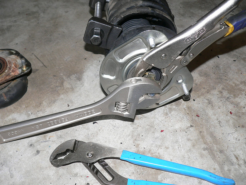

1) Special star nut. I couldn't figure out how guys were using a pipe wrench to get it off. I used a large adjustable wrench to hold the strut and a pair of vice grips to grip it. With a little muscle it popped right off. Same to re-assemble.

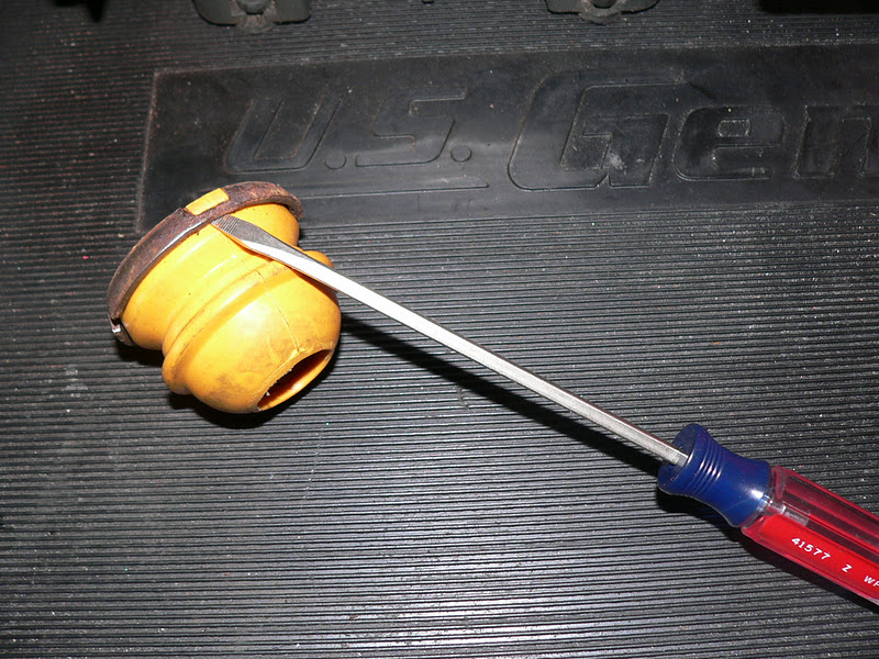

2) The bumper (new) to assemble I used a new rubber bumper. Had to pry the tabs on. Not a big deal but just didn't know how it was done as the old one was basically dust.

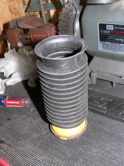

3) Dust cover just fits up in the bumper.
