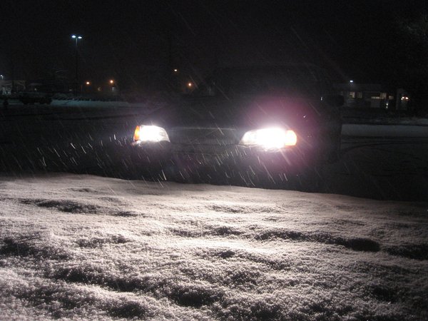

Automotive Lighting consultant Daniel Stern has some good information about bulbs. In particular the difference between the Osram SilverStar bulbs (available in EU) and the Sylvania SilverStar bulbs (available state-side). They are different.
See the bottom section of this page:
http://www.danielsternlighting.com/tech ... /good.html
The Sylvania SilverStars are fully coated (head to toe) with a slight blue tint.
The Osram SilverStars are only have tint on the tip and base. There is a center section of glass without tint. I personally think the tint is less than the Slyvania's.
I personally do notice a slight difference between the Sylvania's and the Osram's. The Osram's are more "white" than the Sylvanias (which seem white with a touch of blue). The Osram's seem (to me) to have a slightly brighter beam. I don't notice much of a difference between the Sylvania SilverStar and Sylvania SilverStar Ultra though.
The Osrams are available in European H1, H7, H4, etc... sizes only. They're not available in the SAE 9006/9005 sizes.
I get the Osrams from powerbulbs.co.uk. They have a store on eBay that sells at a pretty significant discount (vs. their actual website).
Oh, and yes the Osram's do get eaten. I can get about a 18 months out of them. That's w/o DRL. Compared with the 240, I've never changed the sealed beam in the 10+ years I've had it...
