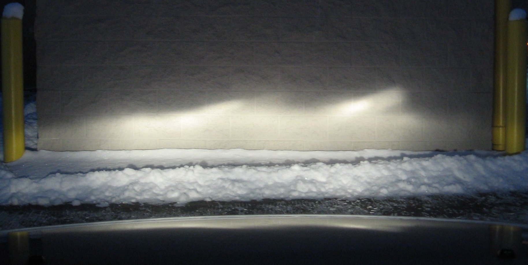

E-code lows ( ScanTech) :

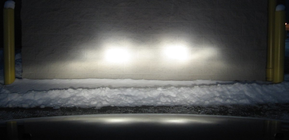

E-code highs:
The results are very perceptable to me
and AFAIC, at the end of the day,
that's what matters. 8)

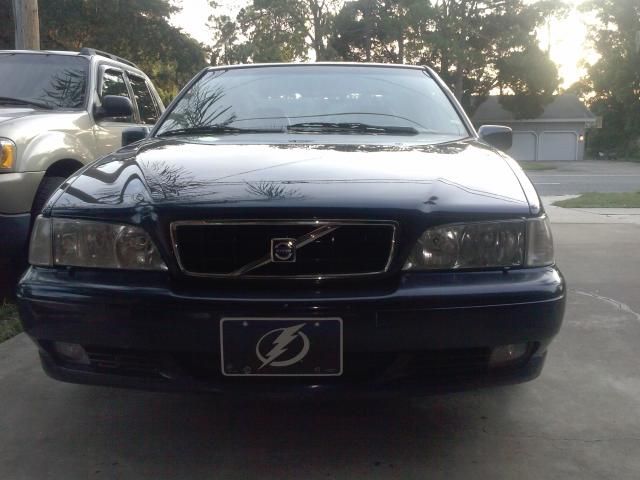

Probably you've figured it out by now if the 03-04 C70s work on our S70s. I just got a pair yesterday from an 04 C70 convertible and they were glass with Volvo and Hella imprints. I mentioned "convertible" because the counter person at the junkyard had to be sure my car was a convertible (i doubt hardtops have different headlights anyway) but they light up the road much better than the fluted ones and drop right in.
