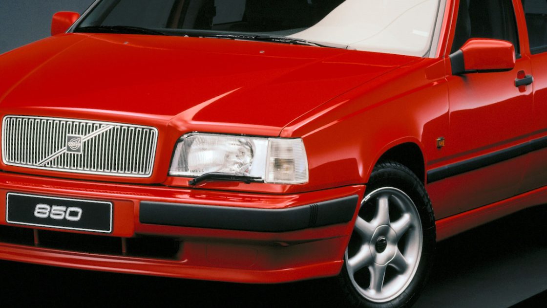

Replacement/Upgrade Headlight Choices: E-code vs. DOT
replacement/upgrade headlightThere are currently FOUR different types of lights available.
1) E-Code (aka european) “jewel” lights
2) DOT (aka US Department of Transportation approved) “jewel” lights
3) E-Code “fluted” lights
4) DOT “fluted” lights.

The consensus is that, for the budget-minded, the E-Code “fluted” lenses sold by FCP Groton are better than the DOT “fluted.” This is just a lens replacement. You keep the existing reflector and headlight assembly. DOT lenses are required to diffuse up to (IIRC) 20% of the light up-ward to light signs. This reduces the “usable” light on the road and causes some glare. E-Code lenses do not do this. They put 100% of the light on the road and have a very sharp vertical cut-off to prevent glare. IIRC, this is because in Europe all signs are required to be lighted, so headlights don’t need to diffuse upward to light signs

If money no factor, the “jewel” upgrade is supposedly the best. You get a whole new headlight assembly (new lens, new housing, and new reflector). The E-Code “jewels” are the better than the DOT “jewels” not only because of the beam pattern (see my summary above), but the E-Codes use H7 bulbs for High and Low Beams, while the DOT uses H11 Low Beams and H7 High Beams. The H11 bulb has a lower lumen output than the H7 (1200 lumens for the H11 vs. 1450 for the H7) See this website for information about bulbs and lumens (light output). http://www.danielsternlighting.com/tech … types.html

Thanks Warren for your thorough reply. I see just one retailer for the “Jewel” style headlamps: vivaperformance.com and the entire set runs about $750…yikes! Couldn’t find a competing retailer.
You mentioned that if I had the stock lens, I would need to just replace the lens with an E-code version. However, I notice the reflectors have little-to-no chrome. They have almost a “matte” finish. So I’m thinking that’s part of the problem that makes me nervous to drive at night….the lighting is VERY dim.
