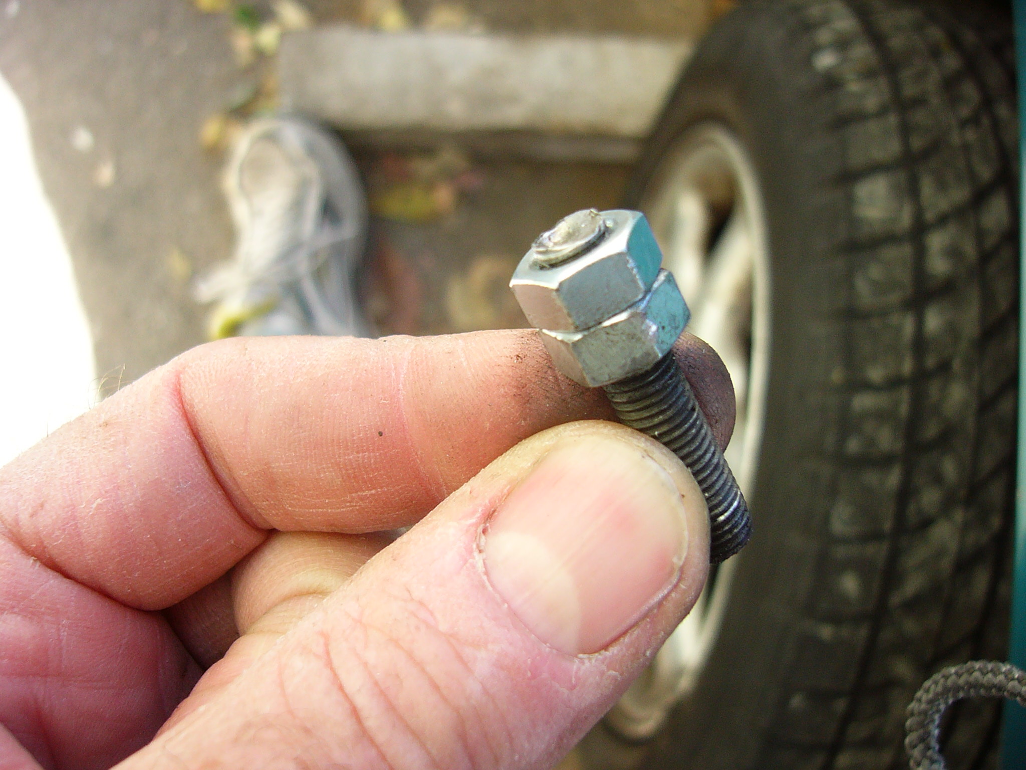

I found a picture of the stud I removed with the two nut technique:

I am thinking of using the two nuts method. The nut size is 7MM 1.0.JimBee wrote:I found a picture of the stud I removed with the two nut technique:
Would you delineate you procedure on more time. I am not sure it would thread from the top, would it? Thanx!
