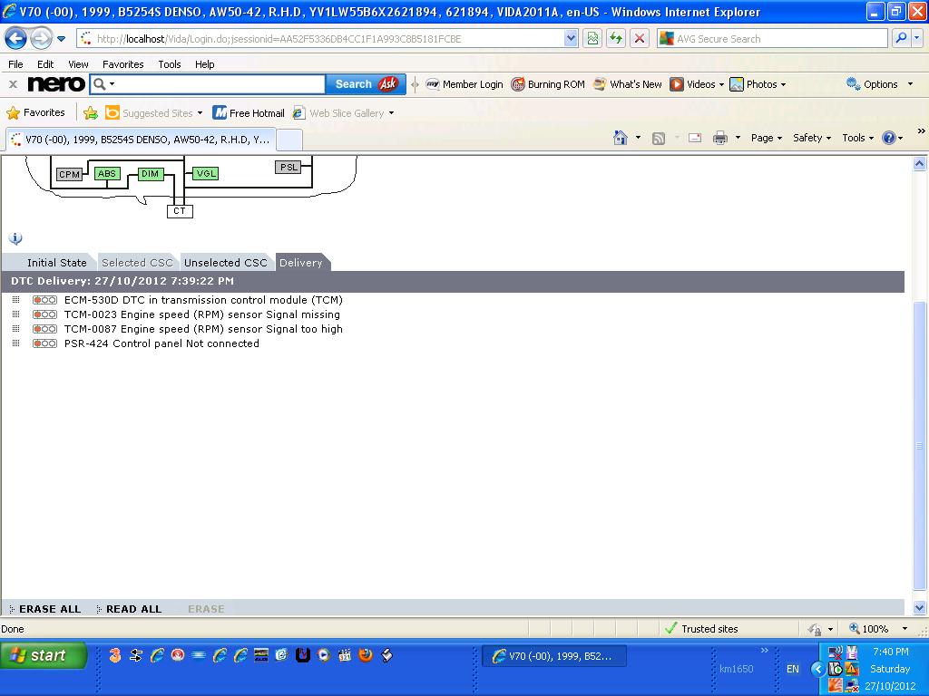

Today I went for the first drive at around 6:00pm after getting a temporary permit from our local roads authority for 28 days.
I have a bearing or shaft noise which increases with vehicle speed. The engine began to miss (I'll have to replace the coils to narrow it down or check fuel injectors as the fuel in the tank is now 2 years old) ) and I still have a P1027 (read from an Autel scanner) which is something to do with a speed sensor read off the TCM.
After hooking up to Vida it seems there's a code related to the engine speed sensor on the transmission.
Does this mean the speed sensor on the trans (not engine) may be faulty or badly connected?
- DTCs on 99V70p1.JPG (99.46 KiB) Viewed 2067 times

Anyone have any ideas? Should I revisit the ABS module first?

Just to close this thread and provide a solution to the final problem I had it ended up being the speed sensors on the gearbox weren't both swapped out when I used an 850 gearbox in this '99 V70.
