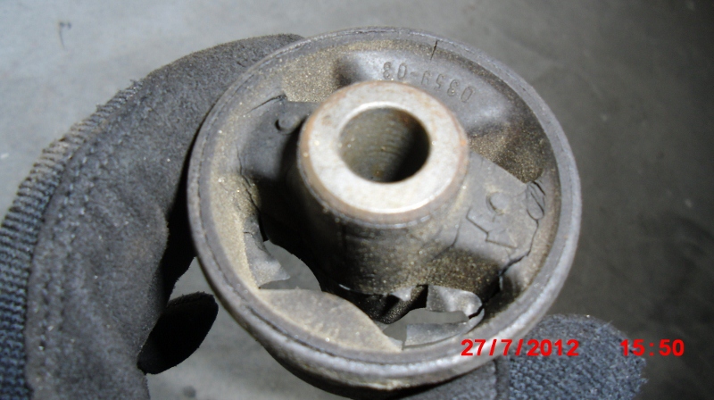

Cracking upper engine mount bushing, is it safe to drive?

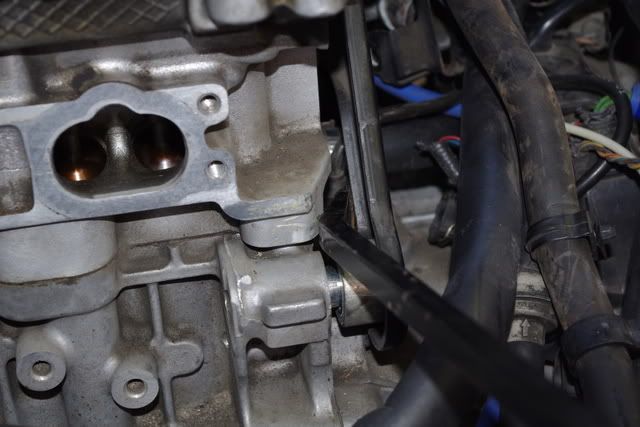

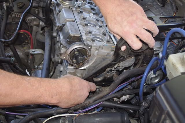

Found some info in the Haynes manual, which I just got the other day. It says "prise the bracket off it's locating dowels on the engine. It will be tight on the dowels, and a certain amount of levering will be necessary".xHeart wrote:The diagram shows two lower bolts and nut. There is nothing else, few gentle taps all around, with a wooden block. Some lubrication.
I guess we're gonna try to pry it off then. Will report back.

I finally have a poly upper engine mount. I had to hire pros after I broke a socket! There is so little vibration felt at the steering wheel versus OEM because two worn lower engine mounts were replaced beforehand. The OEM mount was so worn out that the engine would move significantly and clunk when shifting. Now the shifts are smoother, no clunking. After I do an ATF drain and fill it should be even smoother. Plus all that weight isn't rocking back and forth during acceleration, braking, and turning.
- iPd Polyurethane upper engine mount
- CIMG1887 (800x448).jpg (230.74 KiB) Viewed 2029 times
- Worn out OEM upper engine mount: breaks, cracks, and rips.
- CIMG1886 (800x448).jpg (221.66 KiB) Viewed 2029 times

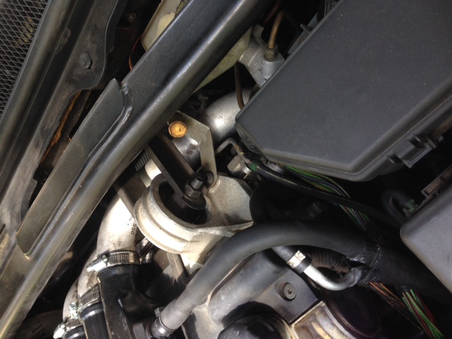

As you can see, my bushing on the upper engine mount broke out of the mount collar. I have a 2000, s80 t6.
I see an after market bushing of polyurethane as an option. When i look up the oem parts, i can't tell if i have to order more than just bushing. The same part number on the volvo diagram from my local volvo dealer is priced at $50 and $370.
It looks like my car has done the hard part for me of getting the bushing out. So, i just need to to figure out the oem option to compare with the after market polyurethane bushing option.
Here's the volvo diagram from my dealer where 24 appears to be the metal mount (with bushing in there) for both $50 and $370.
Any help would be appreciated!

There are at least four mounting bolts holding the upper mount assembly to the top of the cylinder head. Removal of the spark plug cover and removal of the turbo inlet piping will reveal those other mounting holes. If you're patient you can mount the assembly in a vice and work on it to change out the bushing. Using a hacksaw blade can remove the old bushing's casing.
Whether you replace the whole assembly or just the bushing it will need to come off.

Mike is correct about procedure.
I will replace the complete mount, easier that way.
