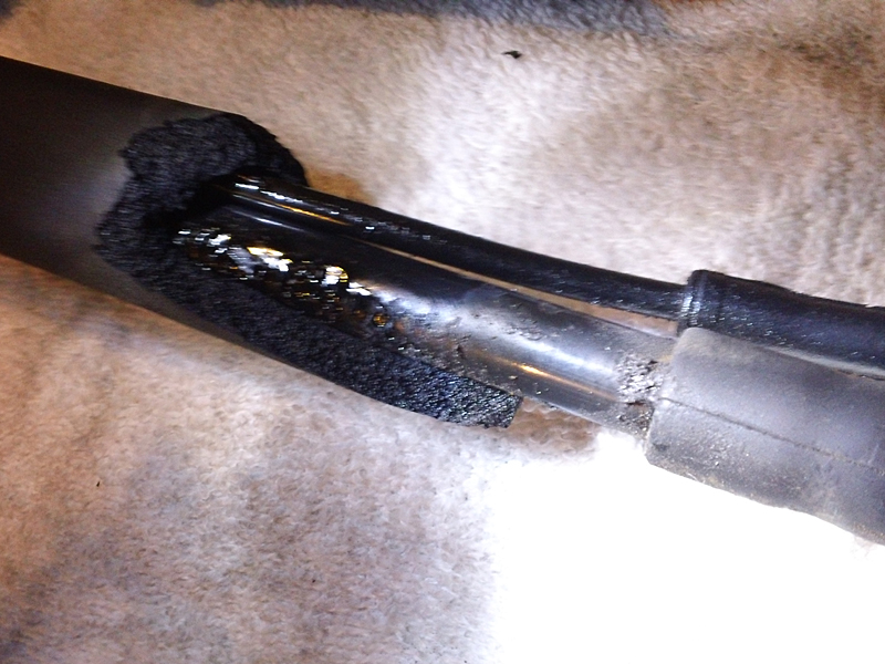

And... here is the hose to flame shield.
