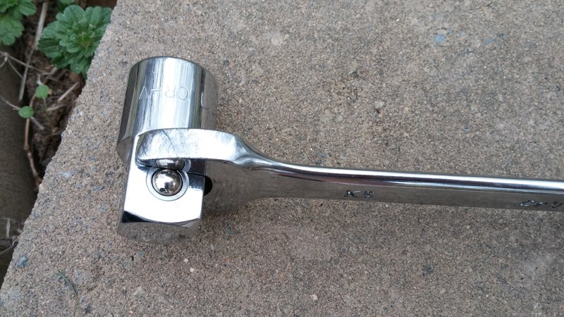

Just changed my tensioner today, and this combo worked great. I used a 1/2" to 3/4" socket adapter and a 19mm open end wrench. The drive part of the adapter is long enough to go into the tensioner and leave just enough space for the wrench.
I tried using the adapter on a 1/2" ratchet a while back, but that didn't work since there is no room in the fender for the ratchet head.

I love this. But I think it costs more than a couple of quarters...bmdubya1198 wrote:Just changed my tensioner today, and this combo worked great. I used a 1/2" to 3/4" socket adapter and a 19mm open end wrench. The drive part of the adapter is long enough to go into the tensioner and leave just enough space for the wrench.

Haha, true, but I already had the tools on hand. I don't even know what that adapter cost, but it's a 3/4 inch and it's from Northern, so it probably wasn't cheap. I actually tried the quarters and vise grips first, and I bent the heck out of the quarters. As long as they're still worth 25 cents if material is missingtheWIFES_S70 wrote:I love this. But I think it costs more than a couple of quarters...bmdubya1198 wrote:Just changed my tensioner today, and this combo worked great. I used a 1/2" to 3/4" socket adapter and a 19mm open end wrench. The drive part of the adapter is long enough to go into the tensioner and leave just enough space for the wrench.

I would add that I needed to grind just a tad off of two sides of the adapter to make it slip in so much easier. Such a small tad that even though I own no 3/4" sockets I think it would still be usable in one. Perhaps 0.5mm off of the two sides.
Biff bam boom with a 3" portable grinder while I had it mounted to a breaker bar. Three 850's in the five Volvo fleet now handled. The 745 manual turbo and 780 are so much easier to work on!! ♥

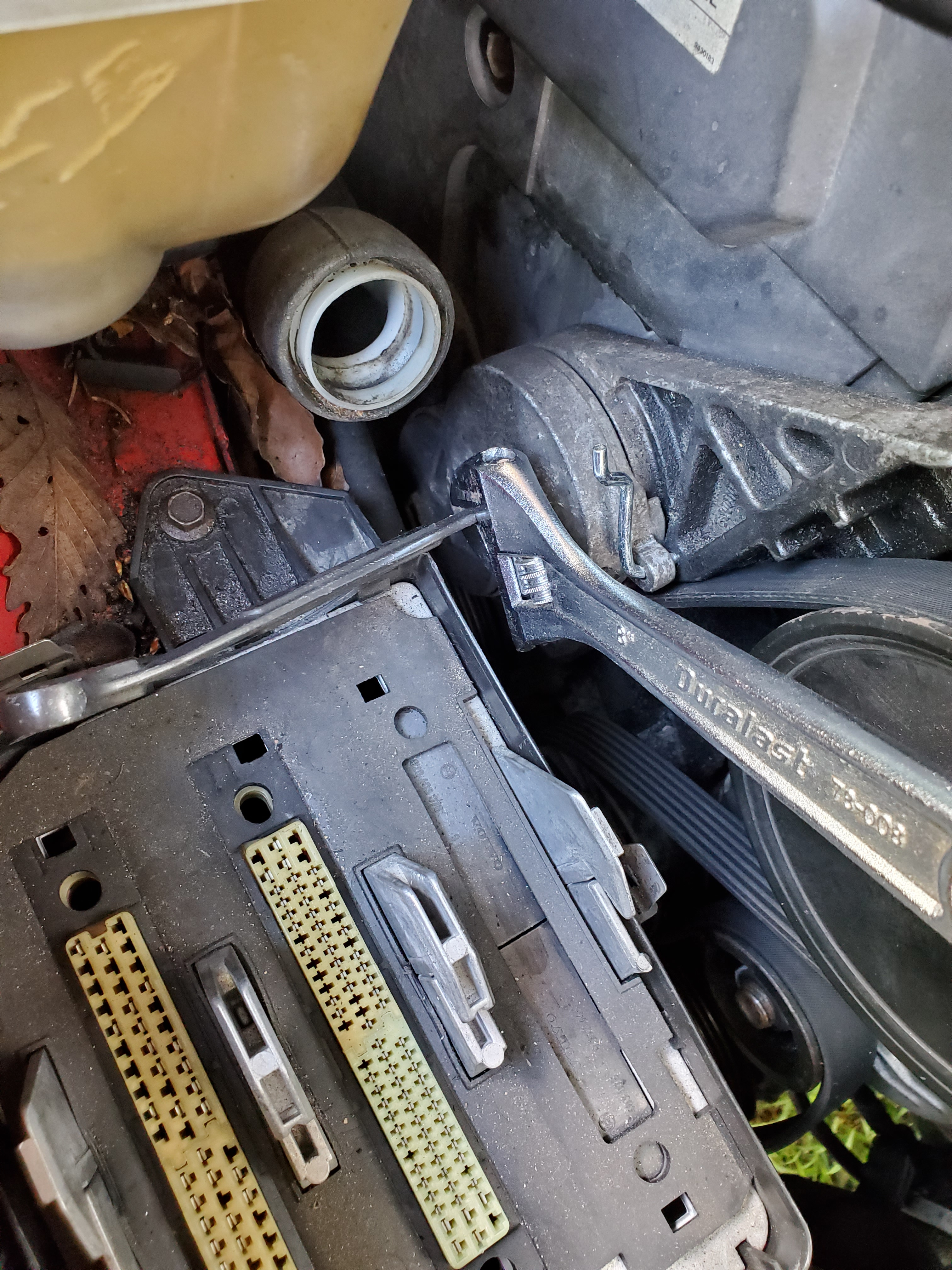

I loosened the tensioner this way a few times way way back using an 11 mm crow's foot, but then I lost the crow's foot and went to a different homemade tool ...Shartcar wrote: 23 Jun 2021, 13:24 Figured I would share what I used in a pinch. The head of my 11mm wrench fit snug with the ECU box removed. Threw an adjustable on there for leverage and it worked surprisingly well.
