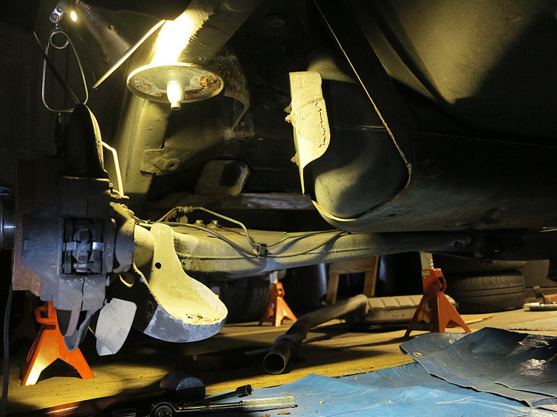

While rear suspension is in repairs, there will be plenty of room for muffler to slide into space over the jack-stands, after which coil spring and shock will go in.

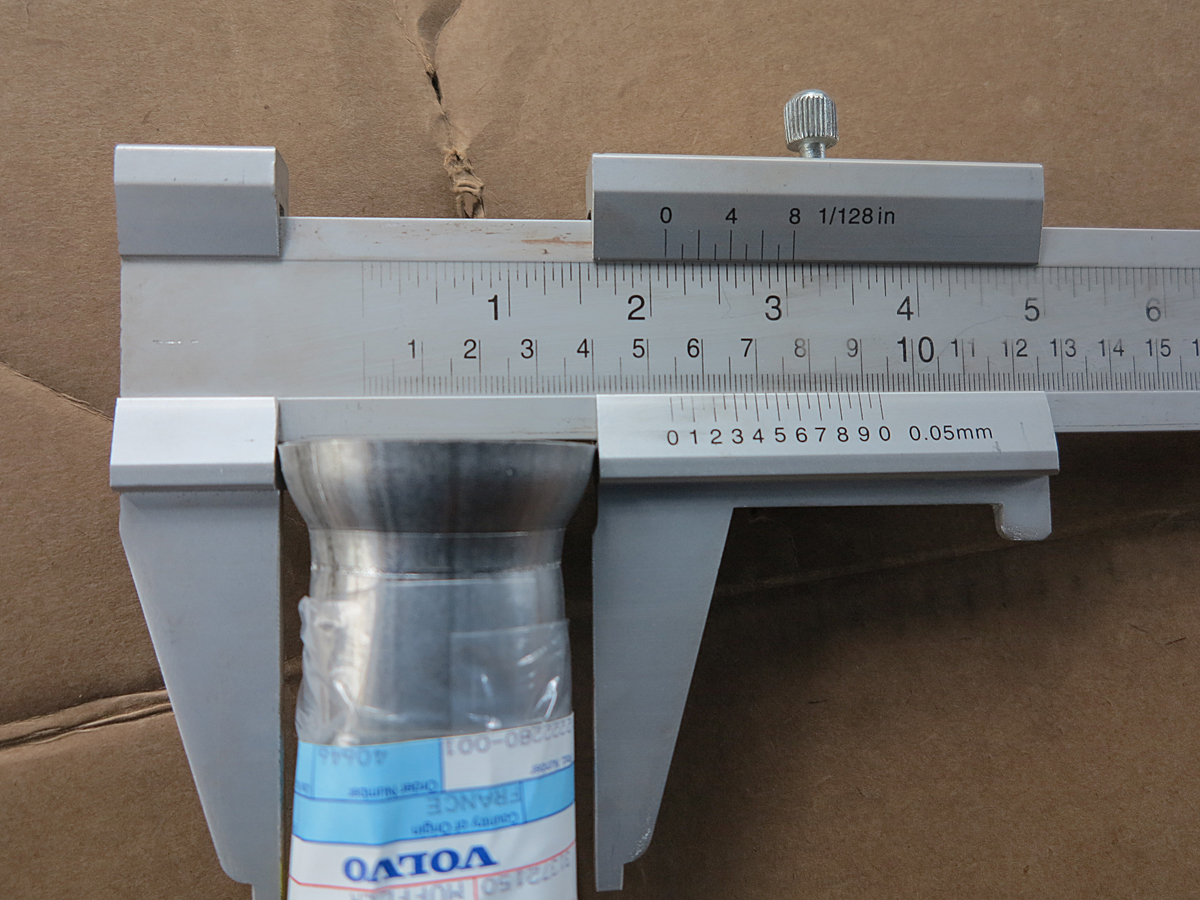

The ball-joint is OD 2" (male end on CAT butting with muff) making a socket connection at muff ---- not sure if OD should be a tad smaller, 1-7/8" may be ---- help?
Then it reduces to OD 1-5/8"...
The repair and install of new muff will require ball-joint OD 2" (if not 1-7/8") with reducer OD 1-3/4" (ID 1-5/8") for it to sleeve over the truncated CAT.
Volvo says they will get one muff by Friday.

Progress... absence of coil spring and shock makes muffler slide over the trailing arm, and into its place with little effort.

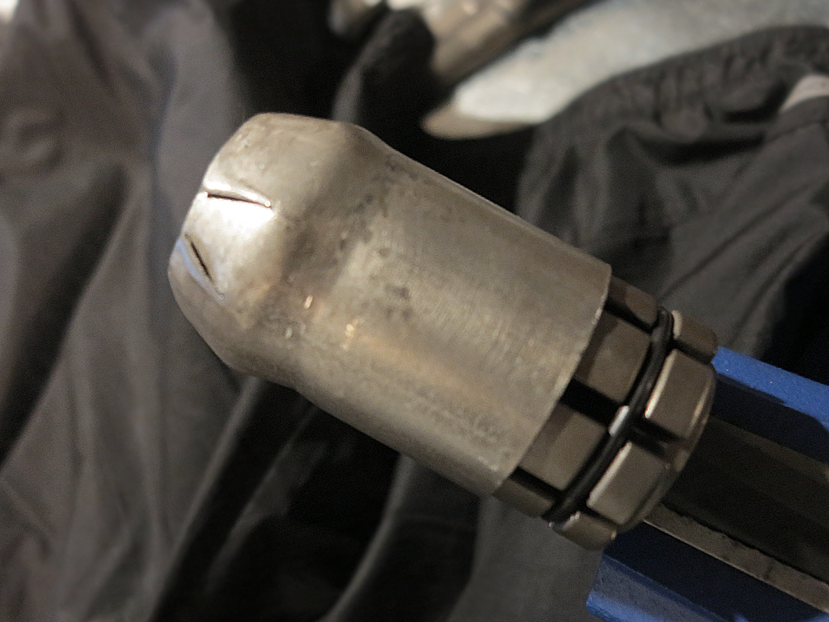

Homemade ball-joint with 2 hours of pure labor.
It is snug fit. Do I use hi-temp silicon for sealing?

Thank you Matt.
Hanger is giving some grief, photos later.
Ball-joint connector length is still a problem, sliced off 1/2".
It may need another 1/4" trimmed.
