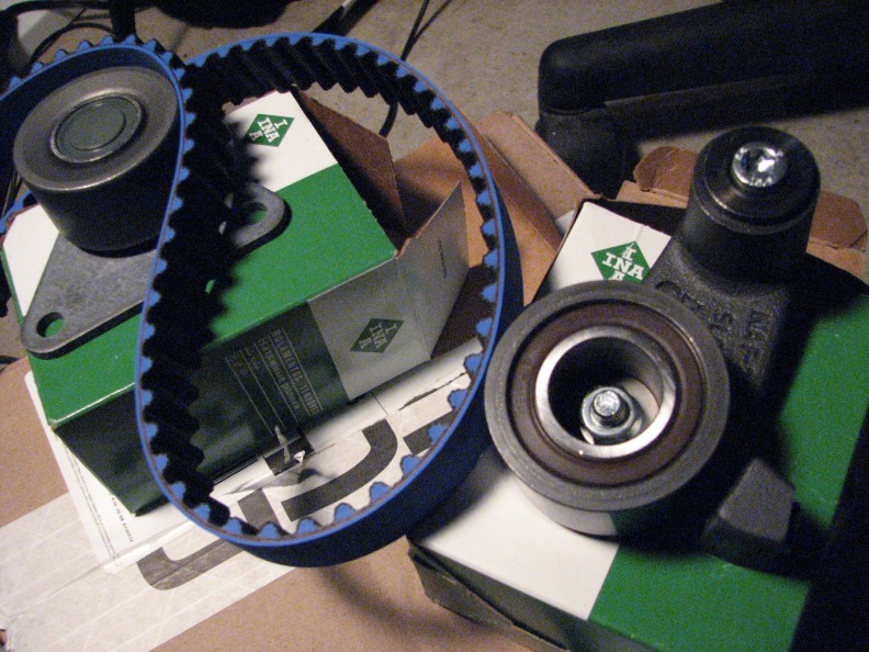

My response.
Twice. Sometime I hear the belt before the turbo. Which is comforting.
The whine of a directly driven belt, such as a "Blower" in the day, supercharger.
I date myself.

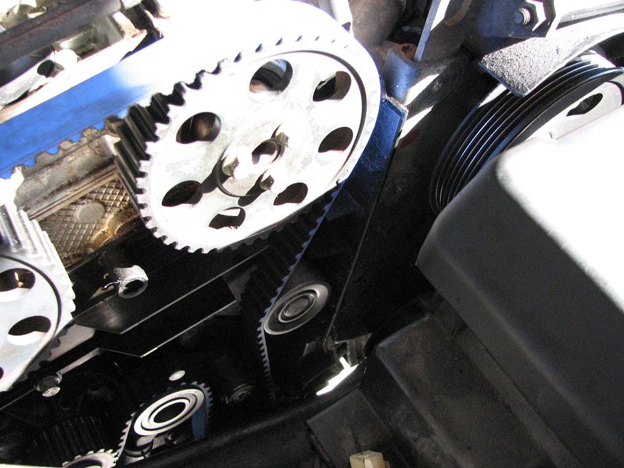

Also I made sure SKF was the actual, and new bearing.
Aisin was new, and not rebuilt tensioner.
Gates blue belt as pictured. From the n/a '93 which the photos had originally been taken.
It was totally overkill for an N/A, but it was already upgraded to the larger belt and pulley size.
Buy a new hydraulic tensioner if the mileage is questionable.
Just do it.
Aisin.
Also, please do yourself a favor. Buy the white engine saver clip that sits between the pulley and the tensioner, should it fail. for $2.50. It usually comes with the Aisin hydraulic tensioner, I get one as a standby.
The second time. I had learned.

I had missed the frugal issue earlier in the thread. It is not a budget issue. it is a quality issue for sure.
Granted, you may not plan on keeping this vehicle very long, or do not care much for the person you may will its short term to.
