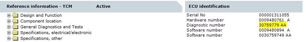

Hi Guys,
I went to the dealer today for an update of my TCM module software on my 2002 V70.
Currently i have software number 30759749AA (see screenshot below) and according to my internet reseach the update part number is 30646691.
How ever the delear told me (after charging $138.25 for diagnostics and telling me i need a new transmission for $6000), that there is no software update available for my TCM. Any ideea if thiss tatement is correct or not?
- TCM_SW_version.JPG (26.34 KiB) Viewed 5015 times
