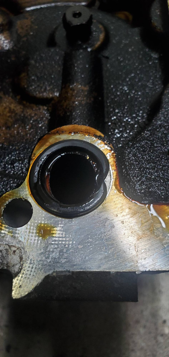

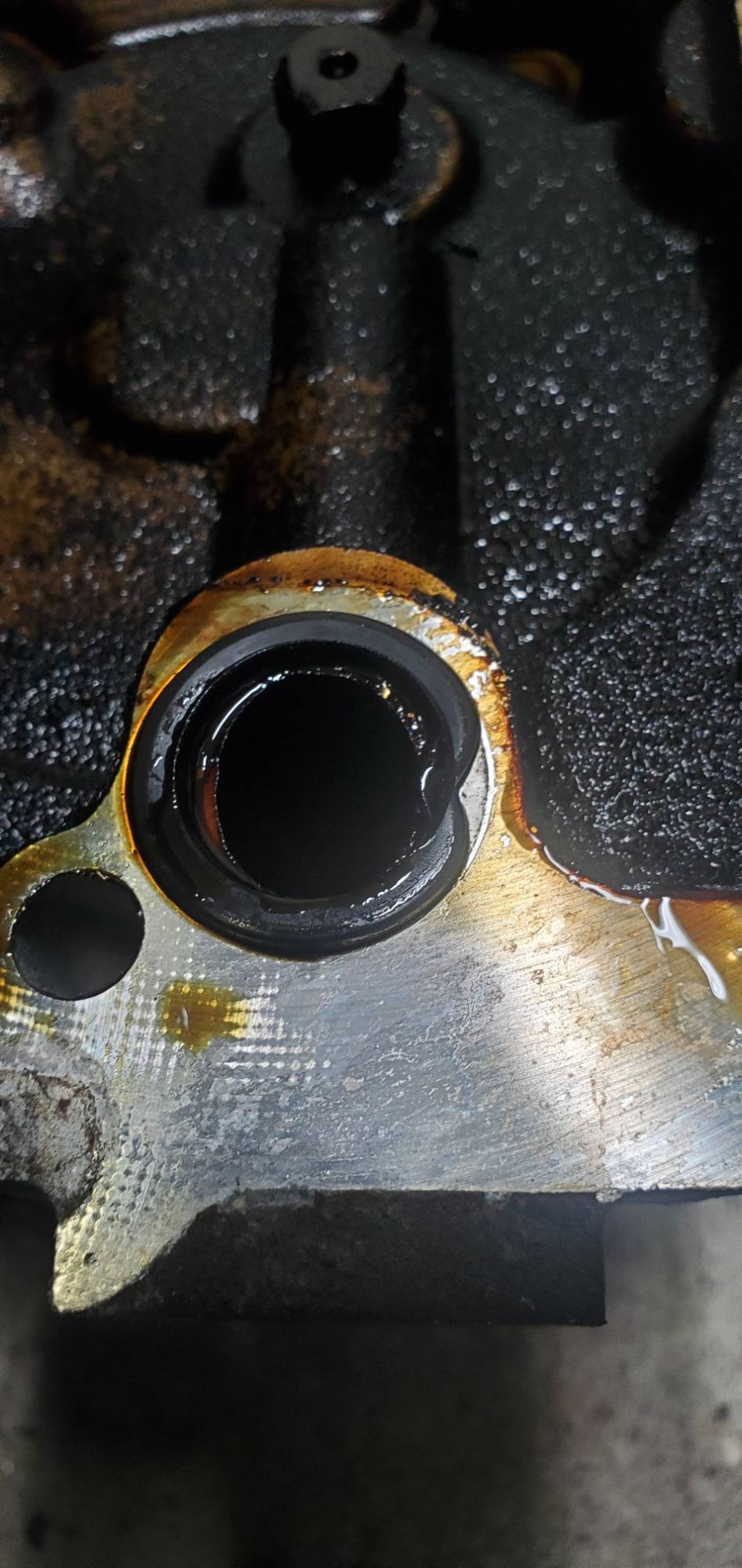

My oil filter looked like the two pictures from the original poster after 6,150 miles from the prior oil change on my 2007 S60 2.5T with 264,000 miles. I had a low oil pressure warning on a particularly cold day of 5*F in Michigan. The exhaust VVT solenoid also threw a code. I drained the oil and found the filter to be caked with junk exactly like the original pictures. I use Quaker State Full Synthetic 5W30 and Mann filters. Low oil pressure is enough of a concern that I pulled the oil pan to inspect the oil pickup screen. It had about 25% coverage of the pickup screen with very small burnt oil chunks. The big thing that I found was an improperly installed o-ring from the original engine build. (Oil pressure on the inside of the oil passage should be pressing the o-ring outward. Having a pinch on the inside diameter of the o-ring is an installation fault.)
I cleaned the oil pickup and oil pan with an ultrasonic cleaner, replaced all of the o-rings using an oil pan gasket kit from FCP (https://www.fcpeuro.com/products/volvo- ... r-30750783), installed new oil cooler seals (https://www.fcpeuro.com/products/volvo- ... z-30637339), used anaerobic sealant from a local parts store, and now everything is back to normal. I believe that the kinked o-ring allowed for slightly reduced oil pressure and reduced oil flow which caused the oil to be overheated inside the turbo and bearings. I didn't do anything with the VVT solenoid because that code hasn't returned. I wouldn't be surprised if the small mesh filter in the VVT gasket has some oil gunk.
I am worried that the piston rings are gunked up. Especially the oil rings at the bottom. The next step is to do a compression test and then soaking the upper pistons/combustion chambers with Barryman B-12 Chemtool in hopes of it loosening any carbon buildup around the piston rings.
