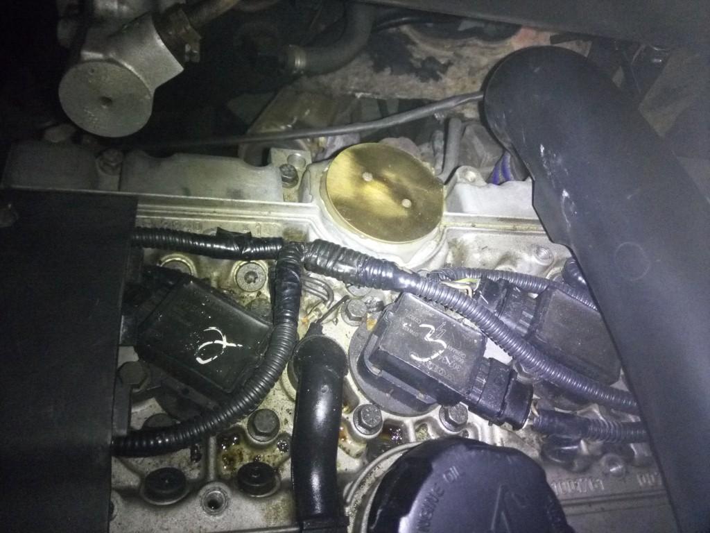

I don't think it's bad design. Sounds more like a failsafe to release pressure before it tears up your internals. Unless previous owner removed or damaged cap, or internal pressure is not high. But if it blew while revving, probably not Volvo's fault, as no one else's does that.

I guess this would be another approach. I have about thirty Magnetti throttles here. A polished throttle flap fills the space nicely and glues into place with metal epoxy. It's a 17 y.o car. I'm being a realist!!
IMG_20170609_212155 (Medium) 2.JPG (103.48 KiB) Viewed 1673 times

That works! So far no issues on my end and all leaks have been stopped. It's pretty reliable with just a few hiccups now and then.
