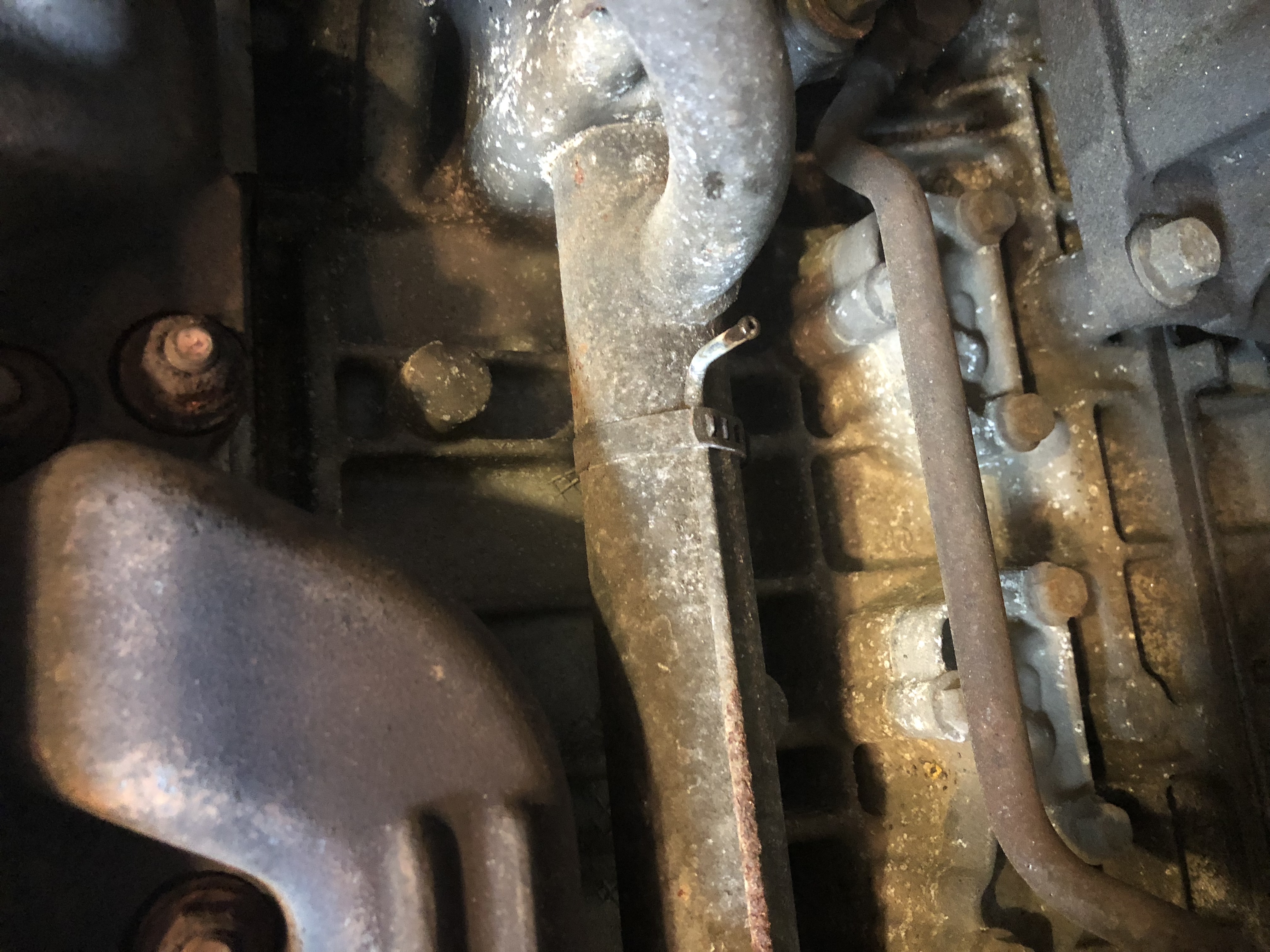

UPDATE: I found a motor from a 97 850 a couple weeks on eBay with 81k. The best part was that it came with the turbo and all of the accessories still bolted on! The old motor is out, subframe bushings done, swaybar bushings done, and 20 years of grime (18 in New England) pressure washed and degreased. New motor mounts too. I transferred all the timing parts and alternator over because they are new. I wish I could transfer the a/c compressor but I don’t have a way to evacuate and recharge the system. I’ll have to settle for a re-shim of the old one, still hooked up.
So I was tinkering after work installing axle seals and transferring that pesky elbow coolant hose to the turbo and noticed that the new motor doesn’t have something my old one does: a really thin metal line that is “metal ziptied” to the main coolant tube. There’s a white plastic vac line on the end under the distributed cap. Can I live without it? I don’t think it will survive being removed, it’s pretty crusty.

I'd do the PCV while the engine is out. At 80K miles is about the right time for it.

As a preventative measure I dropped the oil pan of the "new" motor and did the sump o rings, inspected the breather passage up to the head, clean as a whistle (good sign), didn't see the need to replace the entire pcv system at this point. I can't believe the trap would be full or clogged at this point.
