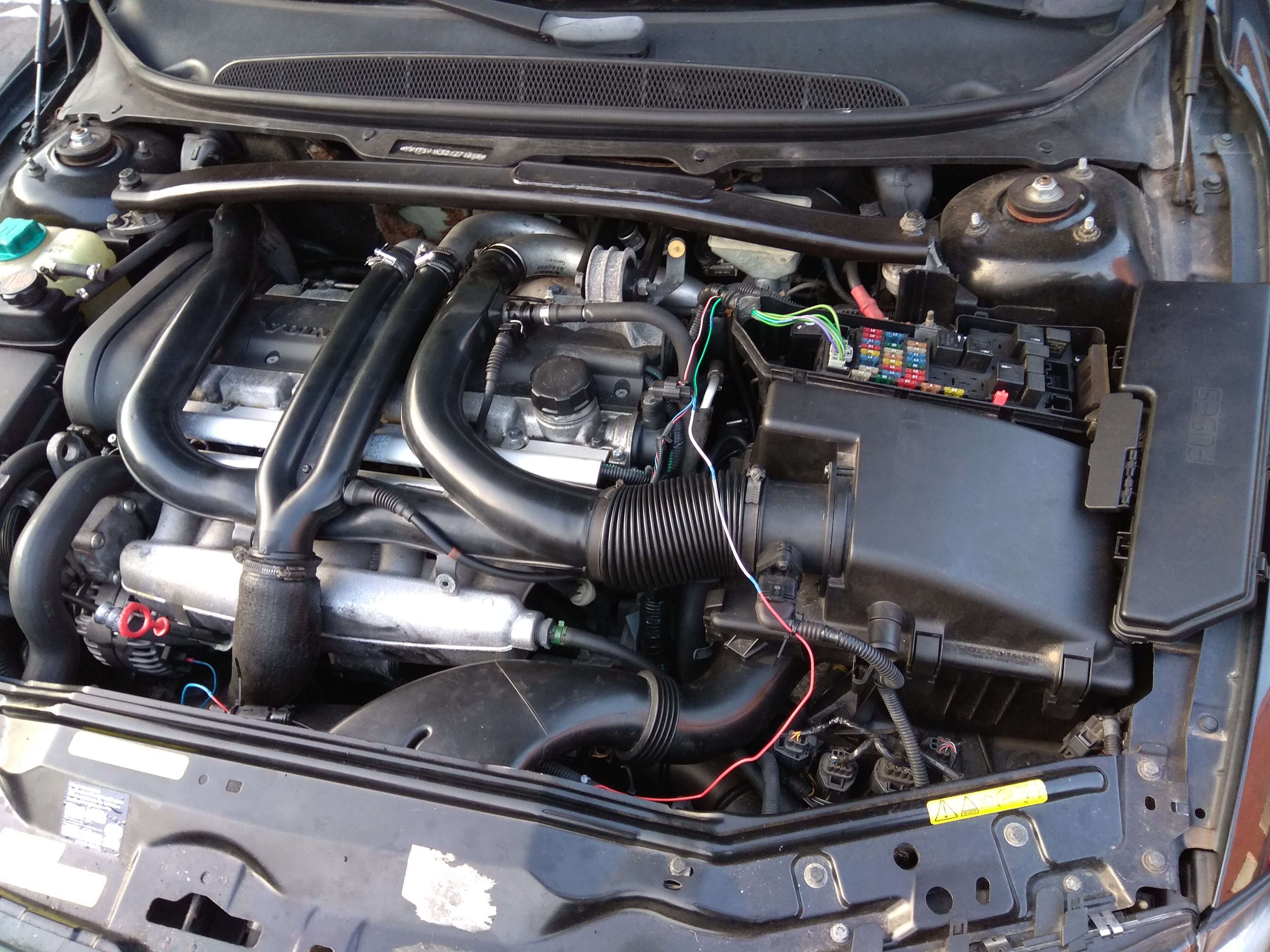

I rigged a cable together and, at least while testing, it worked. Not pretty, but a real cable is on the way.
If it works tomorrow for the entire day without a hitch, I guess the problem has finally been solved!!

For the final fix maybe see if you can snake it in with the existing wire harness or at least zip tie it along the way. Smart approach is to get the proper gauge wire that is rated for high heat and run a straight piece the entire way and make sure the ends are sealed and secure.
I like to solder the connector then put some dielectric grease on it before sealing with shrink tubing so that corrosion is limited.

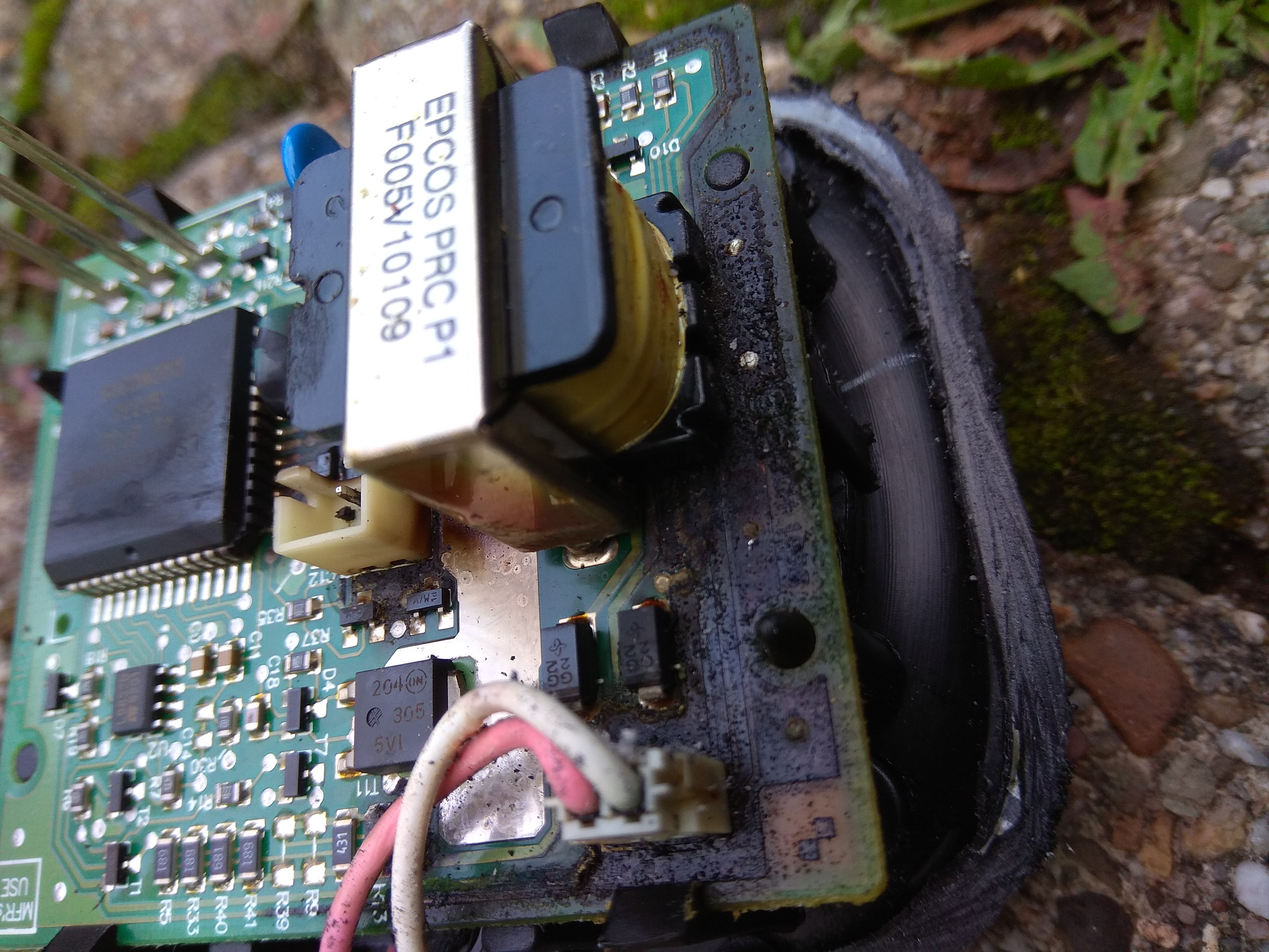

Update. The car got a new battery and runs..BUT something was really draining the battery. On the hunt and with the message "alarm service required" the obvious cause was found.
The pc board is fried.

I assume the pic is of your Siren Module. Try cleaning it up w rubbing alcohol and see what you end up with. You might be able to run some traces and get it back running. Basic VOM and solder work. As it is broken no loss.
There are write ups on fixing these and the batteries. Some put the batteries outside the box, properly sealed, to avoid the problem and deal with battery size issues.
As to your question: I believe you can leave the module out (seal the connector). It is no different than pulling the fuse for that circuit. You will lose some functions like sunroof, interior lights and maybe horn. The info chart for the fuse may tell you what is hanging on that circuit. Don’t recall. Leave it out and pull the fuse and do a test of what items you have lost.

The PC board does look like it might just be contaminated. Contamination can leakage currents, which in turn can cause malfunctions. Clean up with rubbing alcohol and a toothbrush.

There are actually some little transistors or whatever that are completely burned. There is no saving it. I took the battery out, sealed the box with tape and put it back in for now (until I get a new one). All the functions of the car are there (except that the alarm is probably not going to work) only downside is the fast draining of the battery
