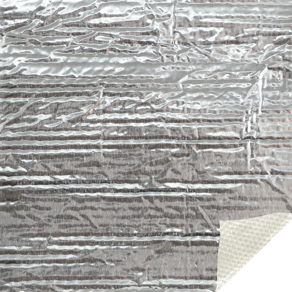

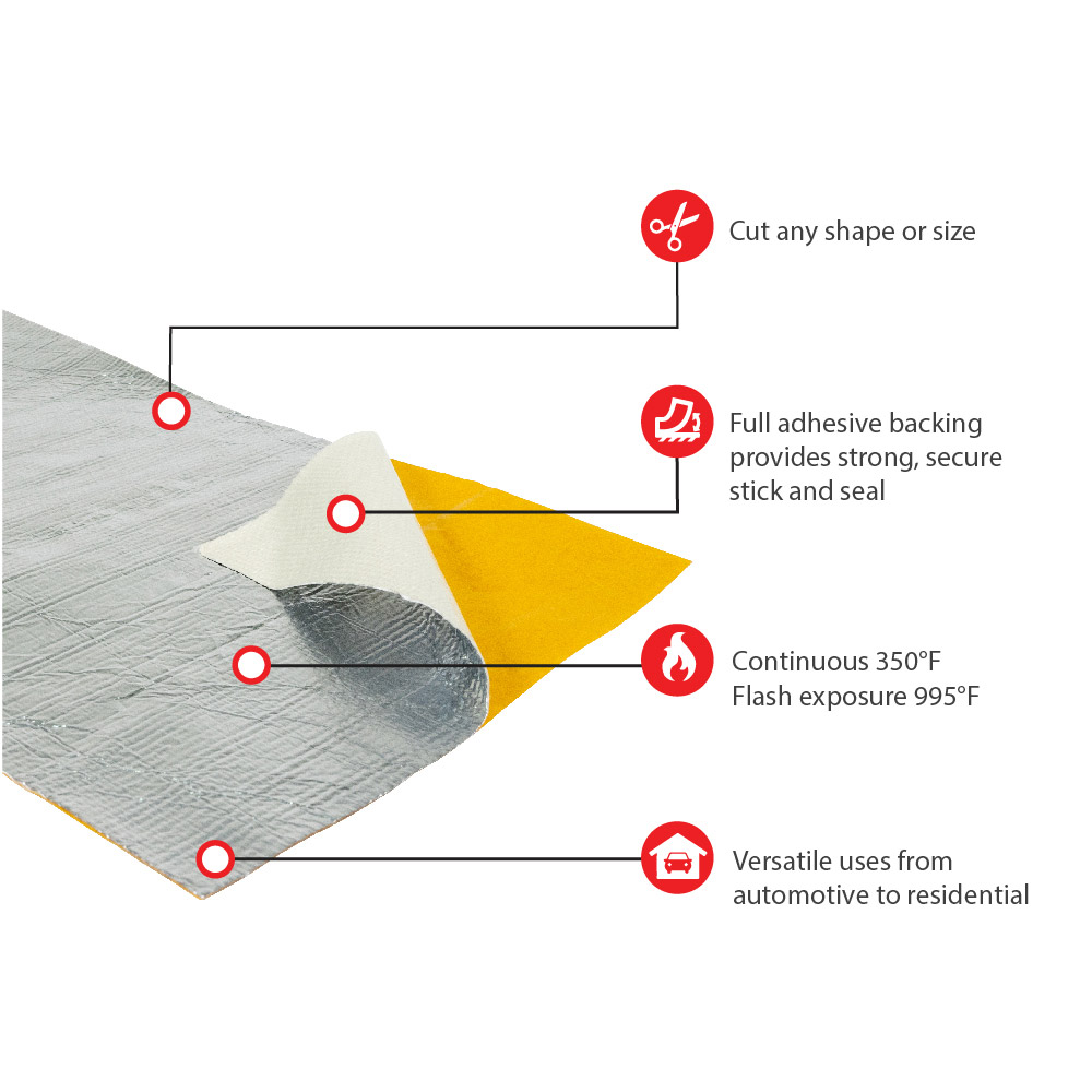

- Posts: 14809
- Joined: 14 Sep 2002, 11:03
- Has thanked: 2857 times
- Been thanked: 1332 times
Maybe thin enough, and maybe reflective enough. Maybe.
https://www.zippertubing.com/products/t ... eflect-afa
