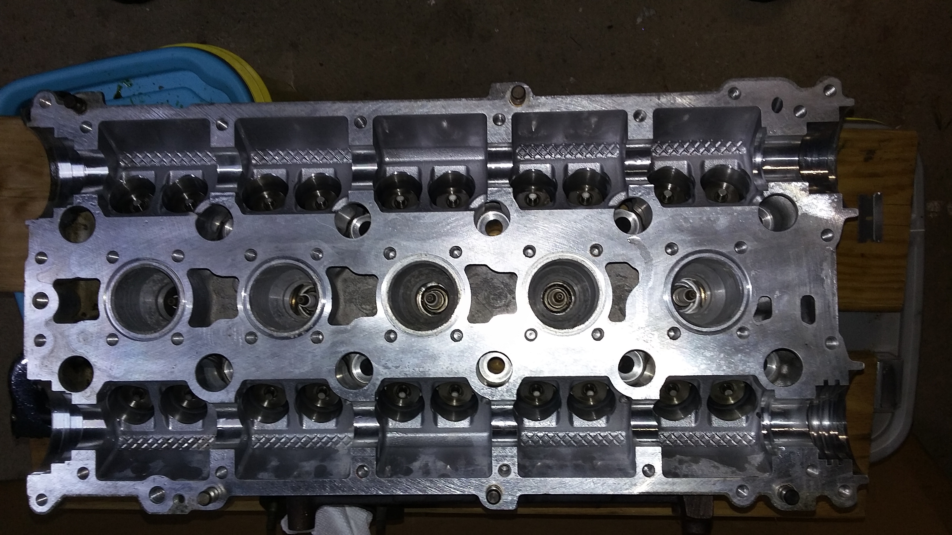

She used mean green. Warning, put your sunglasses on before you view her cylinder head
viewtopic.php?f=1&t=69387&start=30

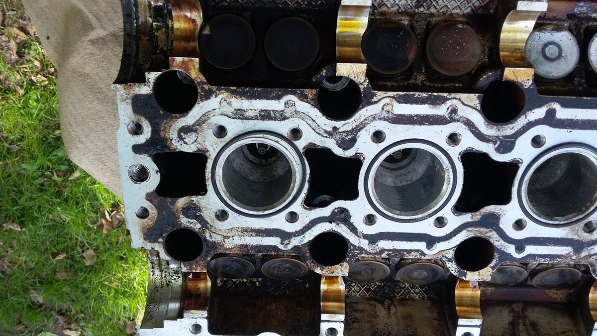

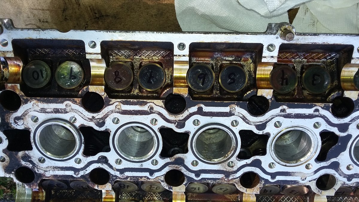

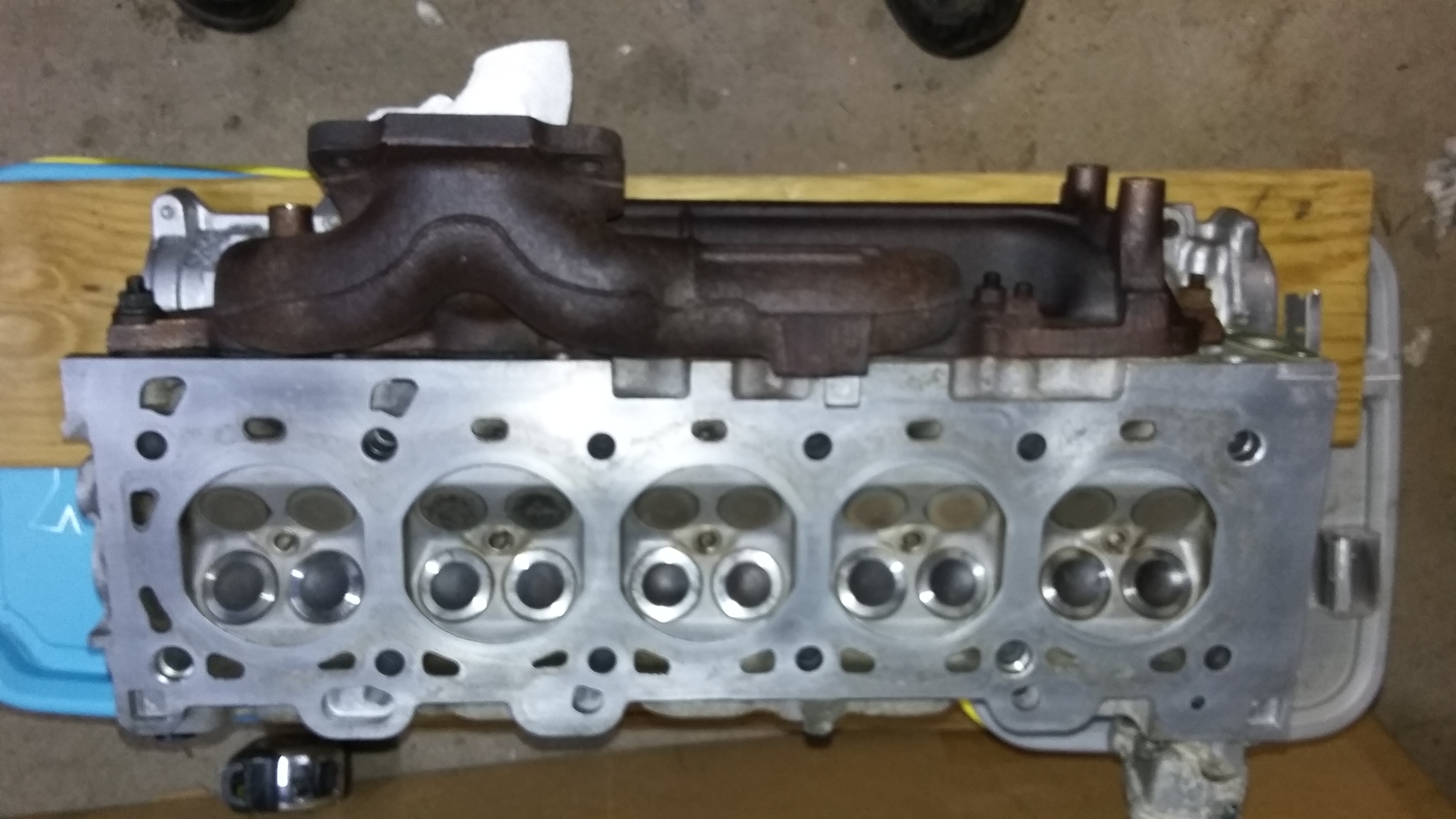

Not bad for dollar store Oven Cleaner.
This time I used a 1800psi power washer...
