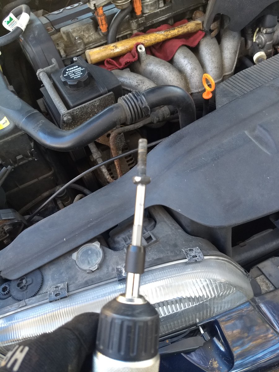

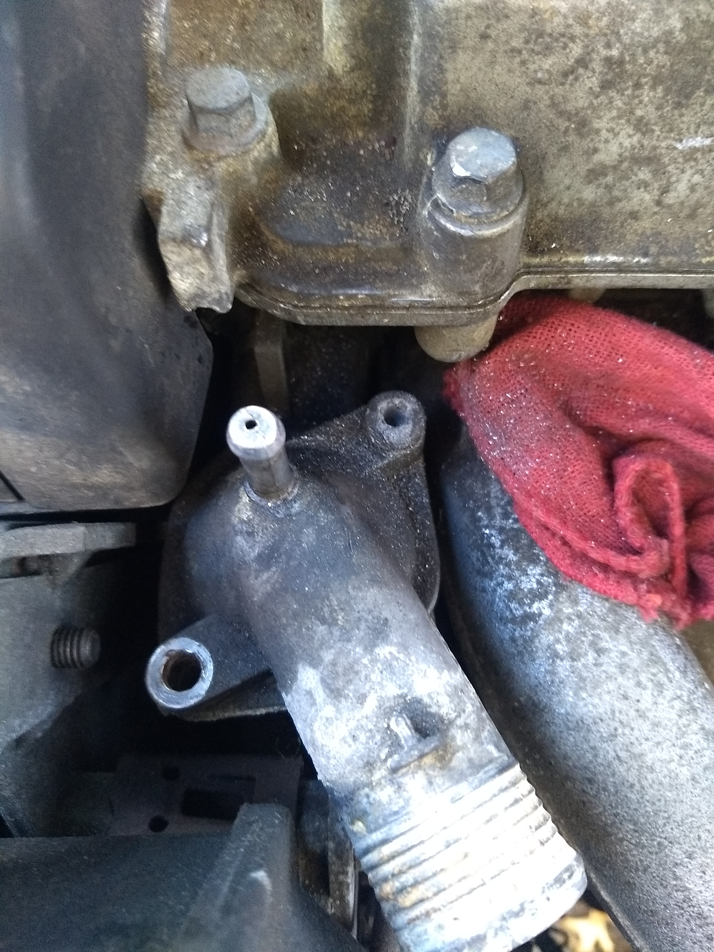

Thanks to all the great advice. When refreshing the coolant system in my '98 V70 a few months ago, I stripped the T40 bolt due to not applying enough downward force. (I had done my other '00 V70 correctly, so it was probably a bit of overconfidence on my part.)
I ended up removing the fuel rail, drilling the bolt and using a screw extractor. In place of the Torx bolts, I used 10mm bolts from a water pump. Then I swapped the thermostat, temperature sensor and upper radiator hose.
