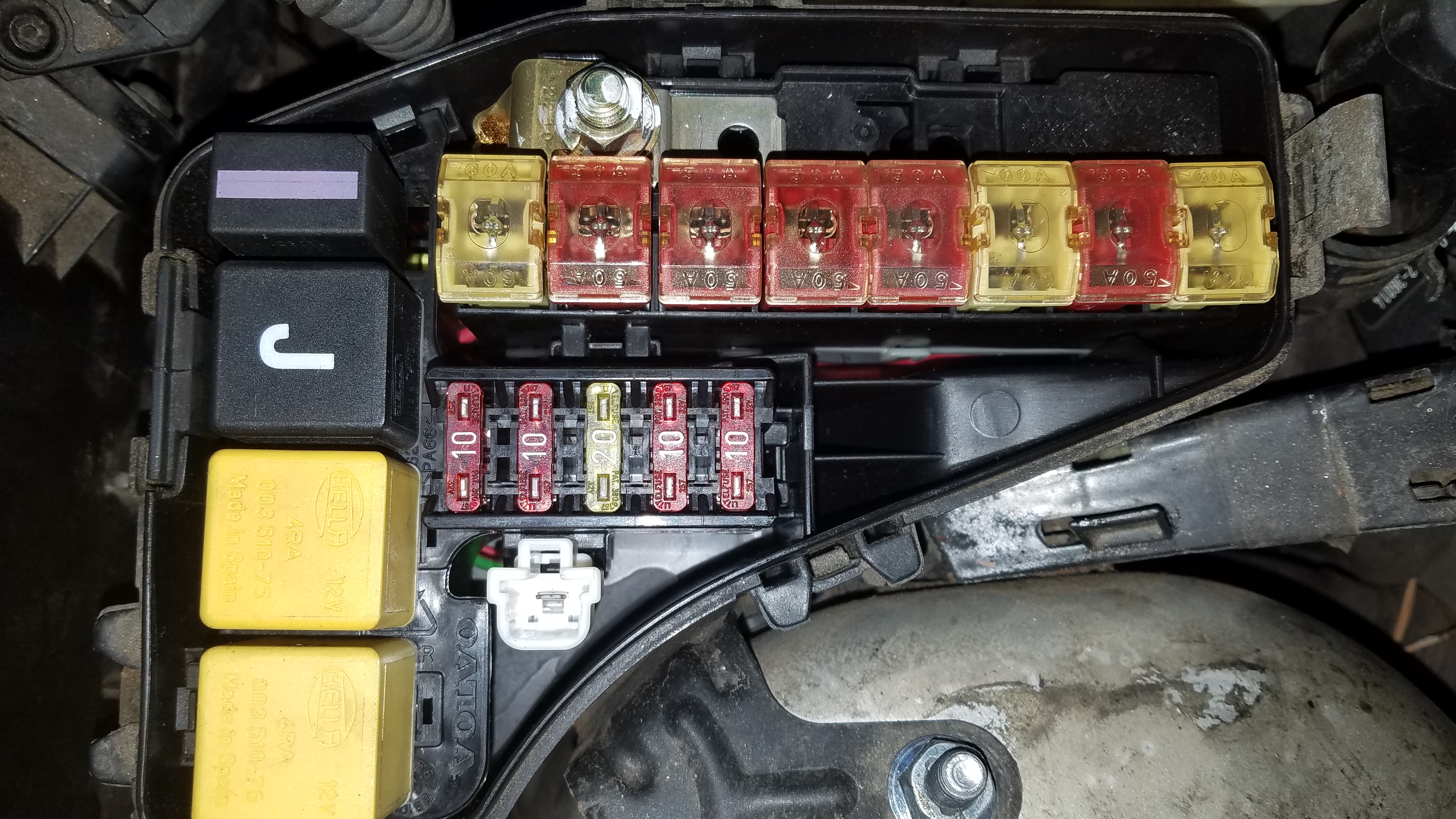

On a side note, I really need to turn that rogue 10A fuse around. I mean, really, who does that???
Who does that? Do you know where I can buy a CD changer where the first position is labelled 0 instead of 1?
I want it to read 0CD, of course.

clarkerussell wrote: 04 Mar 2019, 08:02... On a side note, I really need to turn that rogue 10A fuse around. I mean, really, who does that???
OMG I can't look at that!
FIX IT!!!

Oh, but on a positive note, I did fix the fuse:
