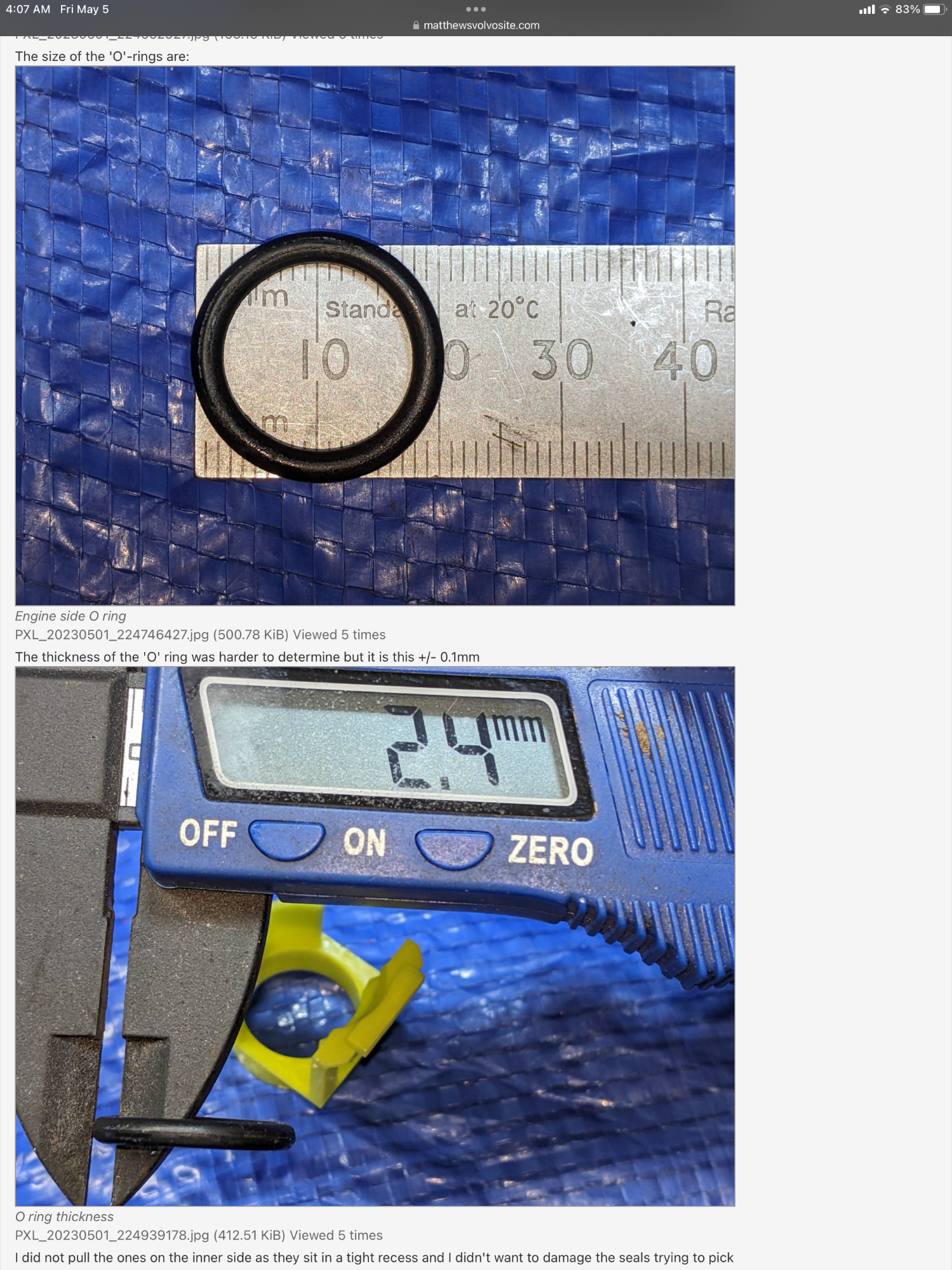

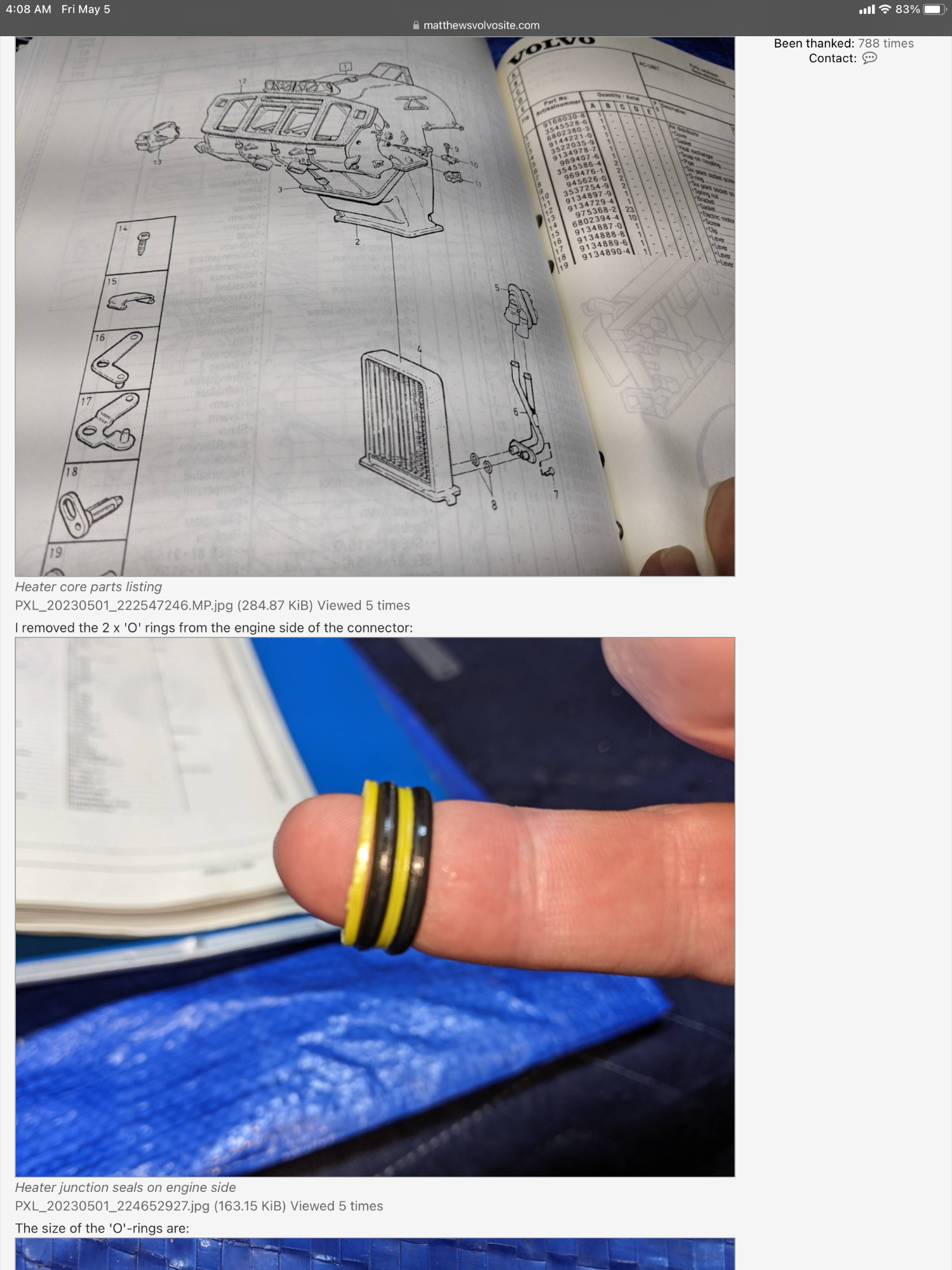

The firewall heater hoses each have two o-rings that are 2.4mm thick by 20mm diameter , total of four. The whole set of o-rings and clips are sold as a kit by Volvo , individual o-rings are not
Photos courtesy of Scot850
