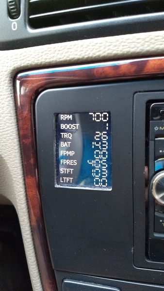

Yes, this is a bit outdated screens set with the sensors:
Arduino boards generally does not have any serious storage available for data dumps, however it is possible to attach (solder&program) SD-card shield, or print data over USB to be collected on the laptop. I use latter from time to time to sniffer the CAN-bus, like intercept Hilton encrypted sw loader, just out of curiosity to take a glimpse at how he did it. Or capture VIDA Online session that is not logged on disk like old offline versions did.
