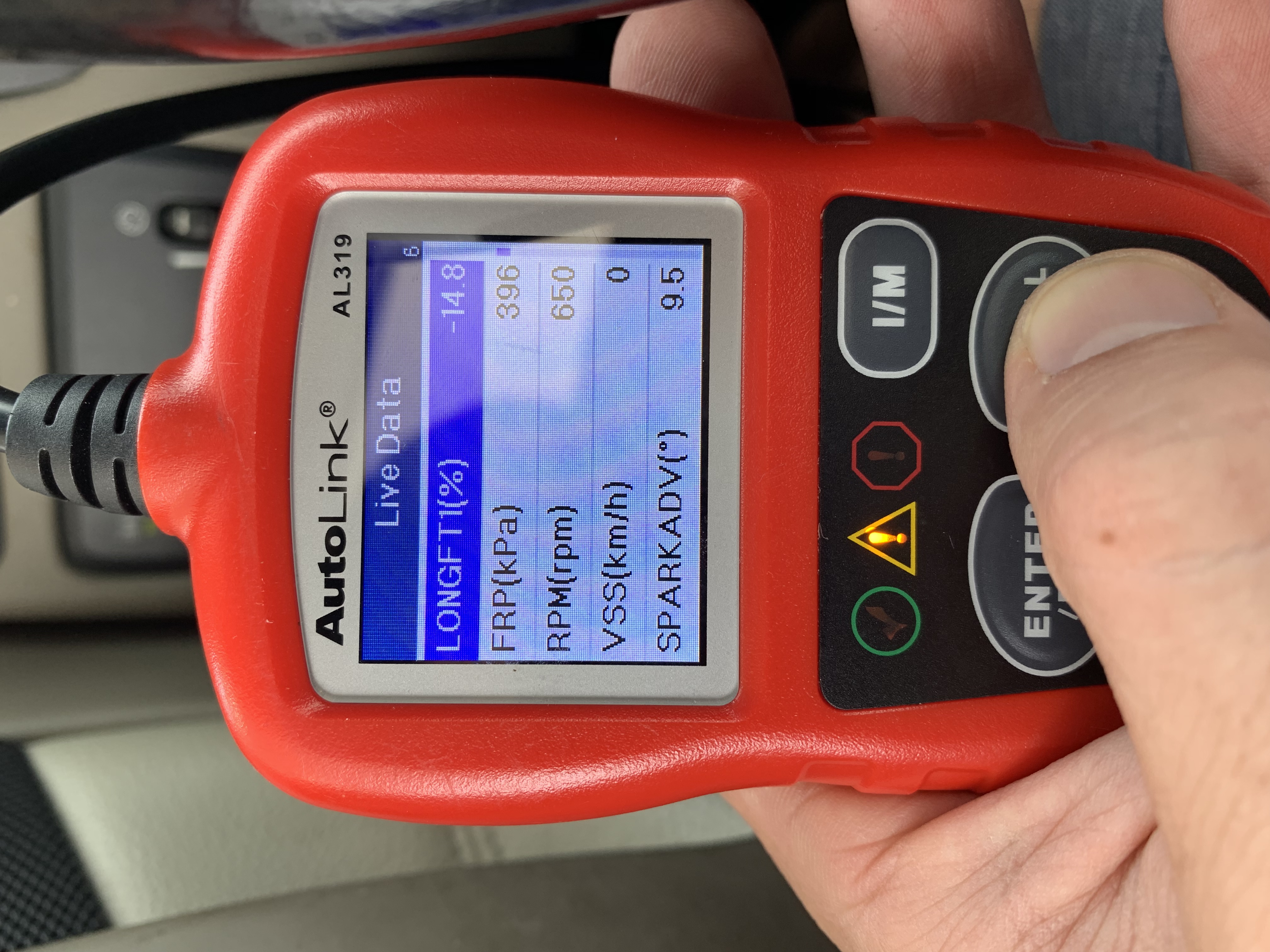

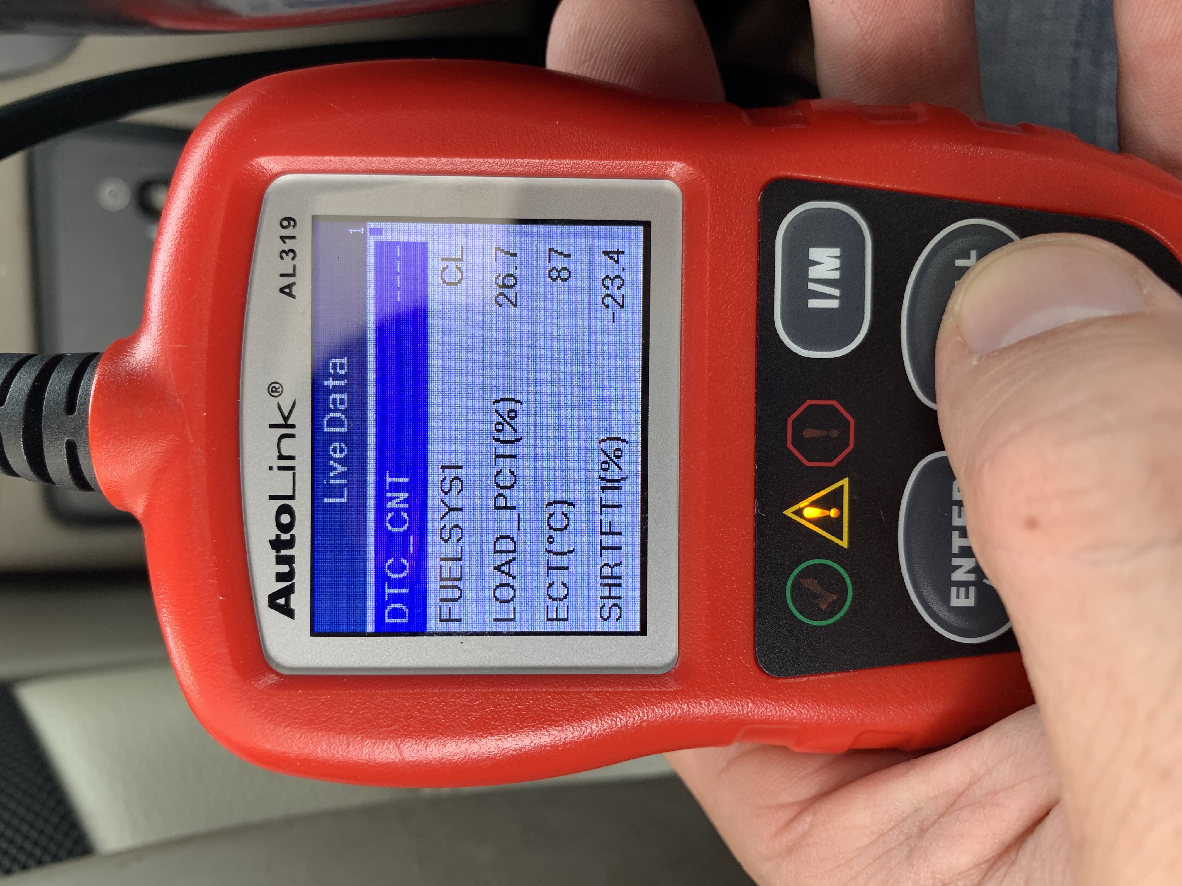

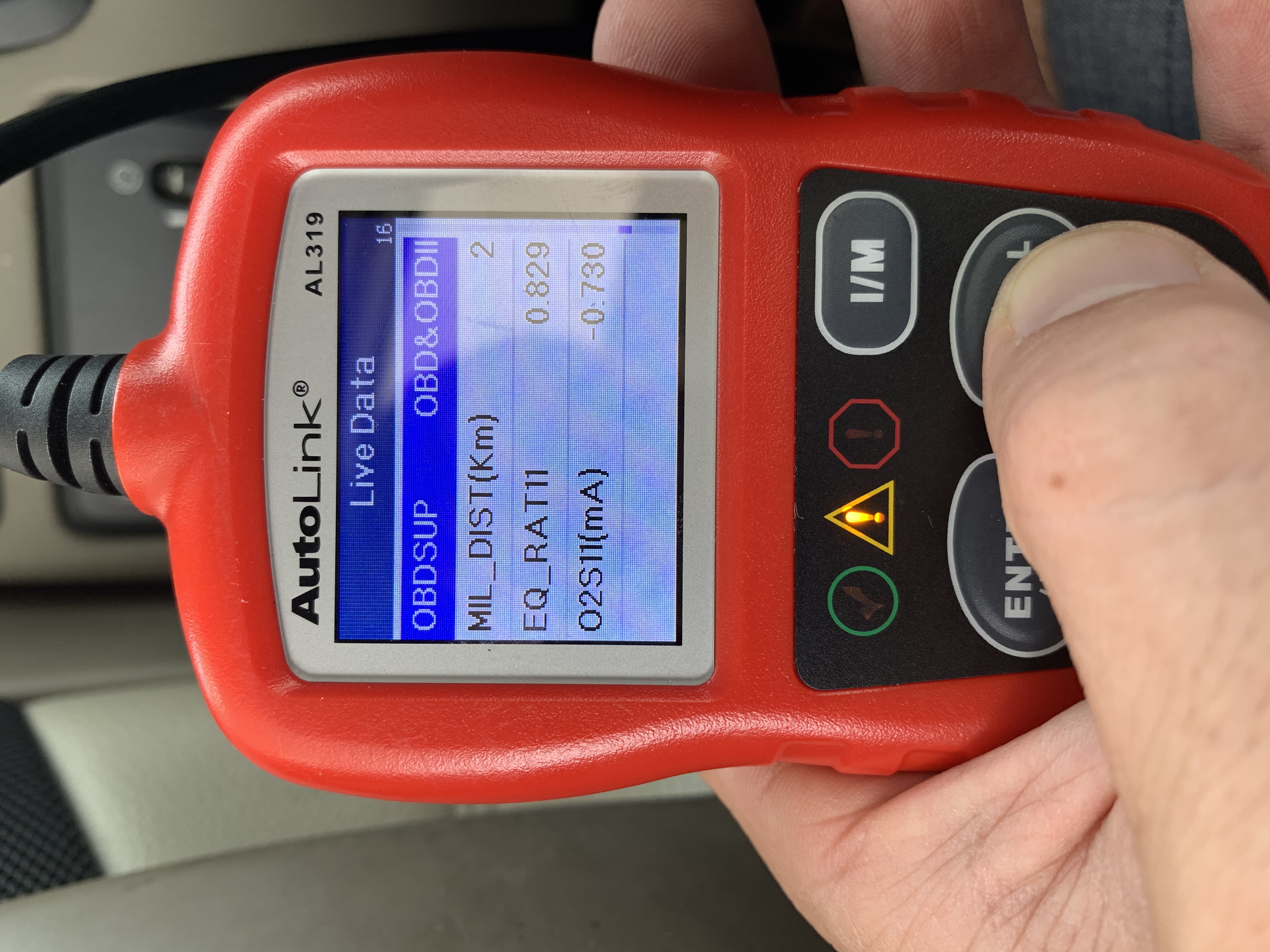

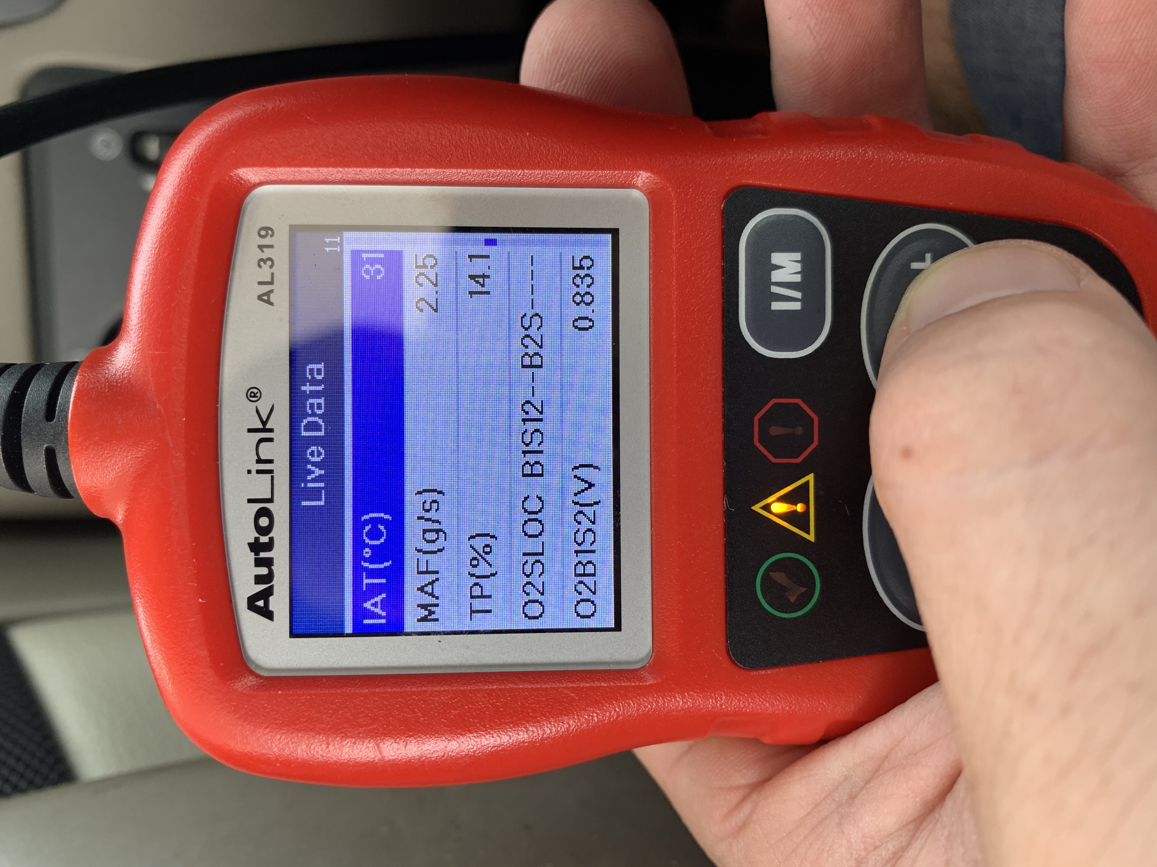

I spoke too soon. After driving for about 15 minutes on the highway, parked car at friends house for 30 minutes in the sun. Went to start it again when leaving, it started back surging as I was reversing out of the driveway, and code came back on shortly thereafter. It seems to surge more on hot days for some reason. Anyway, I cleared the code again and it seems to be running fine now. Could high crankcase pressure be the culprit somehow?
See attached images right before I cleared the code.
Posts: 36153
Joined: 17 Feb 2013, 17:54
Has thanked: 1610 times
Been thanked: 4068 times
Did you get real fuel pressures measurements on the rail? If that isn’t nailed to spec, it’s fuel delivery problem.

What is LOAD_PCT? And ECT?
