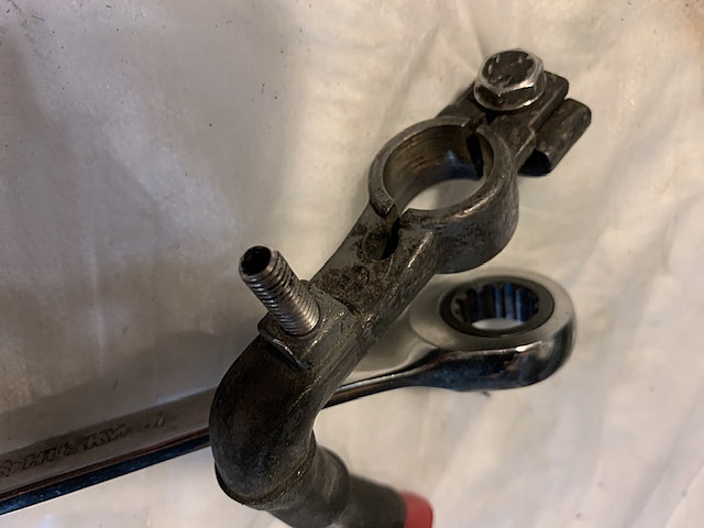

The battery charging is now restored with ECONOMY replacement cable. Old Volvo terminal is designed to fit various wires. I was able to modify and add square port like original.
The replacement cable terminal arm is short, and the ring is hard to fit over battery terminal -- simply pia!
Here is the pix of old terminal:
misha
Posts: 5379
Joined: 7 December 2008
Year and Model: '97 850 2.5 20v
Location: Serbia
Has thanked: 152 times
Been thanked: 402 times
Post by misha »
Now get your battery fully re-charged with a charger and check it periodically.
If sulphating process started because it was always undercharged it will never have full capacity like it should...but it will last longer now when charging issues are solved.
The old clamp was soldered with big soldering iron....how did you just transfer the old clamp on new cable?

The battery is new, replacement under warranty, so there is no sulphate build up and charge was 12.65v. The idle charge is 13.8-13.9v at the battery terminals under load, i.e headlights, warning lights, radio, wiper, heater and fan, all cabin lights with door and trunk open, and iPhone charging at the cig. lighter.
No, I did not transfer the old original terminal clamp to new cable. However, the new cable is long enough to be cut off at the clamp and put on the original -- original clamp is WAY BETTER! Can the original camp be reconditioned for the new cable -- like the challenge?

Post by misha »
Charging results are excellent!
It can,but you will need a BIG industrial soldering iron to remove the remainings of the old cable from it and to re-solder a new one.
I wouldn't bother with it unless i have that soldering iron.
Clamps are clamps....cables are those which fails.
