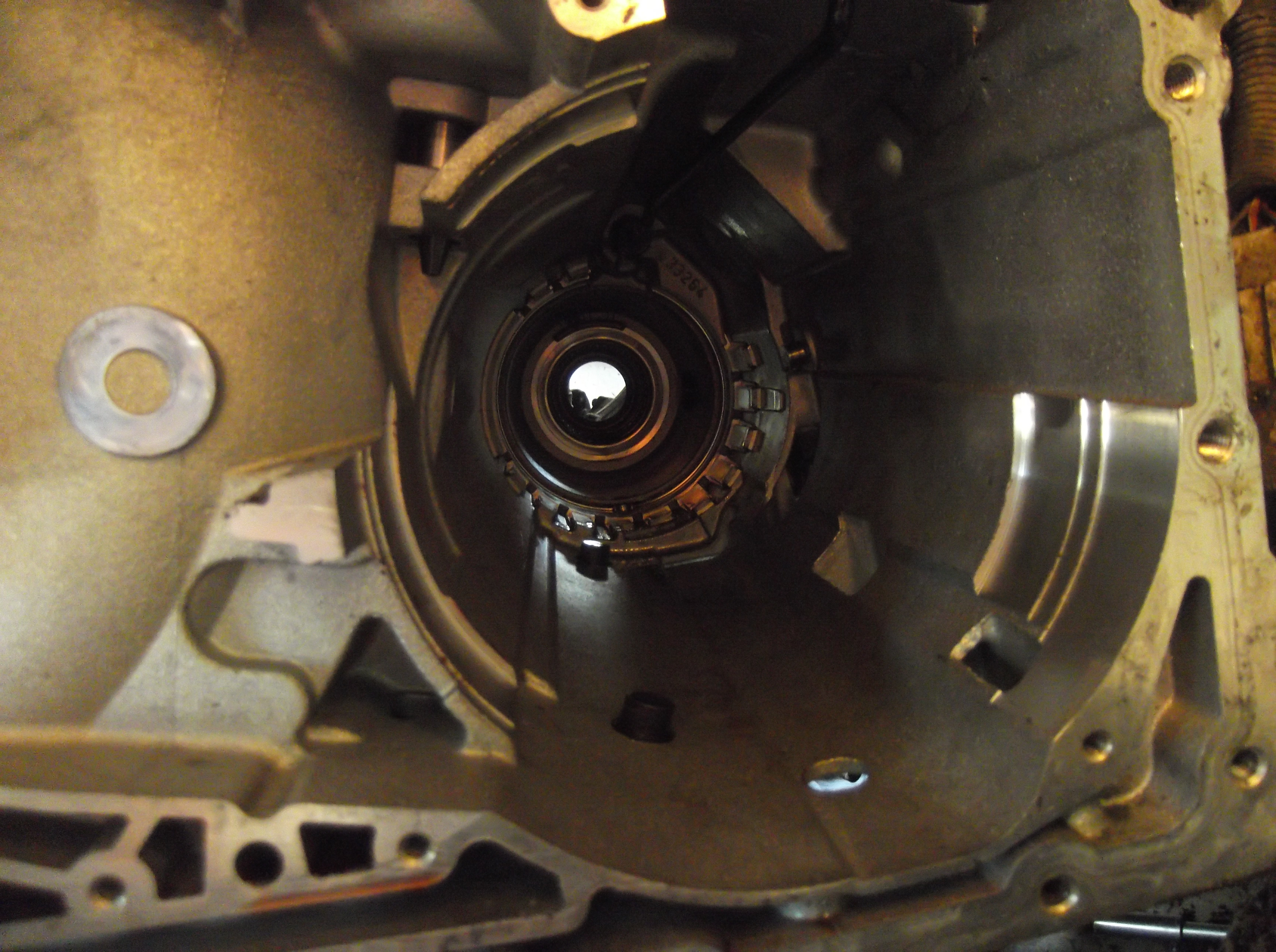

the final drive sungear shaft is the mystery part which does not appear on any of the videos apparently it should not have been removed because it does not want to go back in. The long spline end should go in first but it is stopping short about 2 inches maybe the parking pawl assembly needs to come out after all , which means the pan has to come down and the lube pipe has to come out .
perhaps a thrust washer or bearing slipped down when I pulled the shaft out? If so it would stop at the solid inner shaft and block the sungear shaft from going in
edited to add I measured how far the shaft will go in and it needs to go another 2 inches , so I shined a light in and can see a splined hole and with a long screwdriver i can move whatever it is around so its offcenter and not engaging.
Fun fact about the sunshaft it has the same spline on both ends but 1 is longer than the other. The short spline has to face out or the planetary will seat too far down on it and basically the length of the long spline is how much further it needs to go in.
I have taken the pan and filter off early on and put the pan back on with three bolts so i probably can remove the pan if need be pull the pipe out undo the big snap ring and remove that big cast irn thing with the parking pawl on it . but first I'll monkey around and see if I can get this thing in

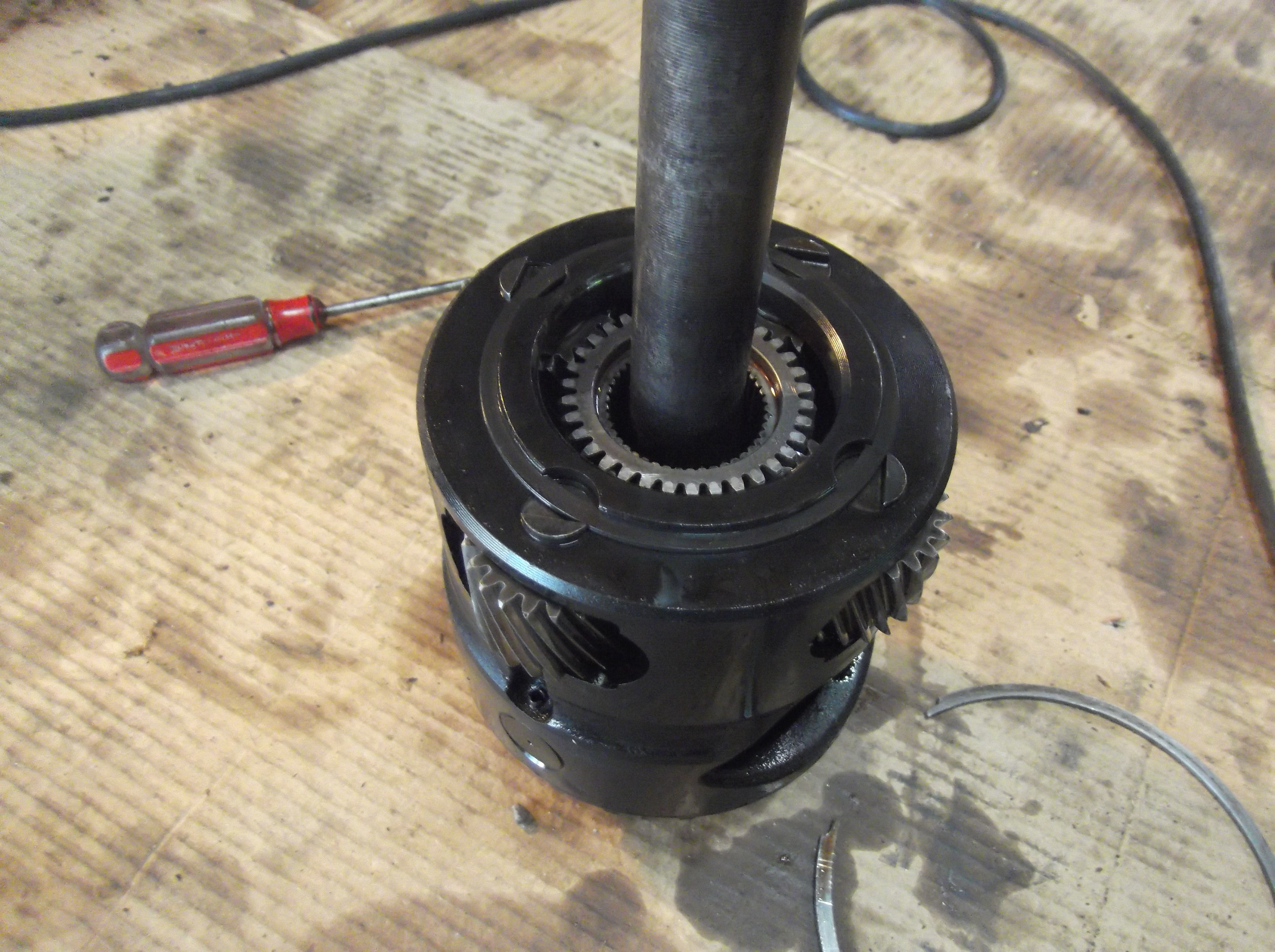

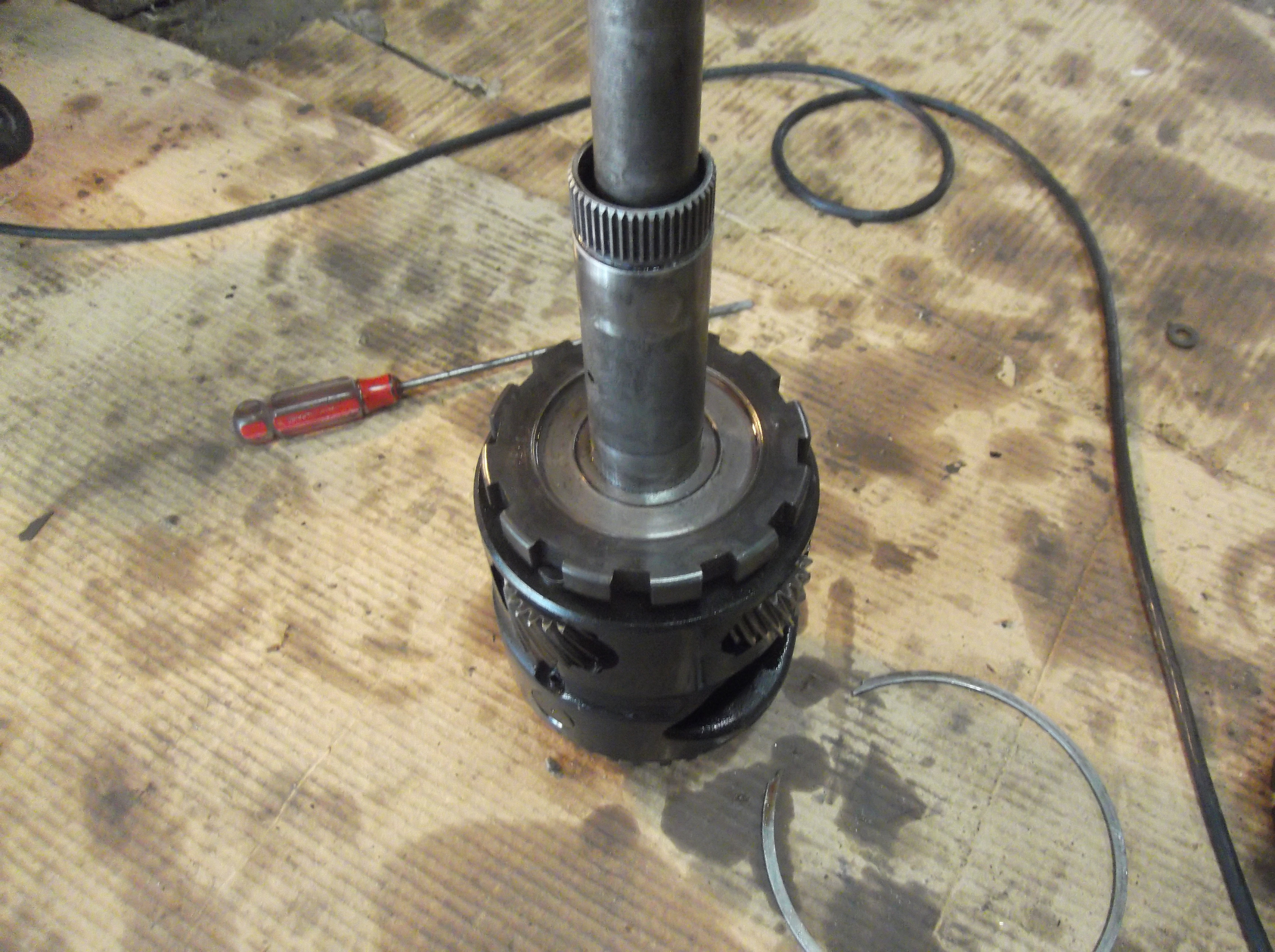

so the whole stupid thing had to come out the gear that the parking pawl locks into slumps down if you pull that sunshaft yikes
oh well scorched earth time now
this is what the sun shaft looks like fully splined into where it needs to go first the final drive planetary?? then the parking gear , note that you cant put the shaft into the planetary then put the gear over it , you have to put the gear on the sunshaft then put that assembly into the planetary like so a bearing or thrust washer goes next into the pocket in the gear face , then the out planet ring gear I guess I will call it which has splines on the outside and can only go one way, the hole in the bottom has to be positioned so the planetary oil line can push in from inside the pan area

This is a nightmare now , it took me over 3 hours to get that all out and back in again . Hopefully its ok now.
I realized during the process that I never explicitly pull that sunshaft out and none of the various videos show that either.
I had a lot of trouble trying to get it together and I found that you can easily screw it up when you are 90% there and have to start over.
I'll try to post some pics tomorrow of what I mean I'm knocking off for the day now
