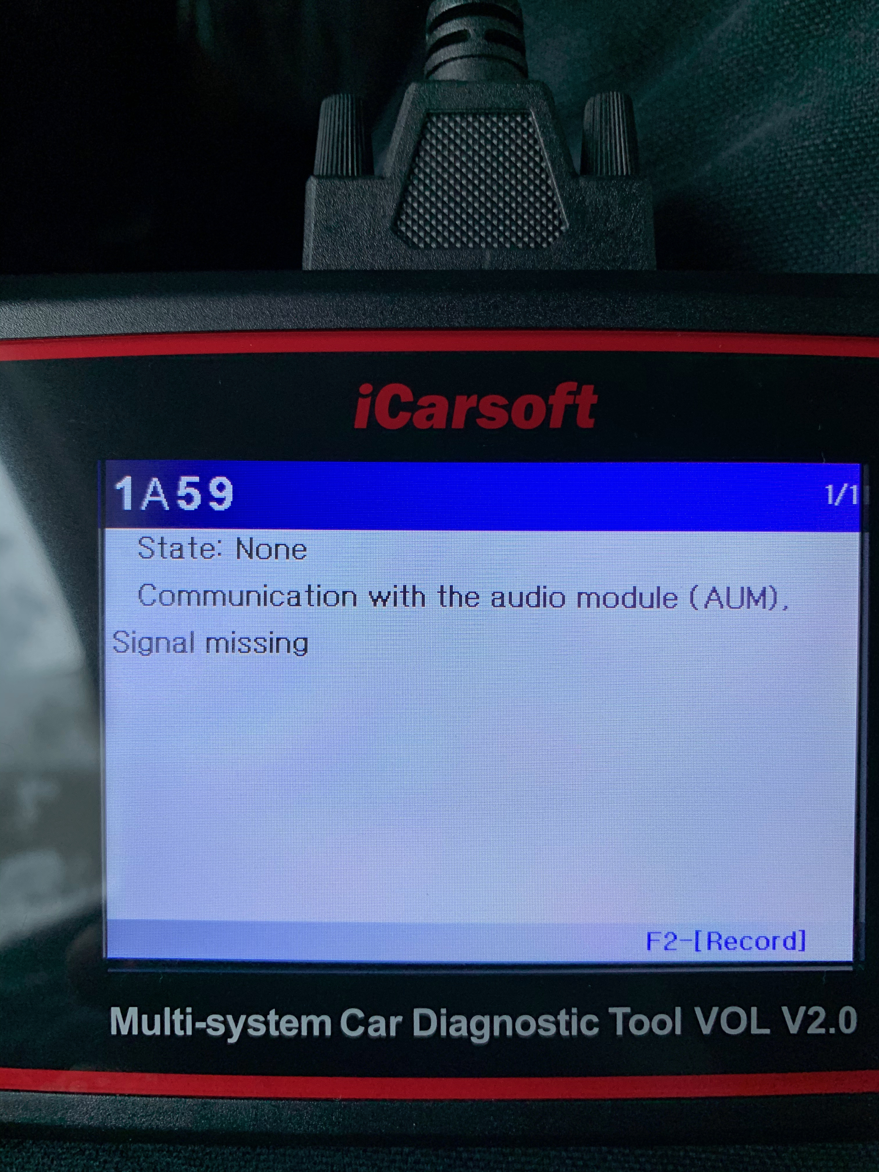

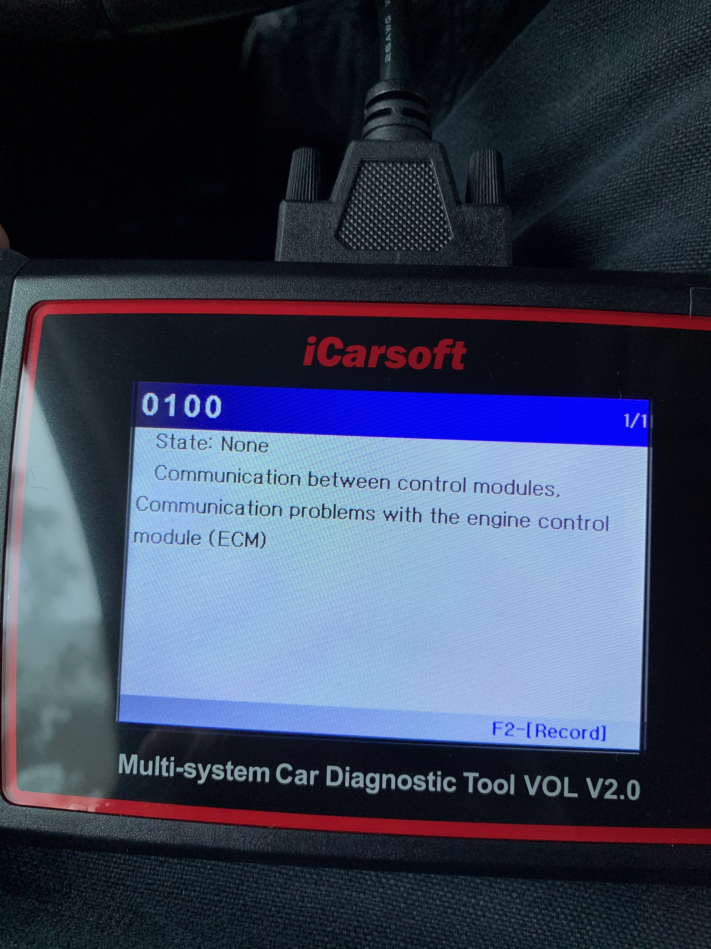

I pulled codes that said
0100 communication between control modules. Communication problems with the engine control module ECM.
also 1A59 Communication with the audio module (AUM) signal missing.

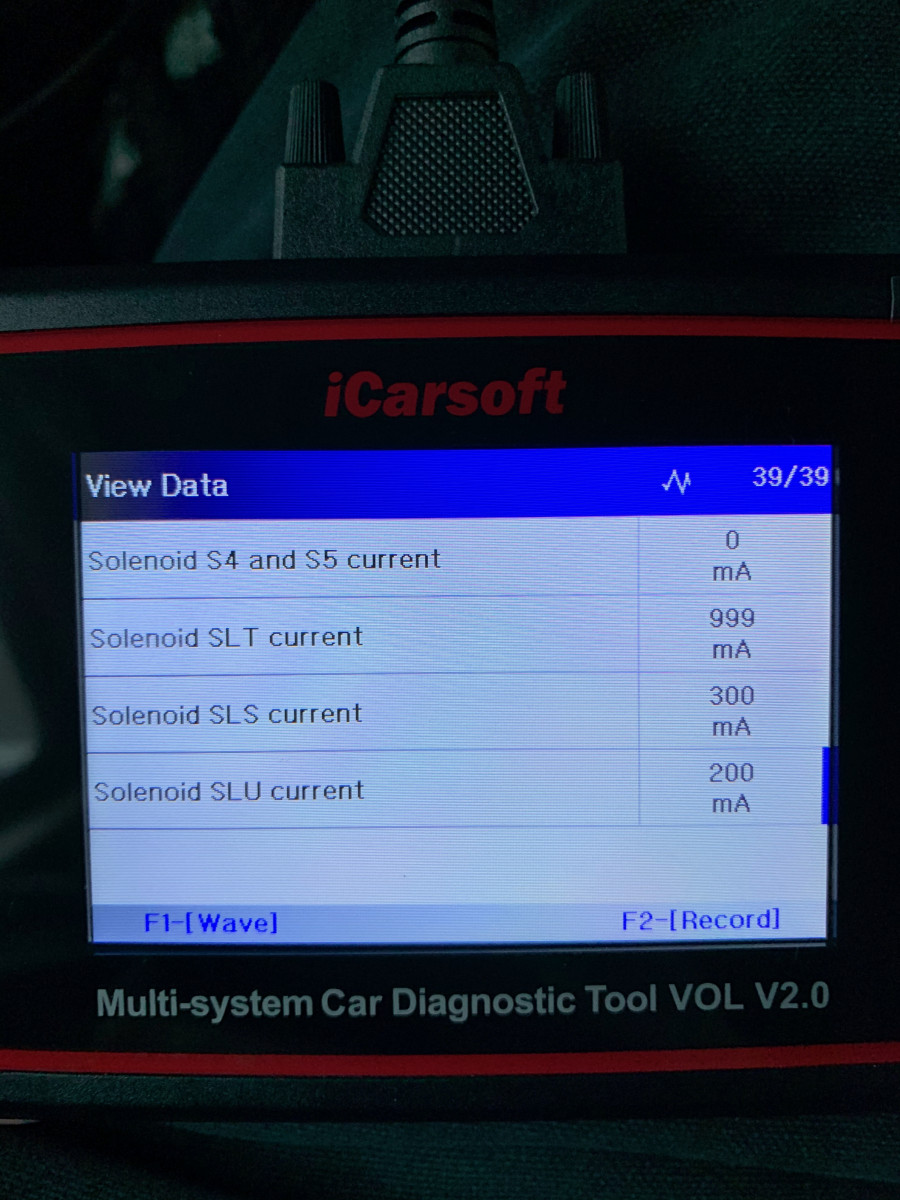

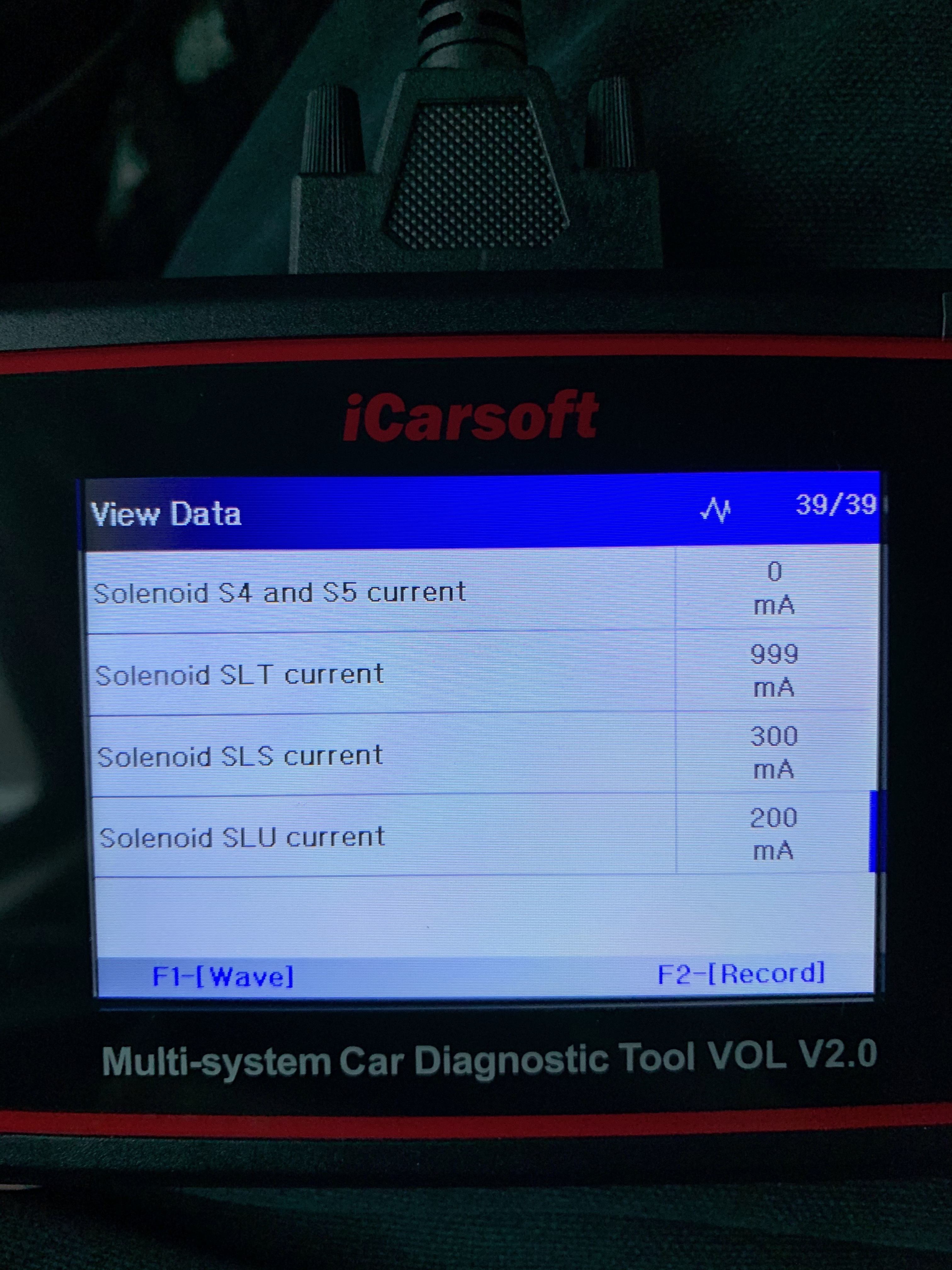

I also noticed that the Solenoid SLT current was jumping around a bit and was reading 999mA but was going up and down a bit. The SLS current was 300mA and the SLU current was 200mA.

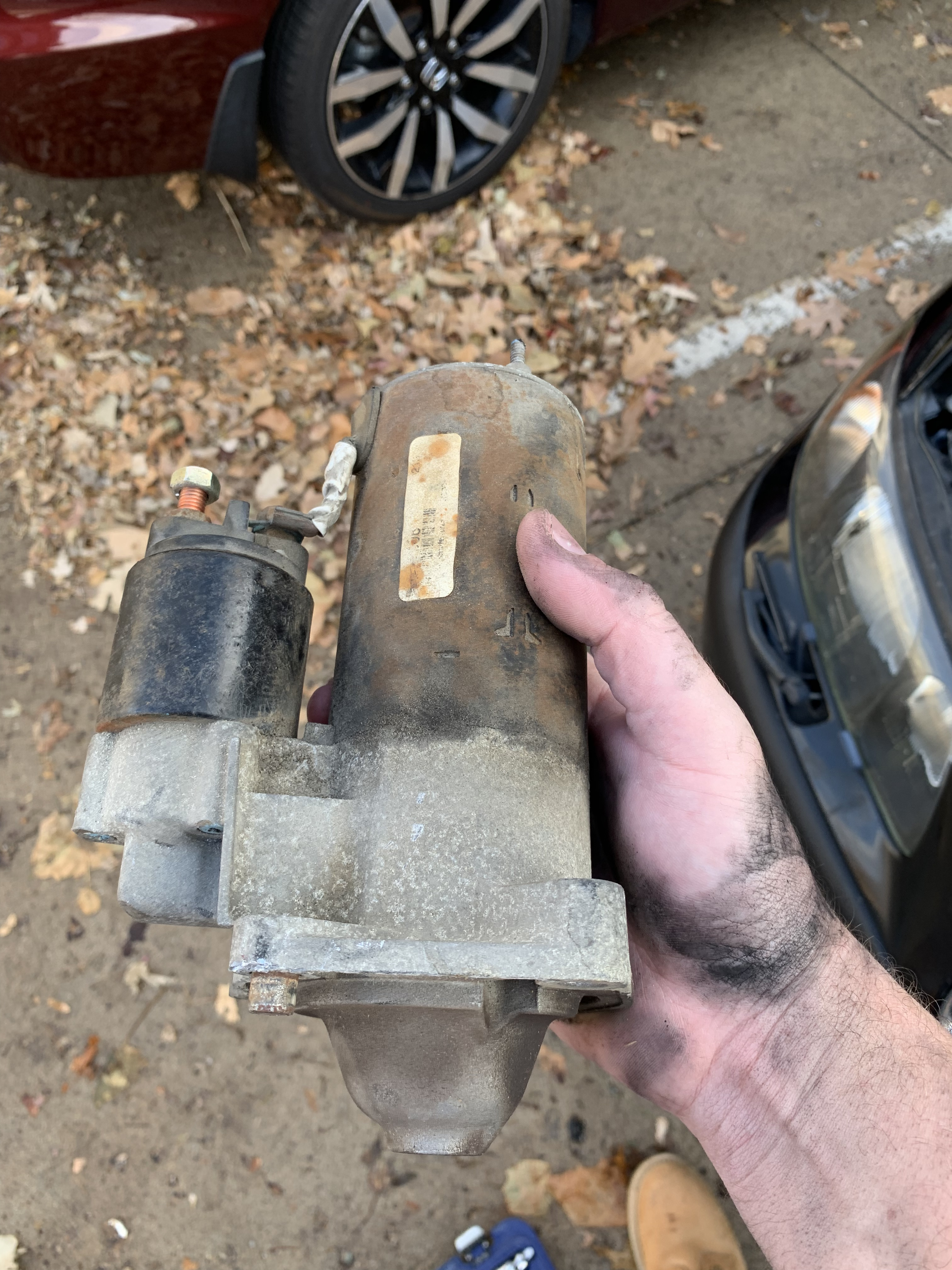

Issue still remains, I did get it started in cold weather today. It took about 5-6 seconds of cranking the motor over. I’m going to replace the starter next. I’ve read wires can go bad and arch in cold weather.

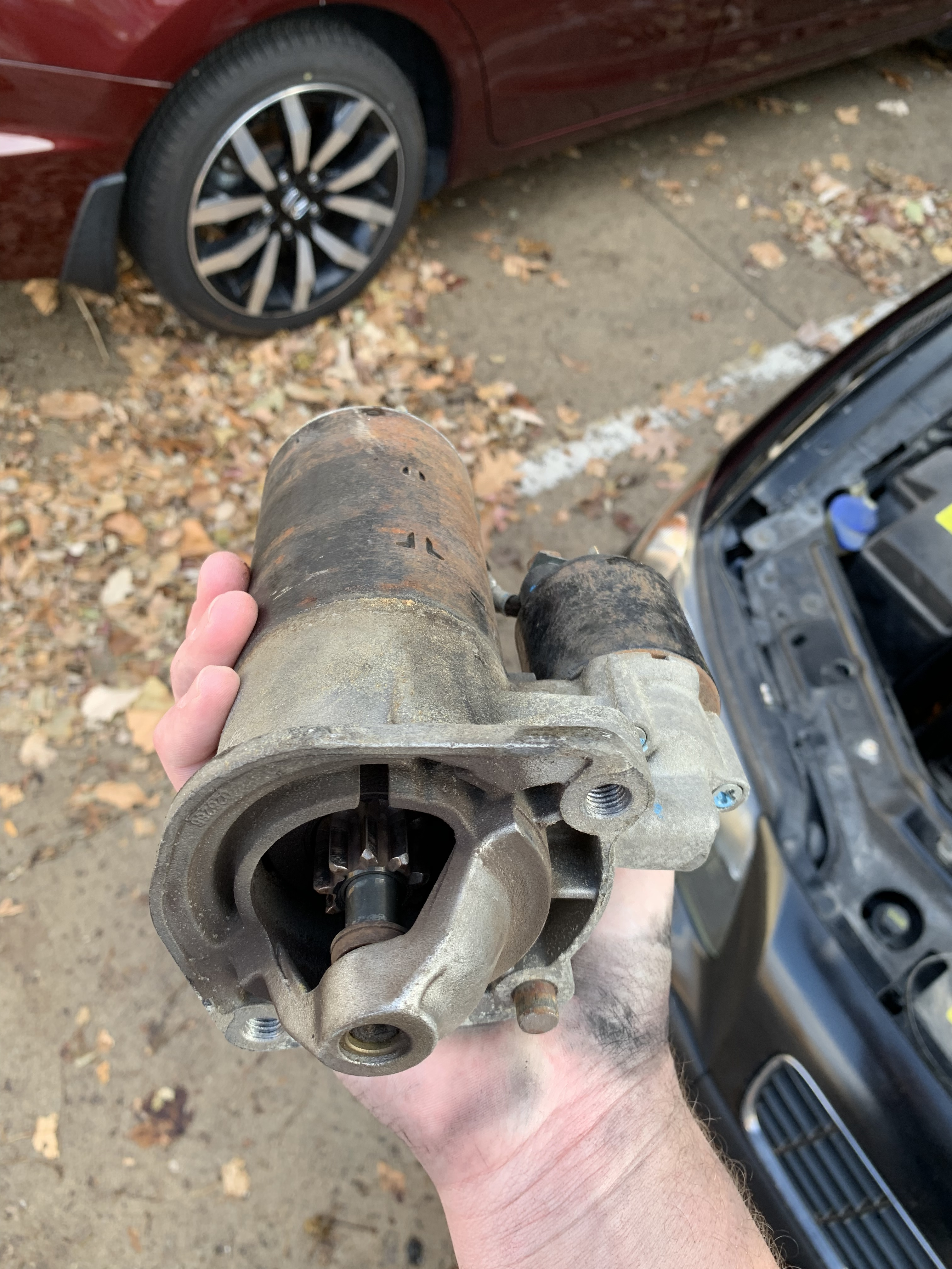

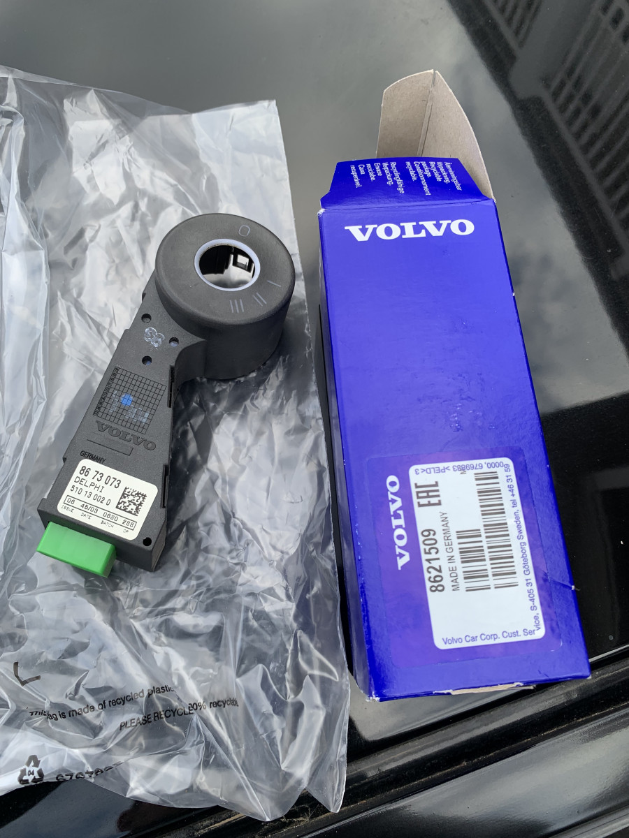

Post by nucci480 »
Got back out today, put in a new key ring immobilizer and starter. The new starter seems to crank faster, hopefully this is the solution. If the issue still remains I’ll be sending the computer units in to get checked. Very rarely do I find a mechanical issue I can’t solve. This Volvo sure has me stumped though.

Post by nucci480 »
Went out and tried to start today 23F outside. Cranks faster with new starter but still does not fire. Fuel pressure was reading 0Psi at the rail. Pushed the schrader valve in and no fuel came out. I swear I fix one issue and another component seems to quit.
