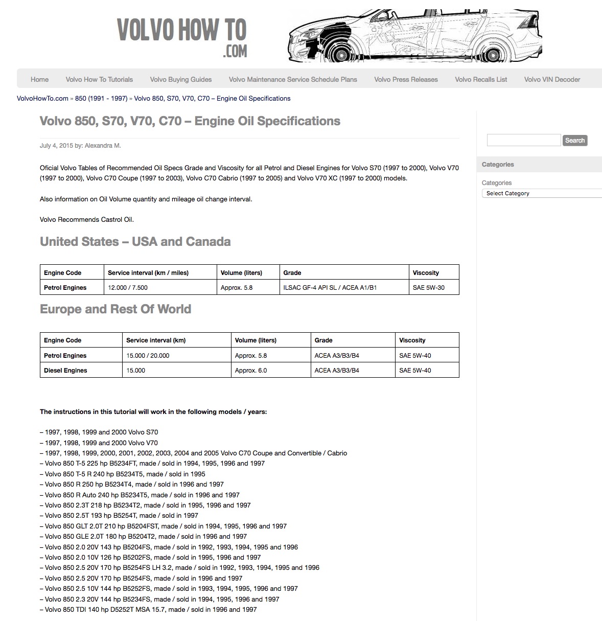

It would be interesting to find an OEM manual from this generation of engines to see what is told about that. If i don't say stupids things (which would be astonished from my part...), i believe have read that between low and high dipstick oil level, it may be something about near a liter of oil.
The next time you will drive your "baby", see the oil level after 15 mn, engine off. Then before the next trip, look at the level cold engine. You will see if you miss or not oil.
Have a look here
https://www.volvohowto.com/volvo-850-s7 ... l-engines/ Manov
Have a look here
