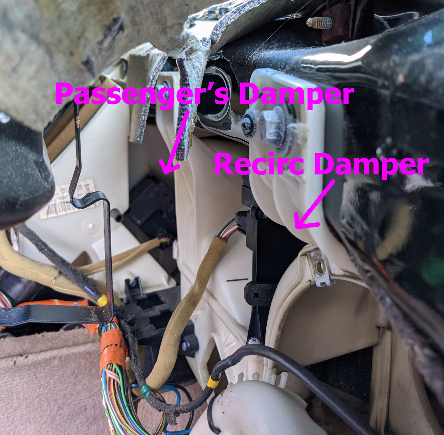

How do you get the five damper/flap motors? I found the recirc and floor/defrost motors in the passenger's footwell, screwed to the white air dam which holds the blower motor and the A/C condenser. Their screws are impossible to access. The cold air arm and rod are buried in the air dam as well. I would have to remove the entire air dam, which I tried doing but only found two bolts high up behind the dash. Are these worth the effort?
I easily pulled the blower motor, air duct temp sensor (left of blower motor), resistor (left of temp sensor) all from the passenger's footwell. I got the ECC and cabin temp sensor by pulling the radio. While tearing apart the entire dash, I got the key chip sensor and cruise control stalk (mine failed after 10 years). And I got practice disassembling the dash!

The recirc motor is on a bracket, which you can access the screw and remove it attached to the bracket
There are only four motors after a vin split in 1999. The driver side two motors got condosolidated into one.
One distribution motor
Two blend motors
One recirc motor
Two blend motors
One recirc motor
