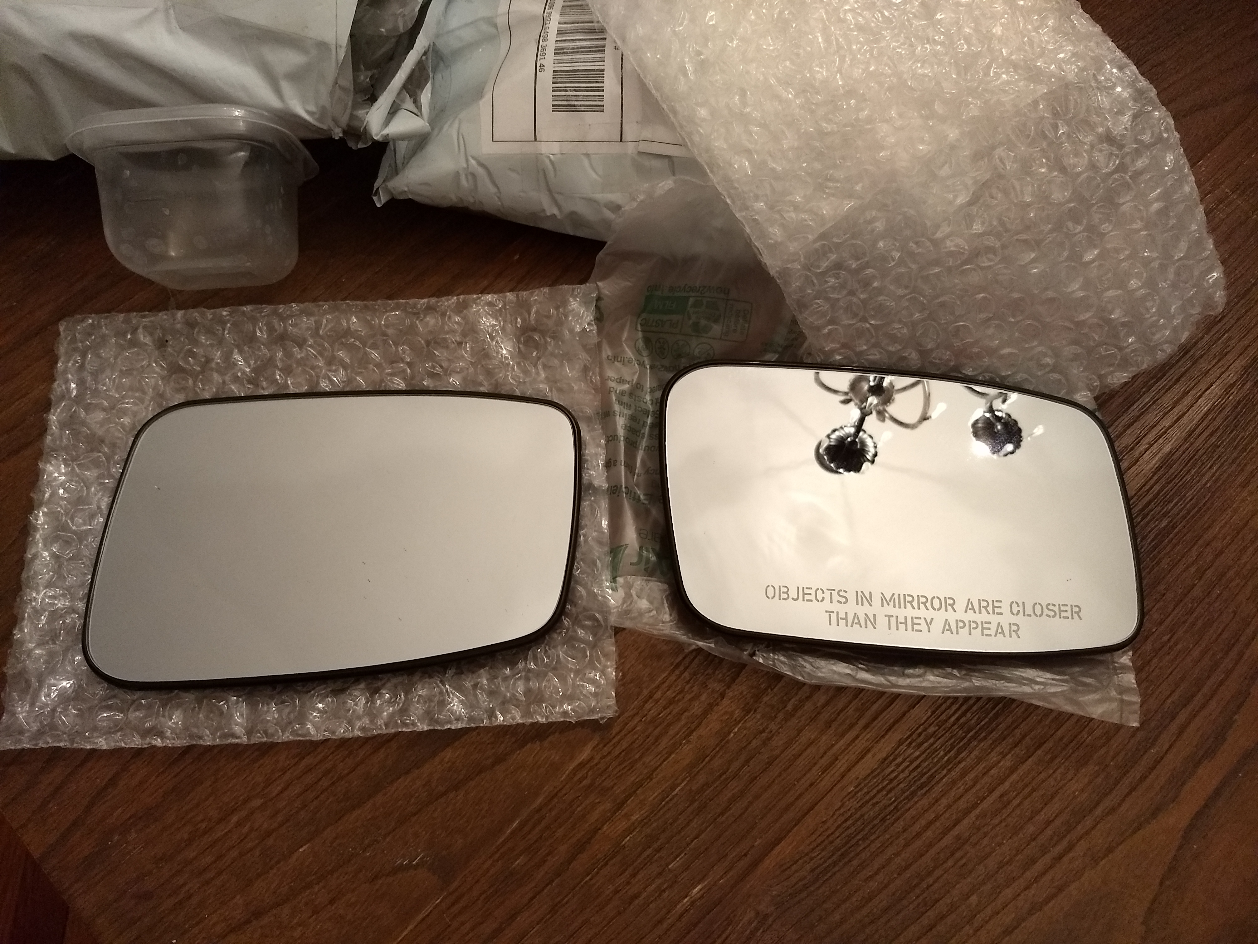

Tonight I replaced the driver-side mirror I bashed into my trash can, and the busted passenger-side mirror I foolishly had replaced with flat glass instead of the convex, wide-angle glass.
It was dark, so I only took a pre-installation picture.
Headed side-view mirrors, 1998 V70.

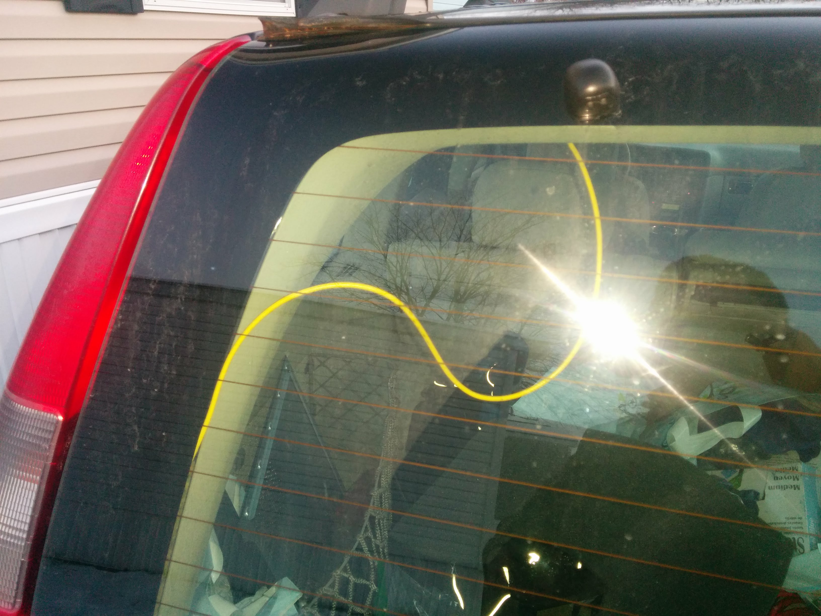

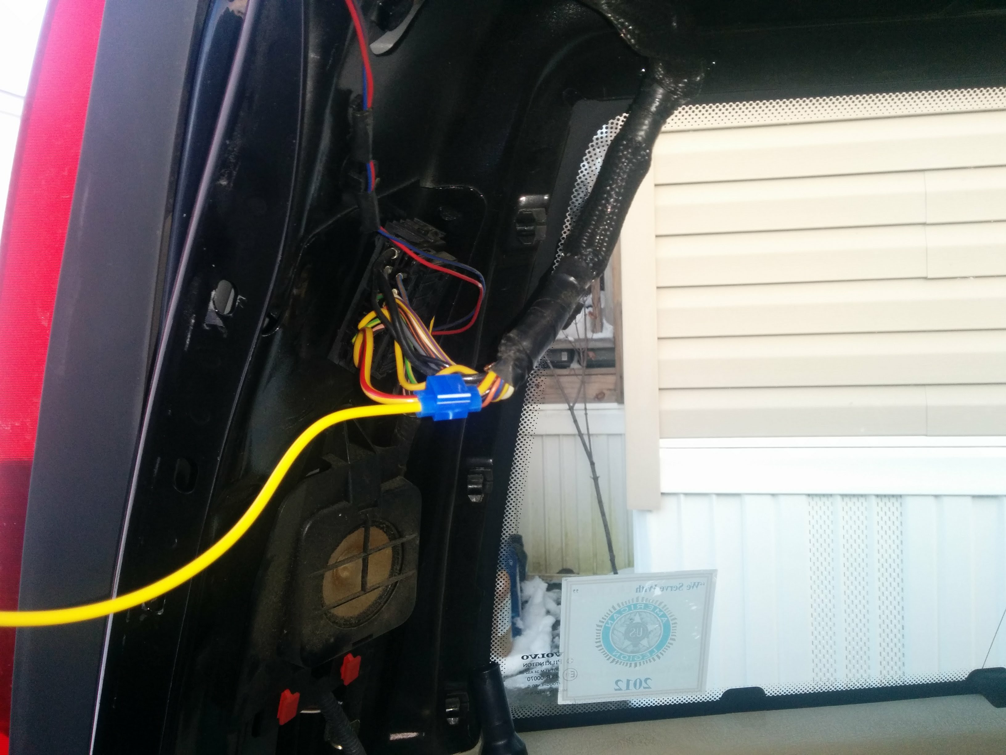

Completed the jury rigging of the rear defrost. Hasn't worked since I bought it and last night was the first snow storm...
There is a lack of continuity on the wire. For now this will do the trick. Is it proper? No. Is it the ideal solution? No. Will it get the fricking frost and ice off? You bet!

wizechatmgr wrote: 10 Dec 2017, 14:34 Completed the jury rigging of the rear defrost. Hasn't worked since I bought it and last night was the first snow storm...
Sometimes you just have get inventive, nice job!
Ouch... that picture of the trunk wiring is making my PTSD act up... I hate that harness. My trunk lock still doesn't deactivate my alarm upon unlocking. I repaired a few wires, cleaned them up all nice with some corrugated wire covering, closed the trunk, and it worked. Next day I try it again, the alarm goes off. I've given up on that.
Which reminds me I'm still wondering why my cruise control isn't working. It stopped working for some reason a while back, then last month on my way to a car meet it magically started working again. Next day it stopped and hasn't worked since. Maybe it's trunk wiring related, who knows.

bmdubya1198 wrote: 11 Dec 2017, 08:27
Yes it is related to trunk wiring failures at least. I actually found a non fail safe mode for my cruise on my 99 when the trunk wiring took out my immobilizer, it also inhibited the clutch switch from dropping the cruise.

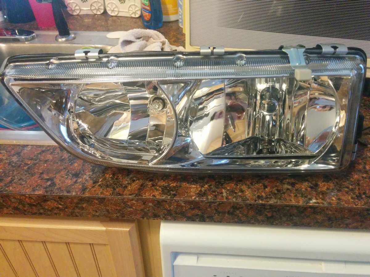

New headlights arrived. One good assembly, one broken - adjusters. New new driver's side on the way.
These will look great on the '99 and have to throw more light than the ones I have. One side is tipped upwards, the other downwards. The car has googlie eyes and it sucks at night.
Especially if turned right side up before installation...

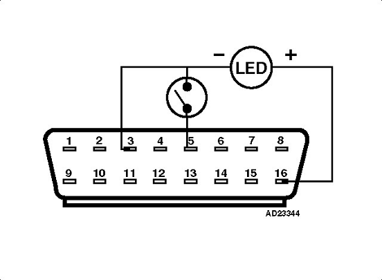

Tried to fix my ECC system in my '00 V70xc.
Had no aircon coming on, but automatic heating worked fine. Especially annoying when trying to demist the windshield.
Cleaned the interior temp sensor a week ago, but kept getting the blinking orange lights on startup.
Built a 'led flasher OBD reader' as suggested for older models. Was not able to read codes but think I succeeded in resetting the system. Cleaned the sensor again. Now all seems to be well again :) no more orange lights and A/C kicks in as normal! Hope it will stay this way. Any others that did a similar fix?
This is the led code flasher that I built. I was not able to read codes, probably only works on OBD-I and not OBD2. Think I did reset the system by depressing the button for 5 seconds.
