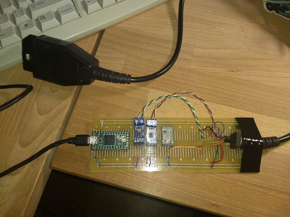

Post by MaxDenisov »
vtl wrote: 08 Mar 2021, 21:44
can you please send picture from bottom side? it seems that your wiring a bit different from schematics
vtl
Posts: 4936
Joined: 16 Aug 2012, 13:35
Year and Model: 2005 XC70
Location: Boston
Has thanked: 130 times
Been thanked: 686 times
Post by vtl »
The wiring is bad here, I connected +5 from DC-DC to +3.3 on Teensy, plus the low-speed CAN has the L/H pair twisted :) It was just an illustration that I finally was able to fight back my laziness and solder the cracker for the field test.
You previous scheme is what I have (+ step down DC-DC).
