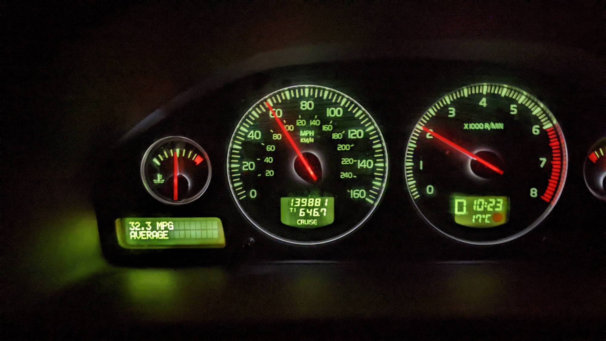

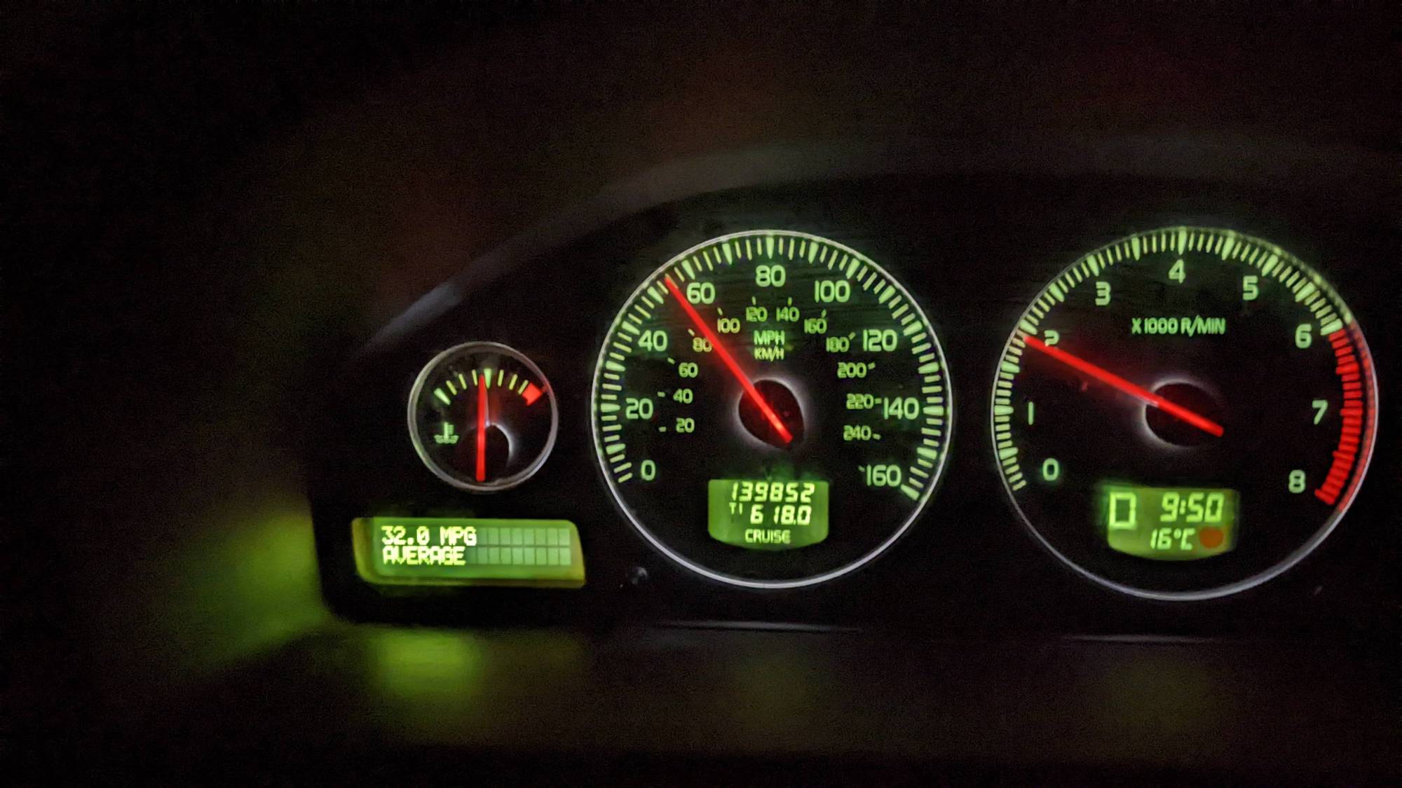

weitau wrote: 31 Dec 2023, 12:42 Very happy I didn't damage my engine from a low oil level condition a few weeks ago :)
These pics were taken 2 days ago, after driving mostly steady 60 mph on highway, Shell mid grade gas 89 octane, light breeze, Walmart 5W-30 high mileage synthetic oil, low load in car, 35psi tire pressure, Sailun Atrezzo tires, disconnected radiator fan.

I can see that you could achieve this kind of mileage under ideal conditions, and only highway driving.
A few years ago I managed to get 33mpg in an 05' V70 base, 5-speed and skinny tires. This was on my commute with 3/4 highway and 1/4 back roads.
As soon as you add a turbo, AWD and bigger tires your mpg will go down dramatically.

Yes, I agree it has to be under ideal conditions. The best I could get before was 32 MPG going south on I95 in the Carolinas a year earlier. I don't remember, but I probably was using mid-grade 89 octane and kept it at 60mph (not realistic agreed). I don't have a turbo, FWD, and I'm on skinny, stock tires 215/55R-16.
In city driving, my wife gets 19.3 mpg avg, but I can get over 20. A lot has to do with your driving habits such as frequent short trips vs highway, etc. Once I get my thermostat fixed, my city driving should improve.
