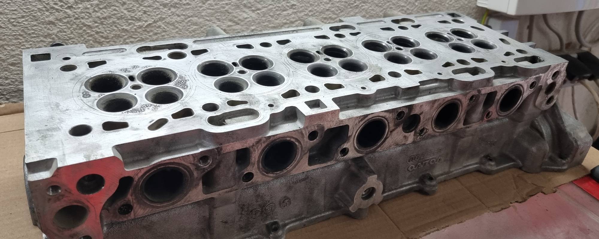

Today I did finish walnut blasting the head.
Also took some measurements with a straightedge and a thickness gauge, the head is not bent!
My thinnest gauge (0.04mm, 1.6mil) did not fit through. So milling is not necessary.
Upcoming days I'll give it a good clean and then start to reassemble the engine.
While I'm in, also replacing every gasket I see.
Really keen to see, if replacing the head gasket and valve stem steals did something for the blowby.

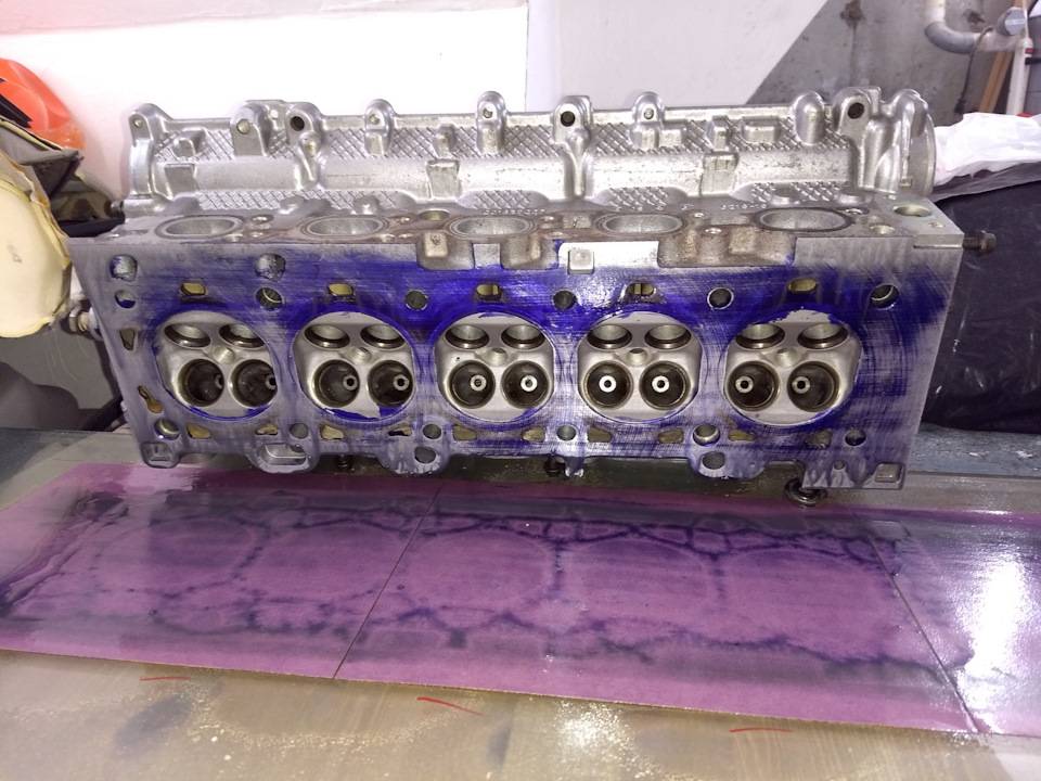

Ah... I love the smell of dykem blue in the morning. Always makes me day dream of freshly scraped ways floating past eachother on a thin pillow of way lube 68..vtl wrote: 15 Feb 2024, 16:43 You still want to polish the head. It inevitably has depressions (low areas) between combustion chambers and water channels.
