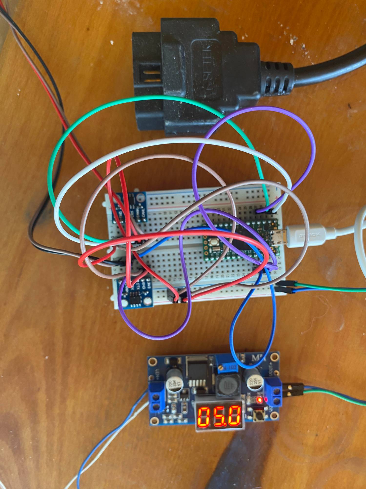

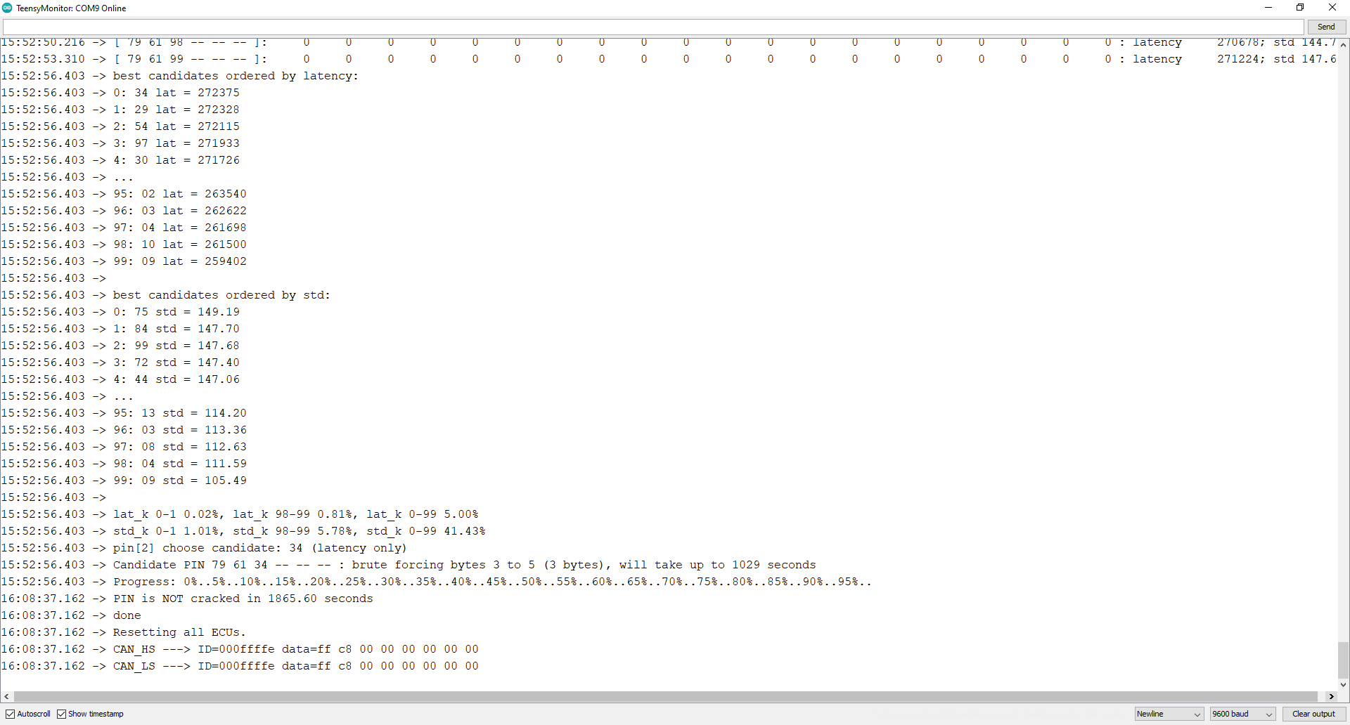

I prepared my circuit as in the picture. I connected it to my 2012 model XC90. It calculated the first 3 PIN codes, but could not calculate the last 3 codes with brute force. The transaction file is attached. can you help me?
thanks.

You are running an old version of the code, pull the latest from github.Bekirebu wrote: 05 Sep 2023, 06:12 Hello everyone
I would like to thank all the participants who prepared and supported this magnificent project.
My English is not very good so I use google translate. Please forgive me if I have any errors in expression.
thanks.
Also I see a few problems with your hardware:
- not soldered (a lot of resistance in those pads that is particularly bad for high frequency signals)
- thick aluminum wires (I think they are aluminum or copper plated aluminum?)
- CAN pairs are not twisted... (must for differential signalling, which CAN is)
- ... and seems to have a different length (must for differential signalling)
- how noisy is your DC-DC converter?

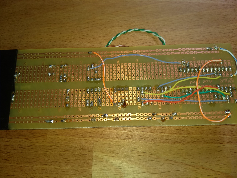

Here's for example my cracker, which I'm not very proud of, but it cracked every uncrackable dump other folks have sent to me: copper PCB, CAT 6A Ethernet twisted pairs (500 MHz), short AWG30 (0.25 mm) wires to run signals to Teensy, very tight DIP socket. CEM and the cracker are both powered by a low noise lab power supply.

Try the latest code first: https://github.com/vtl/volvo-cem-cracker
Also if you run it a few times do you get the same first 2 bytes? If only the third byte differs you could change CALC_BYTES to 2 https://github.com/vtl/volvo-cem-cracke ... er.ino#L13 and leave it running for up to 18 hours (worst case). It will brute force the rest 4 bytes.
