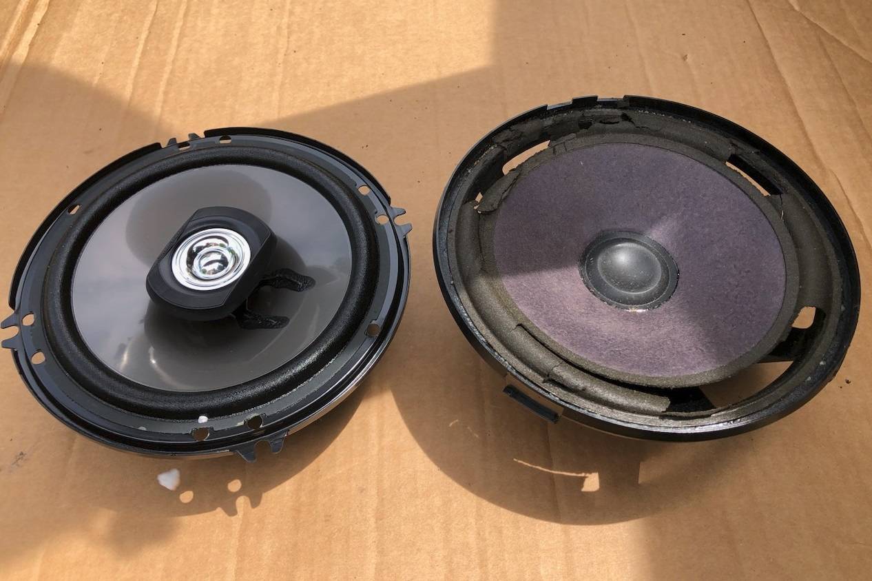

6) New 6.5" door speakers a week ago. Factory speaker had huge magnet and was full range so matches better with the OE tweeters. 22 years old with surround foam disintegrated still sounded better than new speakers. Discovered you can re-foam the surround.

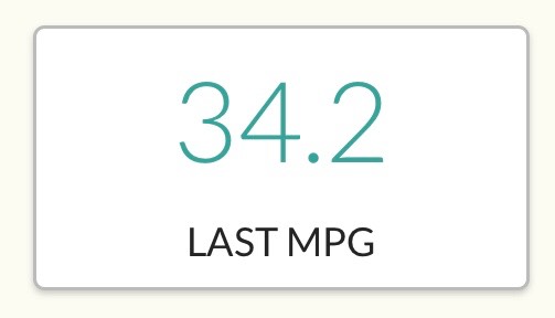

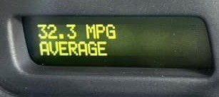

I’ve just completed 430 motorway miles using cruise control. I reset the OBC when I fuelled up and when I arrived the OBC said my fuel consumption was 32.3mpg, however a manual calculation plus the Fuelly App confirms that the fuel consumption was actually 34.2mpg. I was always under the impression the OBC over estimated the fuel consumption.
OBC estimated reading
Actual calculated reading

What speed do you drive to get this mpg?

Cruise control set and speedo showing 77mph

My v70XC get about 26 on the freeway. I think the engine is pretty similar to the one in your 2.5T v70. Does this indicate anything wrong, or does the all wheel drive system reduce it?

UK vs US gallons 34.2mpg UK is equal to 28.5mpg US

Ah, I didn't know there was a difference.
