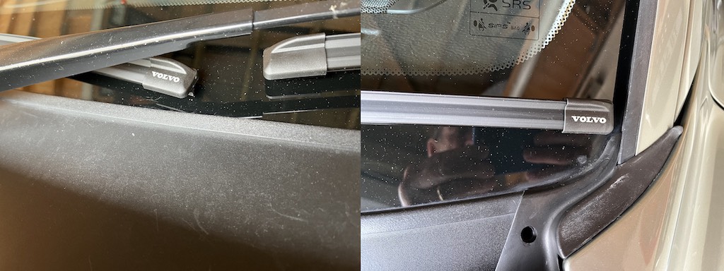

I started with the easiest job first and fitted my Volvo wiper blades

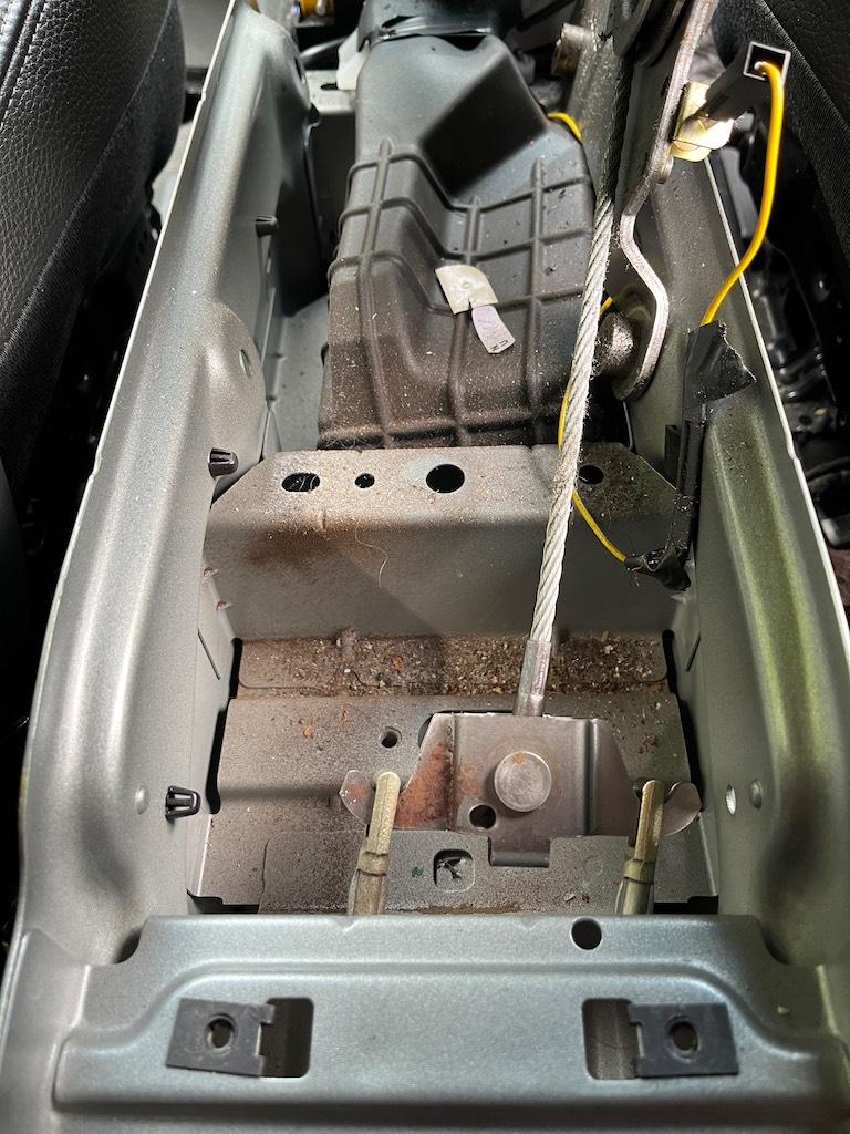

Last year when I fitted new parking brake shoes one of my cables was sticking. I freed it off but it was never quite right and the handbrake lever never sat fully down, it always bounced up a few millimetres. I bought cables last year so today I decided it was time to fit them. Well that's when the fun started, the centre console needs to be removed from the car to allow access to the cables, the rear seat bases need to come out to allow access under the carpet and truth be told I've been desperate to pull the centre console since I bought the car to clean the muck underneath, so it's been a busy day
This was the clean part, all the spilled drinks sticky substance was at the front

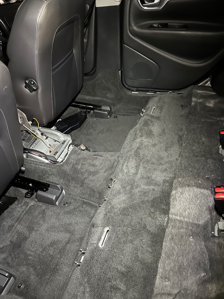

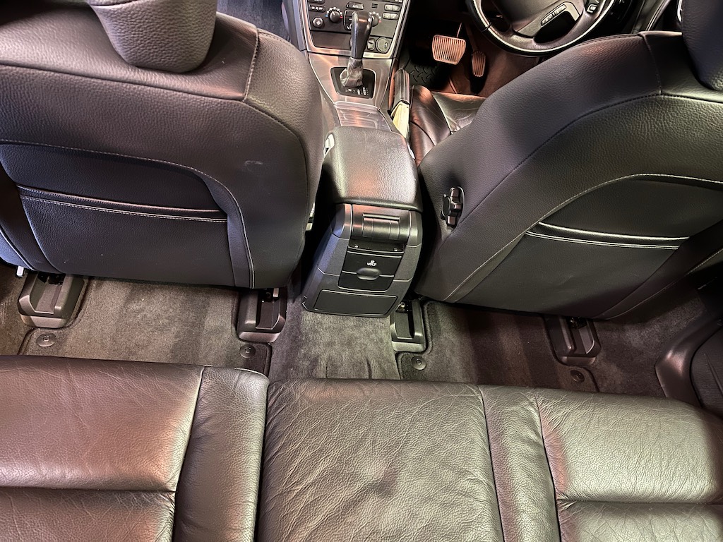

Seat bases removed, centre console removed, door thresholds removed (1 broken clip)
Looking better

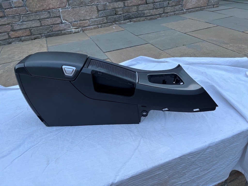

To preserve my sanity I spend almost 3 hours stripping the centre console to bits and sticking Tesa Tape all over it to stop the squeaks
Parking brake cables fitted (not fun) rear discs fitted, waiting on a new caliper and two flexi hoses before I can proceed.

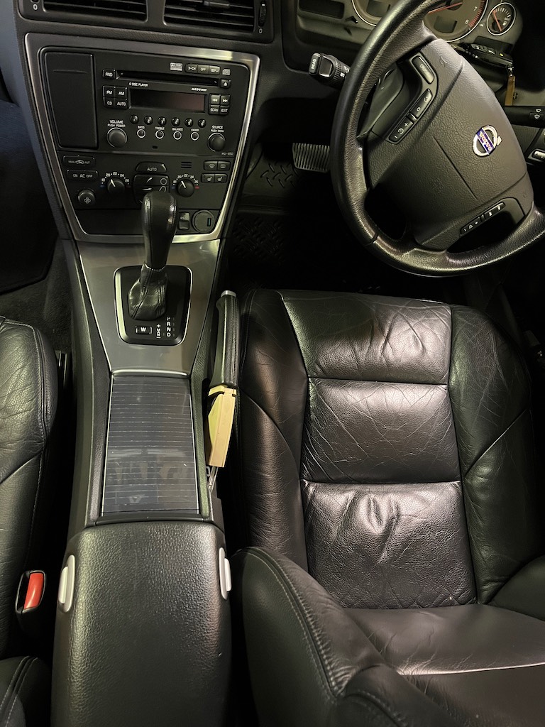

I was attending a local car show with the 850 today and I wasn't planning doing anything to the V70 when I came home, but the sun was out so I decided I may a well put the centre console back in. I'm pleased to say it went back in a heck of a lot easier than it came out. I spent some time with the Dremel removing some plastic so that the silver gear lever surround would sit better as it has never clipped in at the top left corner properly. Glad to say for the first time it now sits as it should and I won't have to push that corner back in when driving along.
The 850 at the Milngavie show today
I'll refit the parking brake gaiter once I've completed the brake job and took the car for a spin to centre the shoes.

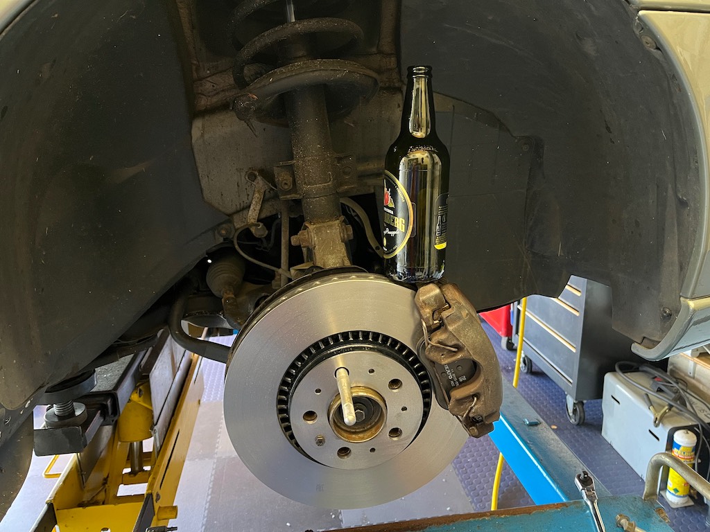

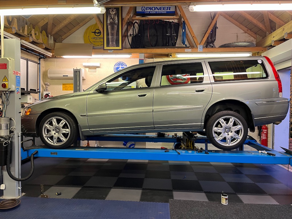

The new rear caliper arrived this morning but I'm still waiting on the flexi hoses so I left the rear alone and concentrated on the front discs. The near side has been off before as the car had a new wheel bearing before I bought it, everything came off easily and the new disc and pads were fitted
NS Front.jpeg (224.61 KiB) Viewed 190 times

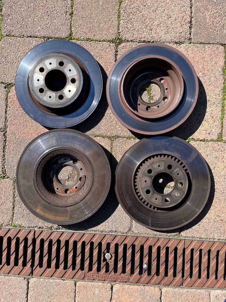

The off side has had the pads changed before I purchased the car, but the carrier has never been off since the car came out the factory The caliper pins were filthy on both sides and not sliding easily. Looking at the wear on the pads both were sticking ever so slightly causing uneven pad wear. Pins cleaned and lubed, slides de-rusted and lubed and everything put back together. Sun was out and the temperature rose to 23° so it was time for some refreshments whilst working.
OS Front.jpeg (198.08 KiB) Viewed 190 times
19 year old factory brake discs
Old Discs.jpeg (407.78 KiB) Viewed 190 times

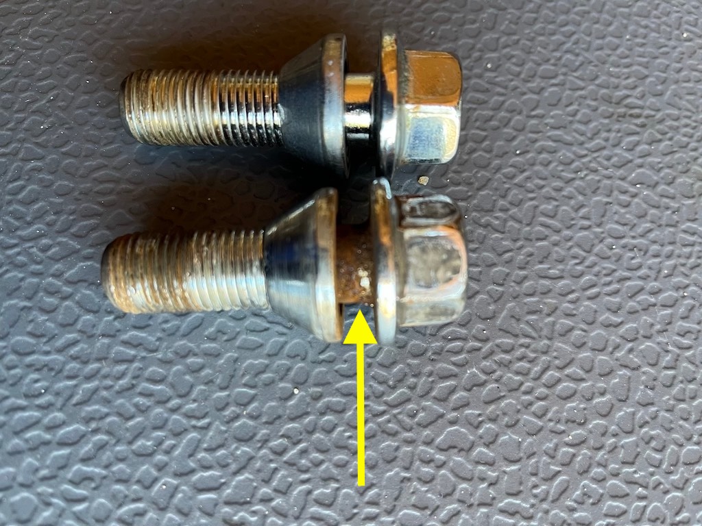

I noticed when removing a couple of wheels bolts they felt like they were binding up on the alloy wheel. Once removed and on closer inspection the cone of two bolts were seized so I spent a bit of time freeing them off then applied a little copper grease to the shaft between the bolt head and cone to prevent them sticking next time.
