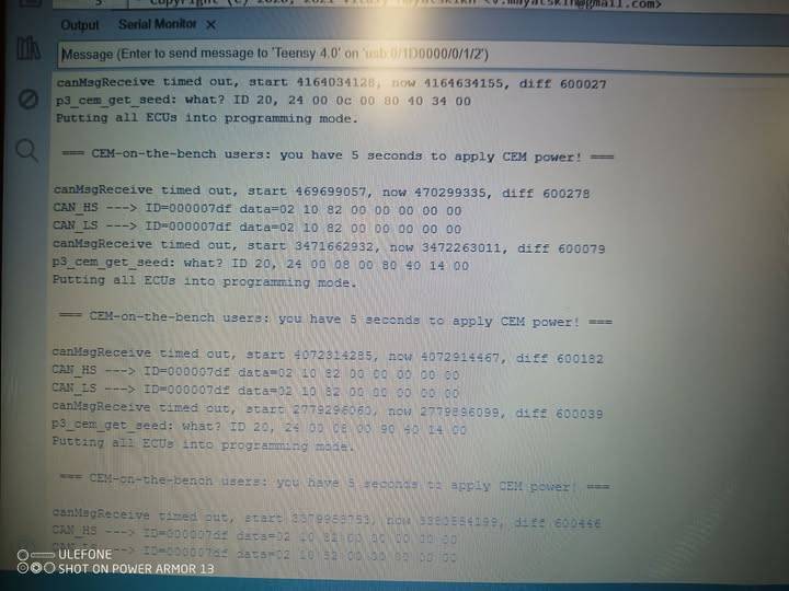

Hello
I have build volvo cem cracker teensy work good on p1 p2 but not on p3
I use p3 script
Thanks Have nice day
