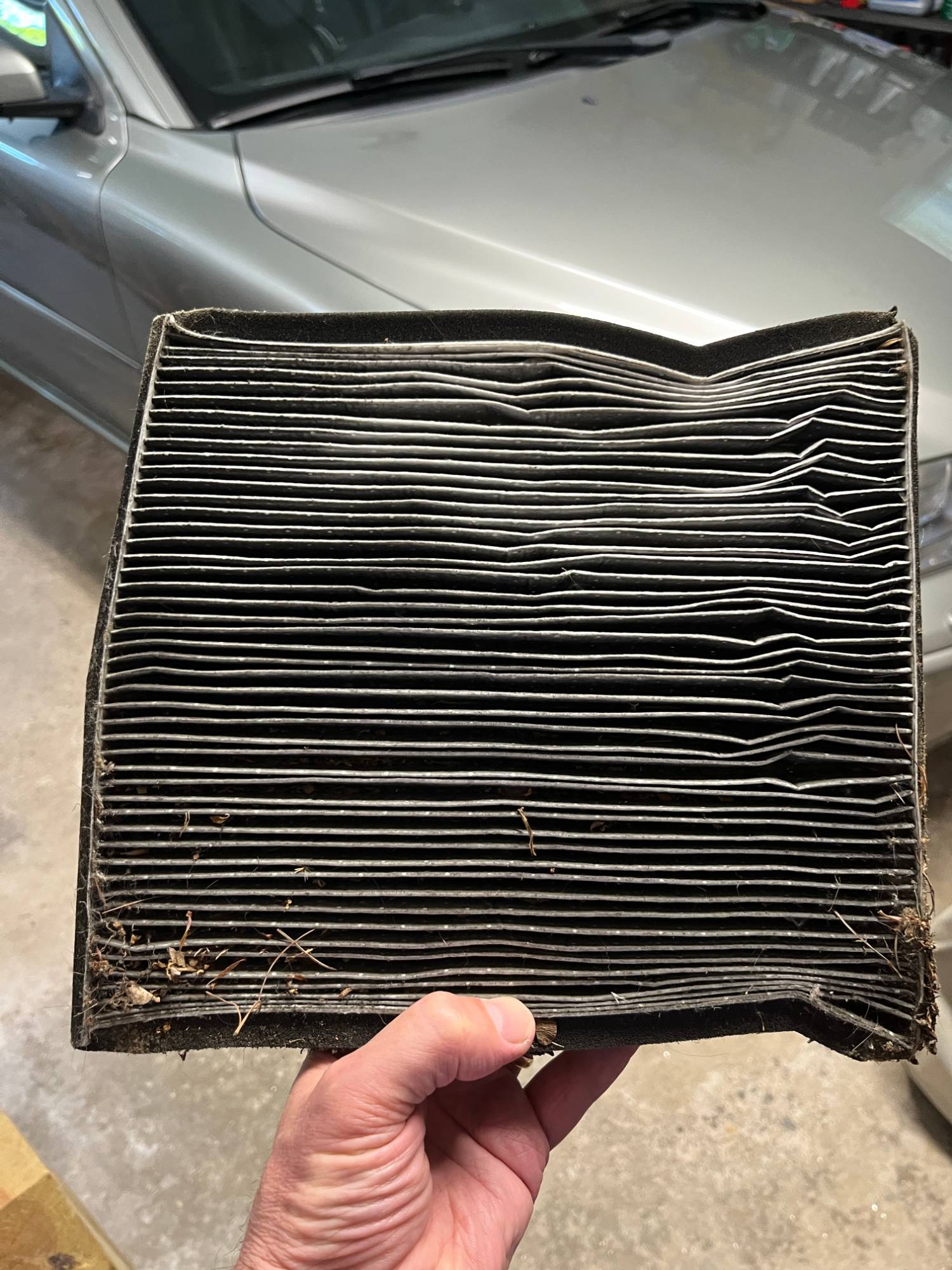

I also finally changed the cabin filter in Greta, my V70. Never did it since I bought the car 3 years ago, which was a bad mistake. The old filter looked terrible. It was some cheapo 1" Chinese one that actually was caved in at the top, which means a lot of stuff went by that shouldn't have. Hopefully that didn't cause any damage. Now installed is a 1.5" charcoal one from Mann.

850 LPT wrote: 12 May 2025, 13:44 I also finally changed the cabin filter in Greta, my V70. Never did it since I bought the car 3 years ago, which was a bad mistake. The old filter looked terrible. It was some cheapo 1" Chinese one that actually was caved in at the top, which means a lot of stuff went by that shouldn't have. Hopefully that didn't cause any damage. Now installed is a 1.5" charcoal one from Mann.
Those cabin filters are easy to neglect. You aren’t the first to go too long, I’m guilty too.

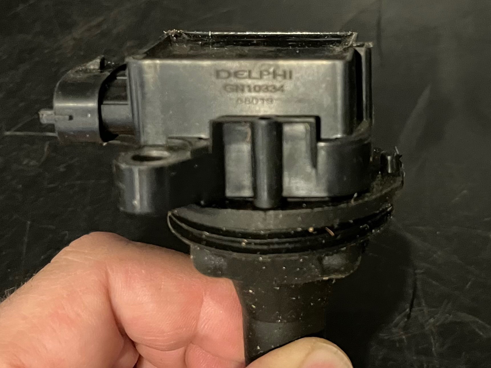

Youngest said the 05 XC90 was running rough. At 208k I was suspecting the CV shafts are finally causing vibration (new ones are waiting in the garage) but alas was clearly a 5 cylinder Volvo running on four.
Plug in the iCarSoft to find a Cylinder 4 misfire. Spare coil swapped and running smooth as silk. Glad the Volvo engineers have the codes to isolate the misfires.
I proactively replaced the coils 8000 miles ago (at 200k) with some Delphi cheapies…kept all the old ones as spares for such a situation.

Krons wrote: 16 May 2025, 19:16 Youngest said the 05 XC90 was running rough. At 208k I was suspecting the CV shafts are finally causing vibration (new ones are waiting in the garage) but alas was clearly a 5 cylinder Volvo running on four.
I proactively replaced the coils 8000 miles ago (at 200k) with some Denso cheapies…kept all the old ones as spares for such a situation.
8000 miles on a DENSO coil? Ooof. Sounds like FCP might be good to source those

abscate wrote: 17 May 2025, 02:18 8000 miles on a Delphi coil? Ooof. Sounds like FCP might be good to source those
Apologies I needed to double check…these are stamped Delphi, not Denso. But with being $10/ea from my eBay seller, very questionable if they are authentic. Given how easy coils are to change I figured it was worth the risk…maybe not so much and why I keep spares around. And of course they are past the one year warranty lol.

At least for me coil changes have resulted in resolved misfires. I didn’t try just clearing this code…suv was clearly running consistently on four. Agree thought that this may not always be the case.
