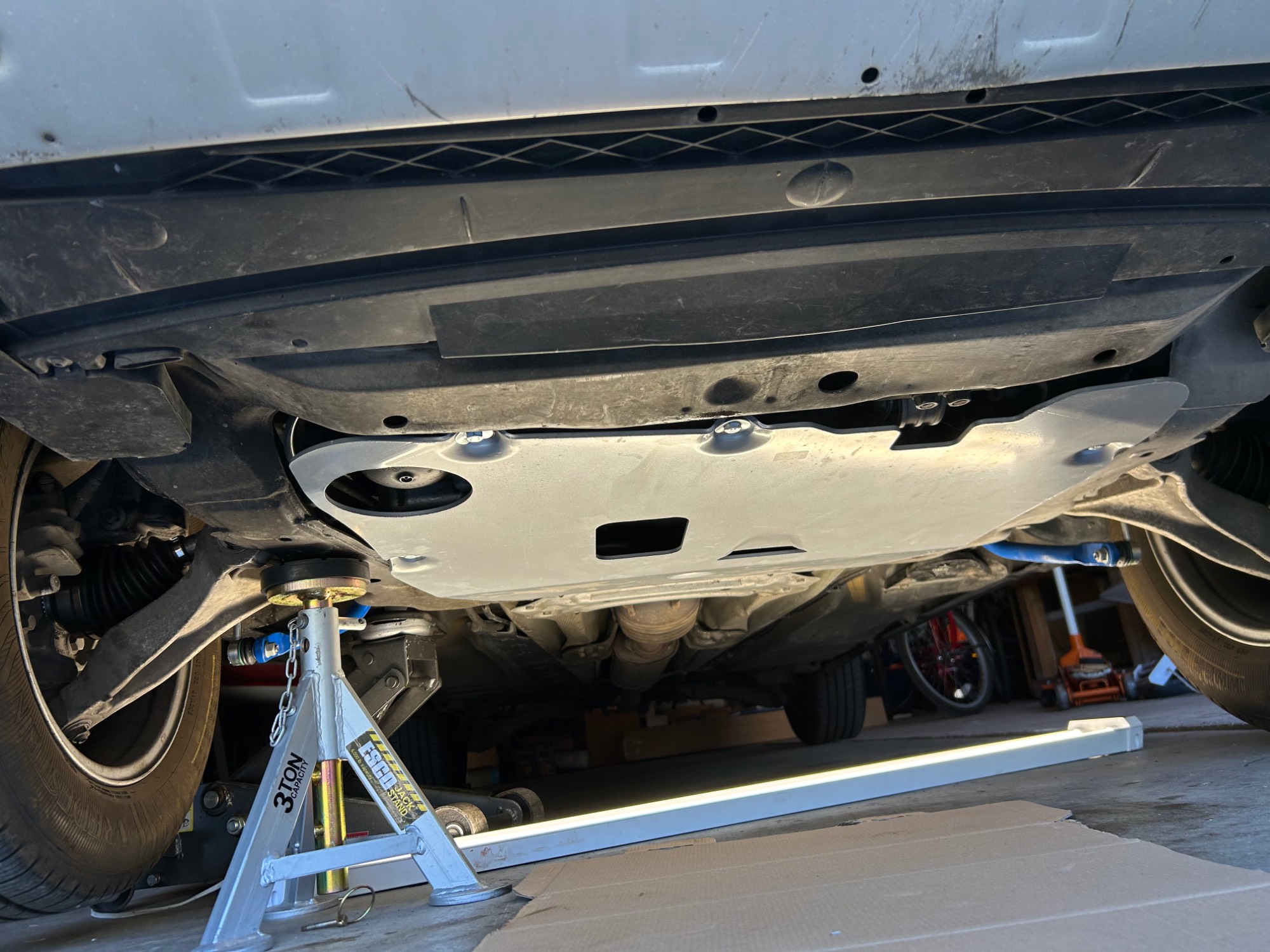

Shiny new (THICK) aluminum skid plate. My plastic tray was long gone, so I put this on.
