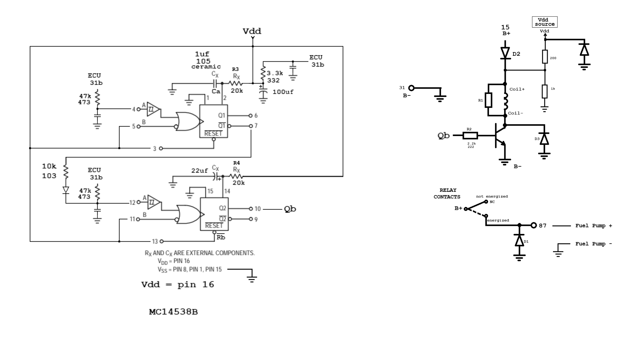

Oh no problem and i'll post the schematic as i have it so far, and i think it's pretty much done now.
I suppose if the relay contacts were to close and open repeatedly (such as when it buzzes) it could damage the pump because as far as i know the circuit is designed to turn on the relay once per start cycle and turn off once when the car is turned off. That would mean that any spike that would occur should only occur once, so if it occurred several times in succession that could have damaging effects although i am not sure what kind of damage it could do aside from maybe causes a problem with the wire insulation. What i would think could happen on the relay board itself though is it could blow a component out. One thing is almost certain, and that is that the circuit and pump were not designed to be turned on and off repeatedly, unless of course that was the designers way to tell the operator that there was something wrong with the fuel pump system.
One thing interesting if you look at the schematic is that the Vdd line (which is V+ power to the circuit IC and timing and such) power is derived from positive side of the coil. If the coil turns on and off many times in a row it is possible this could overdrive the Vdd line and blow something out. Apparently it doesnt happen right away though as my relay buzzed a few times in the past and the IC chip seems to be still working.

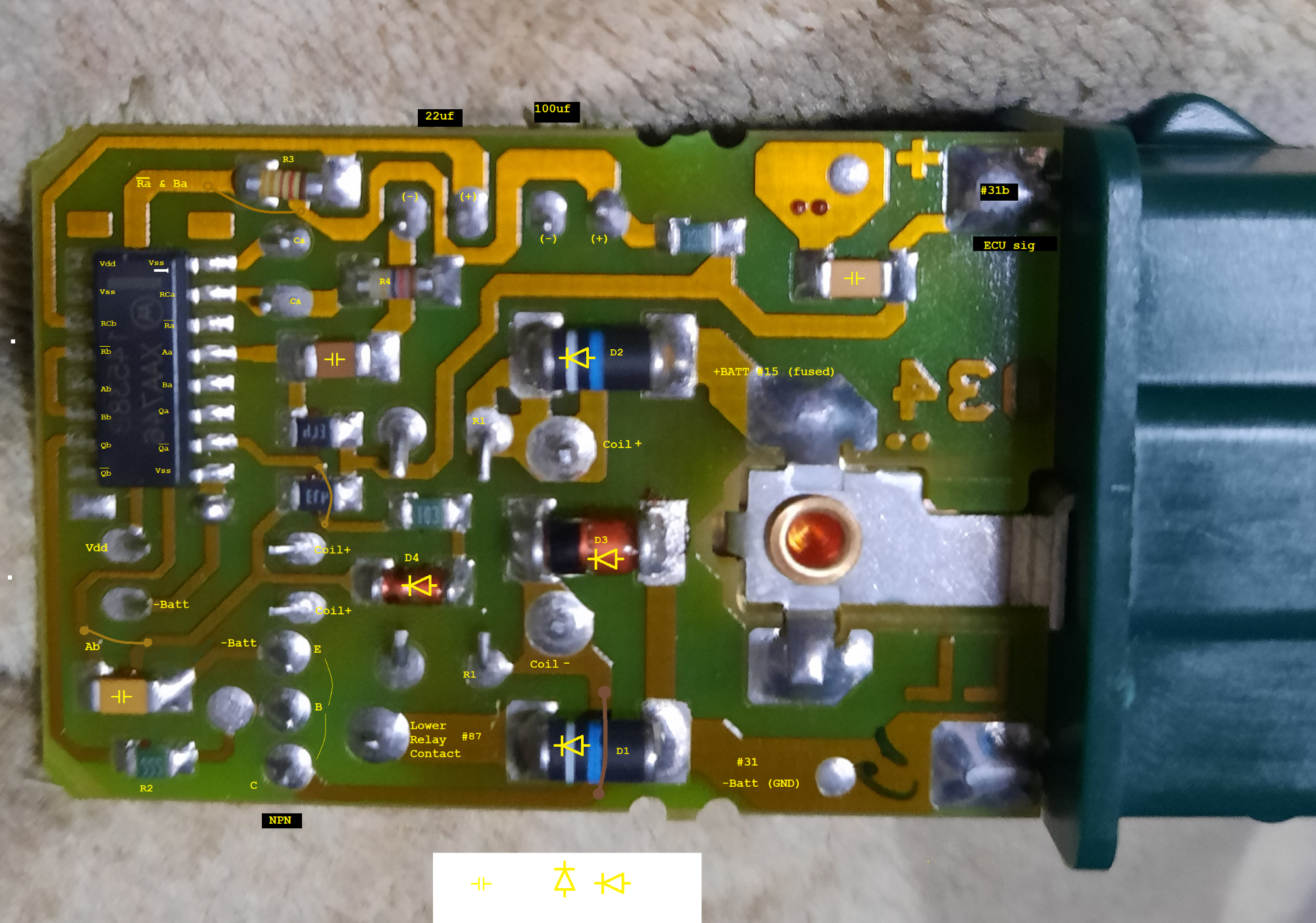

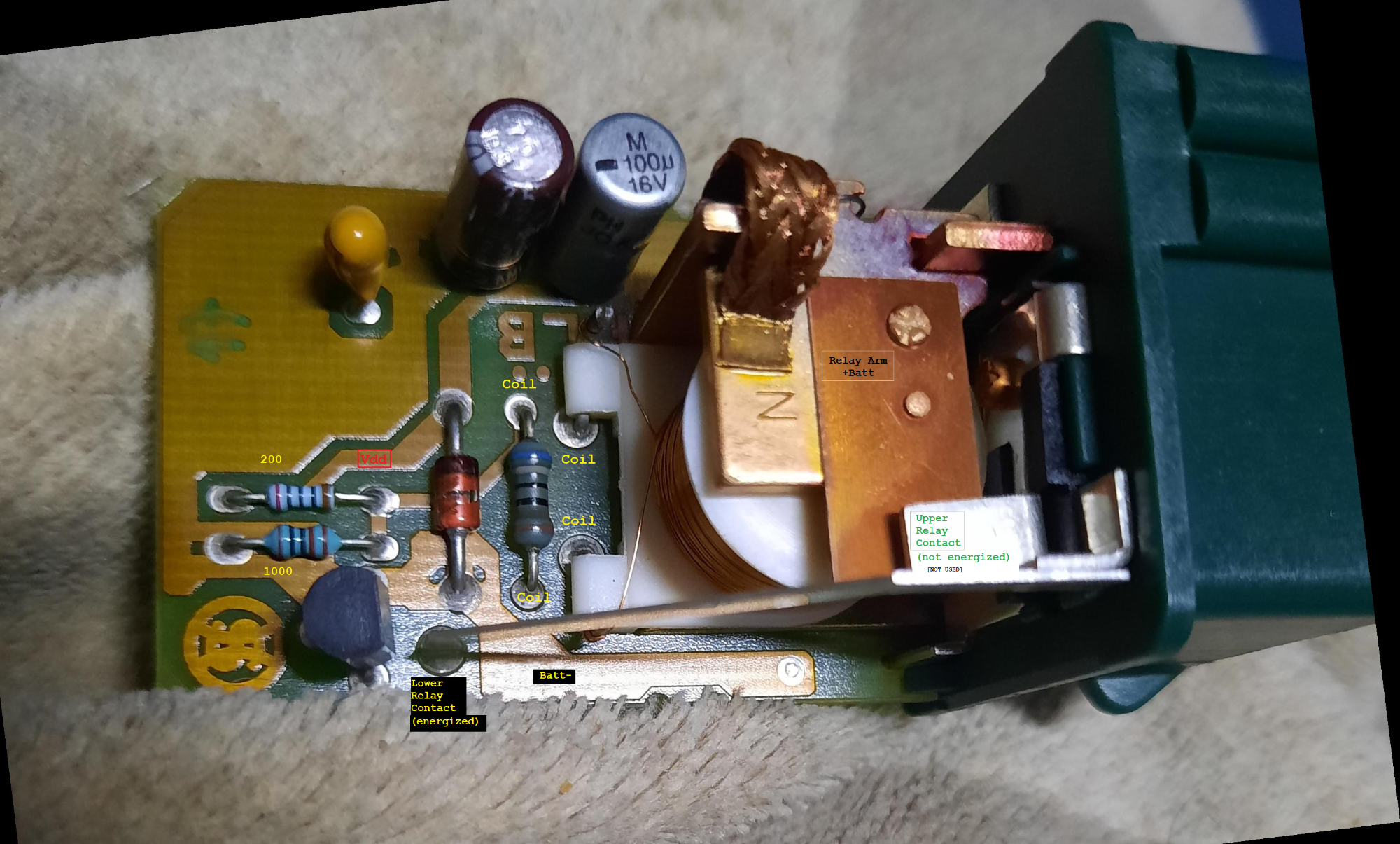

Anyway, here is the circuit see what you think, and a photo of the bottom of the board reversed so we can see components relative to the top side of the board by just scrolling the two pics (flipped bottom side, top side). The schematic is drawn by hand on the computer using a paint program. It's an interesting circuit that's for sure.
So this will be three pictures, one of the board bottom side flipped, one of the top side of the board, and the other a drawing of the schematic. It should be obvious which is which, but remember that the annotated bottom side is flipped.
Notes:
Pin 16 of the IC chip is connected to Vdd. the 100uf cap filters the Vdd line which is power to the chip.
The single NPN transistor on the board is marked with EBC for emitter base and collector.
Ignore the symbols at the bottom of the photo of the bottom side of the board they were used in drawing the symbols on the photo they will be removed at a later date.
The part numbering is arbitrary just to be able to associate any given part with the part on the schematic, so D1 on the board is D1 on the schematic for example but this does not adhere to any standard and would not match up with any schematic Volvo might happen to have.
R1 is 680 or 690 Ohms, 1/2 watt. This cant be measured exactly without unsoldering it from the board as it is directly in parallel with the relay coil. Most of the other resistor values can be measured.
There are three very small SMD capacitors that are not marked with their value and probably can not be measured while still on the board.
The 3.3k resistor is drawn such that it looks like it is powered from the ECU, but really it is probably a pullup resistor and so the ECU line is probably open collector. The function of that resistor then would be only to put nearly +12v on the ECU line when the ECU line output goes 'high' (which would just be 'open' then).
Not all resistors have been given a number yet i will probably update the drawing later.
Also note that the 200 Ohm and 1000 Ohm resistors seen on the top of the board are not shown on the bottom, but because the bottom photo is flipped you can see where the terminals are. The terminals on the bottom are marked with what they connect to not which lead of the resistor is which but you can look at the bottom photo and flip to the top photo to see where those two are connected on the bottom. I'll update that with the resistor lead placement too at a later date.
Oh i almost forgot, connections on the bottom of the board that are not obvious from that photo are shown "jumpered" with a thin brown line with a circle at each end. That's just to make the connections a tiny bit more clear. These connections are easier to see on the schematic though.
OPERATION OF THE IC CHIP
There are two sections the upper and lower as shown on the schematic. When a section is triggered by the ECU going high that sections 'Q' goes high (Q1 or Q2) and the associated 'Q not' (Q with line over top of it) goes low. After the timeout period (Rx and Cx of each section) the 'Q' goes low and the 'Q not' goes high, unless another ECU signal low to high transition occurs. If another ECU trigger (high going) is not received before the timeout the transistor will be turned off which means the relay will turn off and the contacts will open and the pump will turn off.
The ECU signal must go from low to high repeatedly to keep the pump turned on. That would explain why it is a square wave.
I am not sure yet why they used two sections and not just one. There could be several reasons for this but i havent yet thought that out.
- VolvoFuelPumpRelayPCBoard_20221029_113932.png (3.49 MiB) Viewed 601 times
- VolvoFuelPumpRelayPCBoard_20221029_113934.png (2.81 MiB) Viewed 601 times
- VolvoFuelPumpRelay_Schematic-1.png (215.63 KiB) Viewed 601 times

When i saw the relay for the first time i thought it was sealed up but then i found that the case comes off pretty easy so i took it off and looked inside. Once i saw there was a fairly common IC chip being used (the 14538B) i figured the other parts were probably common too so i figured this was something that could be done and i wasnt in a really big hurry. I started digging into it and it was difficult to follow the traces all around the board, but as i got more and more of it on paper it became even more interesting and i figured if i could finish this we would have a definitive way to test these boards. All it takes is a little tenacity.
I think i have a simple procedure now although it would take a little test equipment. I'll try this out at some point too.
Basically we apply a 40Hz square wave to #31b and see if the relay turns on, then remove it and see if it turns off.
A more comprehensive test would go like this...
Test 1 checks for the ability of the relay to be stay open when the power is first applied.
Test 2 checks for the ability of the circuit and relay to turn on the pump with the proper signal from the ECU.
Test 3 checks for the ability of the circuit and relay to turn off the pump with a faulty ECU signal.
First we would have to apply a load resistor (maybe a 100 Ohm 5 watt power resistor) from #87 to ground to simulate the pump motor.
Then, we would power up the board with +12v on terminal #15 and ground on #31.
Test 1 would be we check for 0v at terminal #87.
Next we would apply a 0v to +12v square wave of 40Hz to terminal #31b. Ideally though the generator should have an open collector output so it only has the ability to ground the ECU input to the board repeatedly (and go to open circuit repeatedly).
We would then measure the output at terminal #87 to check for +12 volts DC.
If we see +12v DC on terminal #87 that would be test #2 the most important test.
I would think that we should see the +12v DC remain on #87 even if we turn down to 30Hz but i dont have that exact lower frequency specification yet. I would think that if we lower the frequency a little bit the +12v on #87 should remain but dont know the minimum frequency for that yet.
Test #3 would be to lower the frequency of the square wave to maybe 1Hz or something and see that the +12v DC no terminal #87 goes back down to 0 volts. I'll have to figure out the frequency where it should go to 0 volts, but if not simply removing the square wave may be good enough to get the #87 terminal to go back to zero volts.
So it's not too complicated although it takes a wave generator capable of putting out a low frequency square wave. This could be done with a very small circuit or just get a cheap frequency generator, as long as it can put out the proper voltage levels and at least put out 40Hz. It also takes a DC voltage meter like a multimeter that most people have these days anyway, and it does not have to be an expensive one. A few jumpers to jump the terminals too like the alligator test leads we see on Amazon and other places.
This can be done in the house too so it would be convenient, except for still having to pull the relay out of the car.
Now as to testing the pump itself i can only think that the jumper idea is the way to do that where we jumper #15 to #87 and see if we hear the pump running, although i am not sure how much noise it really makes i've never tried this.
Maybe we can measure the resistance of the winding, maybe not.
The best way so i've read is to measure the fuel pressure but that would take a piece of test equipment that can do that.
