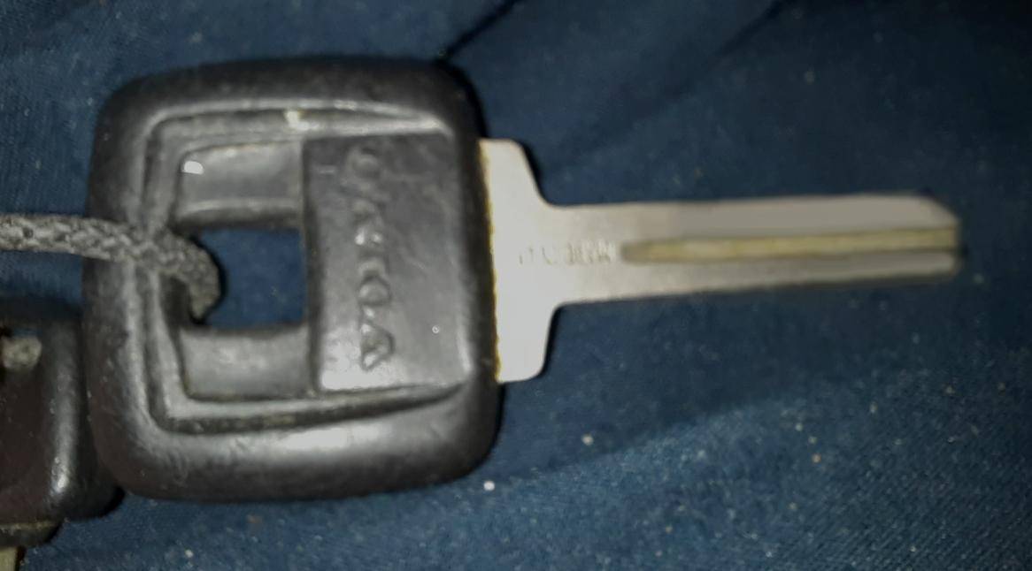

Anyway, here is a pic of my key on one side with the pattern of the key smoothed out so nobody can see the pattern, but the body of the key is not retouched.
Note it says "Made in UK" on that one side, and the other side is says "YMOS" or something like that.
Does this look like a regular key or transponder key?
When i look on the web for transponder and non transponder key they all seem to look the same.

This is not a transponder key.

You have a 98. No transponder.

That's what Steve said too but then somebody else came here to the forum and said they have a 1998 v70 and they have a transponder so i started wondering if some cars could actually have one. Then i read that maybe only in the UK not in the US so i guess mine doesnt have one. I am happy about that got enough problems without that too ha ha.
I had a feeling my key did not have one because that hole with the keychain goes is so large, taking up a lot of space where a chip could be hidden instead. The ones i see online have smaller holes.

Im just curious, how can you tell this is a non transponder key?
I have my guesses but still lost when it comes to this issue and dont own an X-Ray machine ha ha.
Oh i guess i could break the plastic open (ha ha). That would kind of ruin the key though.

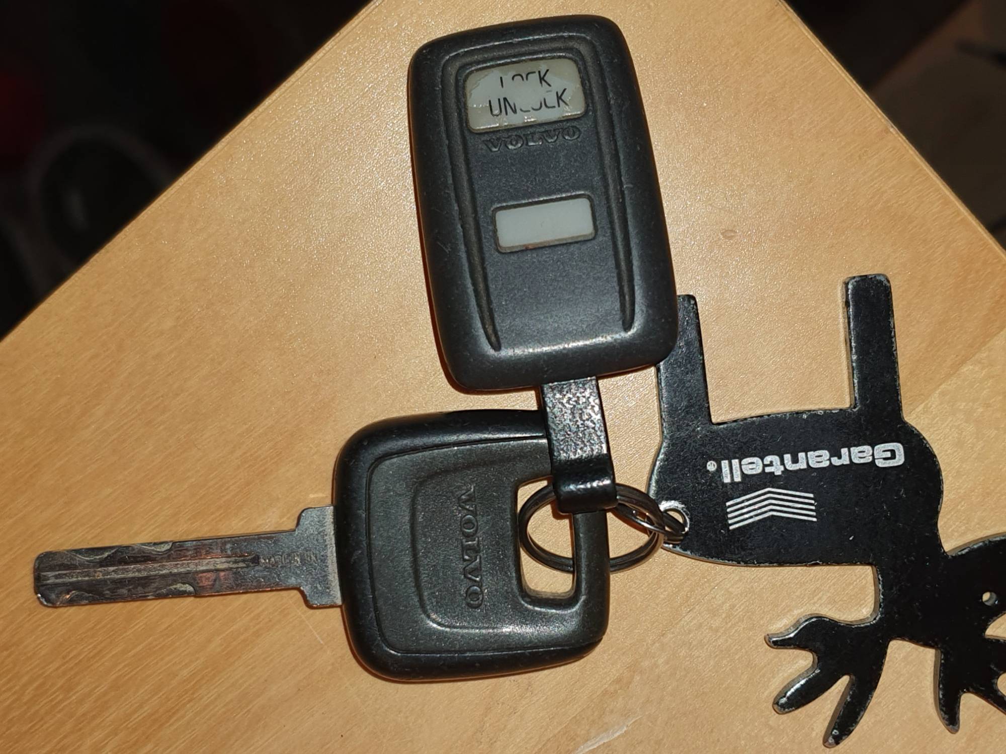

I can tell quite easily because this is the transponder key I have for my EU spec '96 R (EU spec Volvos got immobilizers in 1996, including the erratic kingdom which was part of of Europe back then). They needed to size up the key to make the transponder fit. It just won't fit inside of the old style keys. The other thing is the fob.

Clemens beat me to it. The black 'body' of the key is a lot bigger to hold the chip. Yours is not it.

Oh ok i see they do look different, i just wonder why the heck they dont mark them "transponder" that would be best i think.
I do have a key fob however.

Thanks for the pic.

Yes i do see differences now, the metal part going into the plastic part is much wider on my key.
Too bad they just dont mark them with the functionality like "transponder" or "not transponder".
