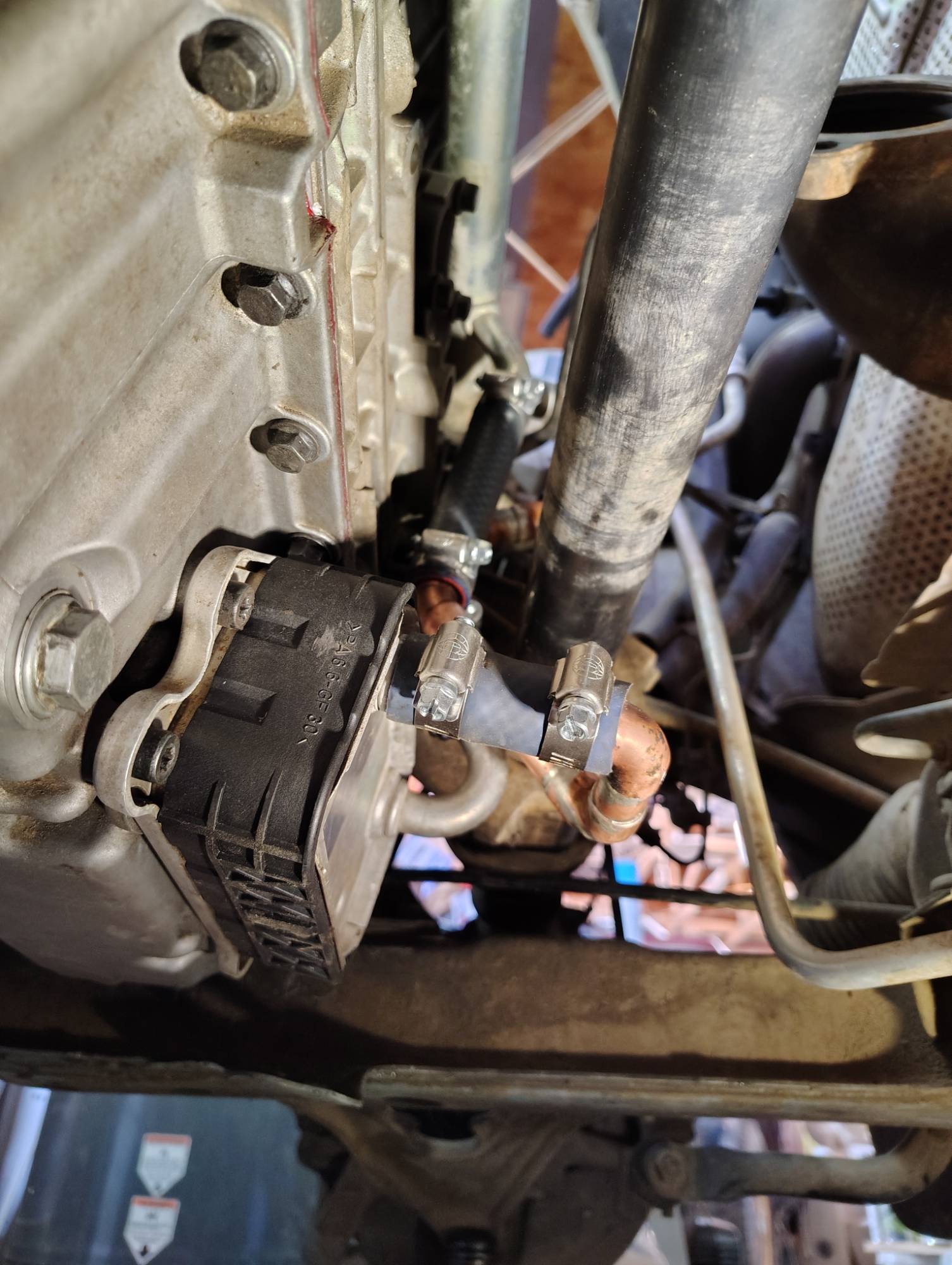

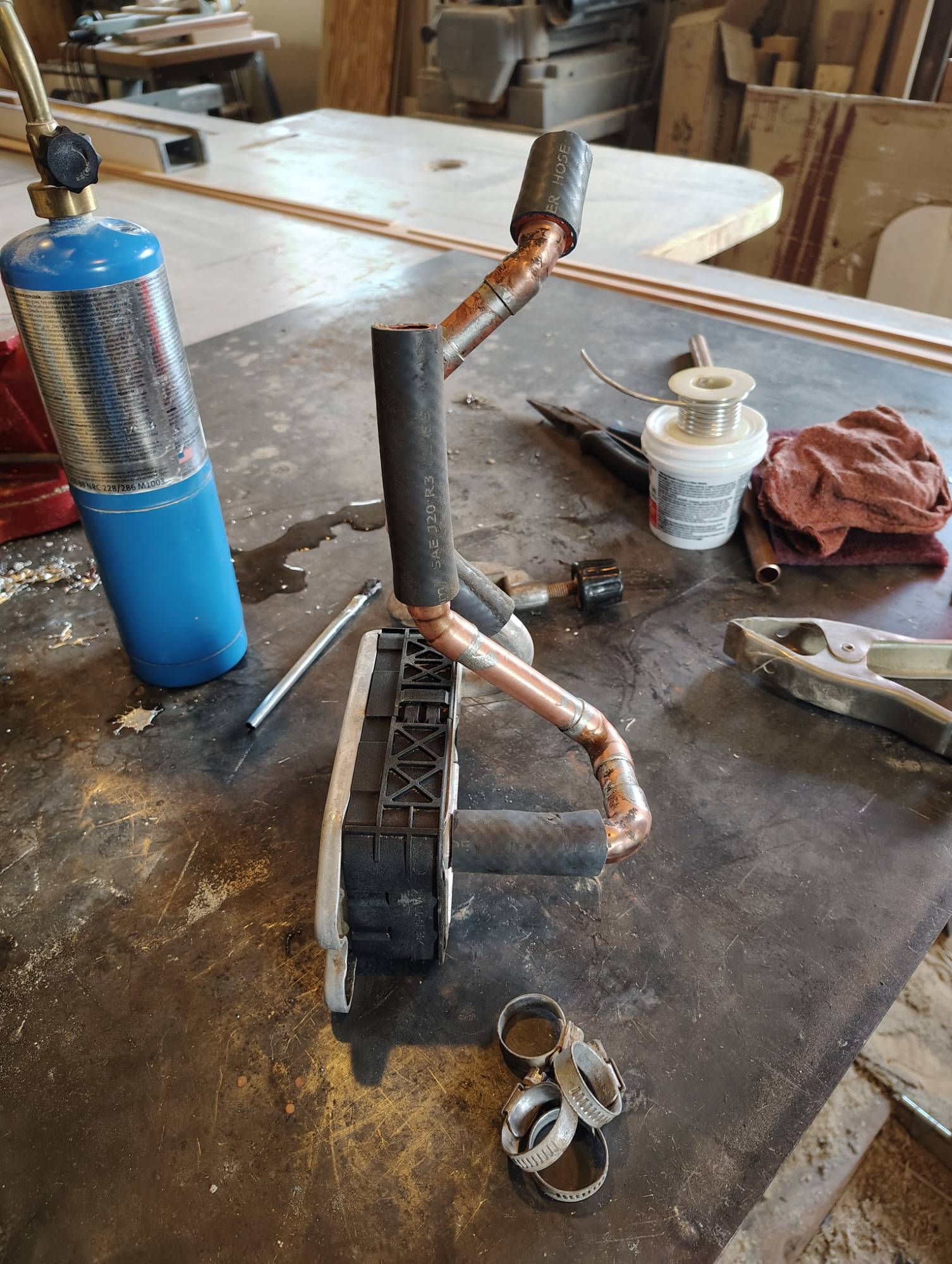

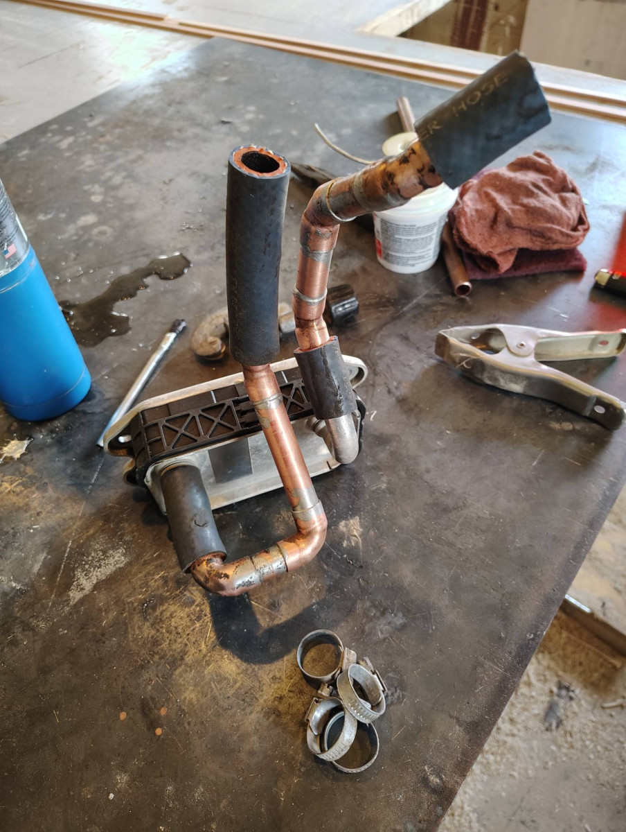

Just found out that the Volvo valve seals have to come from Sweden, unless I want to pay the supper outrageous price from a state side distributor. So I'm thinking that I will take the chance and try the Elring brand ones. If this was a fresh engine I might think differently, but the bottom end does have 161 on it, so these seals should last at least till I'm looking at a total rebuild.
In the mean time I made replacement oil cooler lines.
