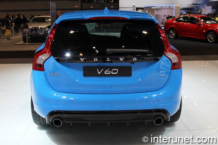

I got the itch again. I saw two nice mid-teens V60's In Colorado recently, one a T-6. You know, I did a specification comparo with a GTI 4-door, a car I also really like, and the GTI, with seats folded, has more room in the back than a V60 seats folded. Is that weird or what?

That rear cargo volume thing is bugging me. If you look at both cars...how can that be? But they measure that in pure volume of the entire shape. The Golf is boxier and taller, the V60 has a lower, sloping roof and tapered side glass and hatch, and I think that's where the difference is.
But often when you need to carry things, you need some length for long things, or a flat space for a big rectangular box, I generally don't pack the thing up to the roof. So, usable floor area might be bigger in the V60.

It's hard to beat the size and shape of an XC70 cargo area, and that's true of the P-3's as well. I became very fond of the V-90 wagon and thought it might be a good next car for me if I ever got tired of incinerating cash on my beloved XC70's. I was shocked at how small and unuseable the shape and size of the back area was. It would definately not accomodate 2 large breed dogs comfortably. The wife's XC60 is spacious but with a higher deck height.BlackBart wrote: 04 Nov 2024, 10:30 That rear cargo volume thing is bugging me. If you look at both cars...how can that be? But they measure that in pure volume of the entire shape. The Golf is boxier and taller, the V60 has a lower, sloping roof and tapered side glass and hatch, and I think that's where the difference is.
