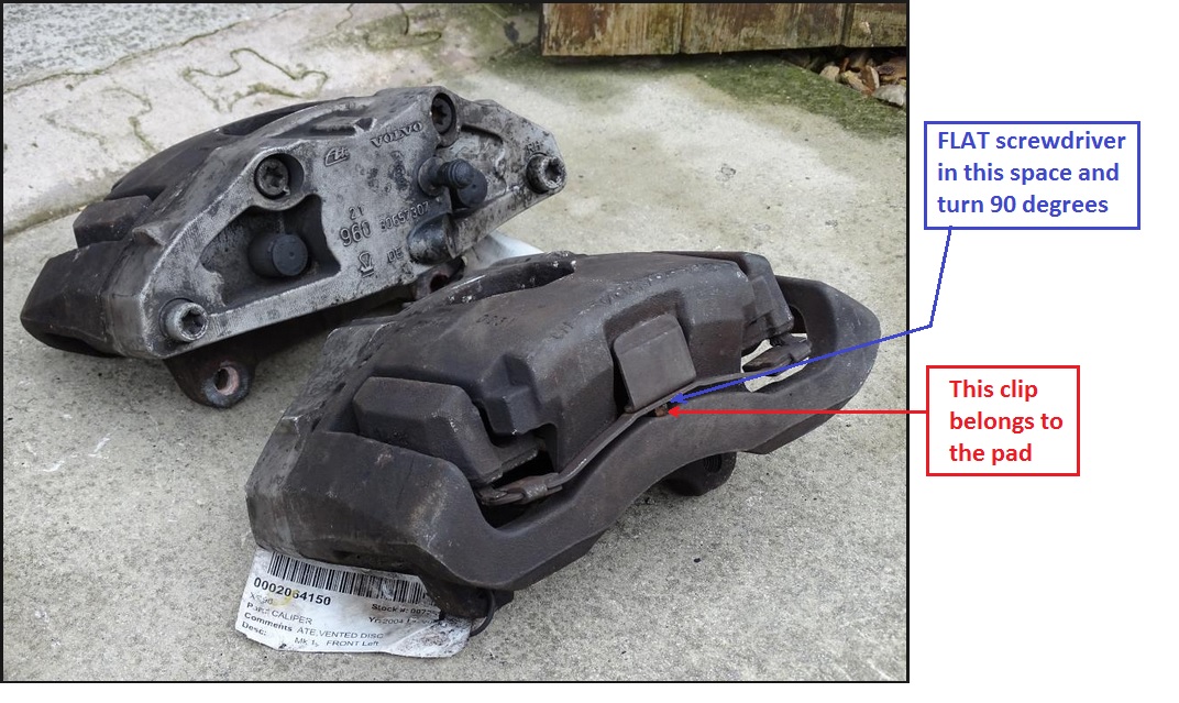

This is my first time working on our 2014 XC90 brakes. I've been reading as much as possible about the front brake job. Everything makes sense except that my front brakes don't look the same as in the older XC90 brake write-ups. The spring is significantly different. I've read differ post on removing the retaining spring, some say pry at the end others say pry in the middle, and another says be careful not to damage the spring. I'm used to my 850 retaining spring that pops right off. On my XC90 it feels like my screwdriver will break before the spring comes off. Others claim the retaining spring comes off easy.
I want the easy method. Do I pry on one end, in the middle, or some combination? Do I pry from the hub side or from outside the wheel?

1997volvo850 wrote:...others say pry in the middle, and another says be careful not to damage the spring...
I don't know about your 2014 XC90 model, but in the 2005 XC90, PRY in the MIDDLE as shown.
Look at the new brake pad (the OUTER pad), and you will have a good idea where to pry it.

Here's a photo of my caliper. After I return from the auto parts store with my Lisle 7mm I'll try to pry this baby off.
Displays with correct orientation when I enlarge. I'm not sure how to correct orientation in forum post.
