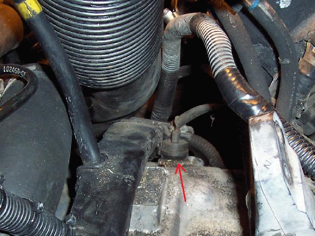

I followed the wires from the unknown connector and it led me to the item identified below.
I suspect this is the transmission speed sensor. I don't know why the wire colors don't match the wiring diagram which shows yel/wht and yel/brn but my wires are yel/vio and grn/yel.

That is the RPM sensor, not the Vehicle Speed Sensor. The VSS on the later models, '96 and on, is derived from the ABS module based on inputs from the wheel sensors.

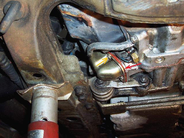

Today I determined the source of my ATF leak. It is marked with the red arrow in the photo below.
I thought it was possible just due to a loose bolt so I attempted to tighten the bolt identified with the yellow arrow. It was immediately appararent that the threads were stripped due to already having been overtightened. I've noticed while working on this engine that many of the bolts were tightened excessively for use on cast aluminum. I removed the bolt and noted it was rather short and tapered with worn threads near the head. I tried using a washer to avoid the worn threads but because of the short length there were not enough threads to hold. I found a longer M6-1.0 bolt and inserted it and tightened to a reasonable torque. The leak did not stop. There is insufficient room on the back of the casting to add a normal nut. I will either have to tap the hole to M7-1.0 or grind off a small enough portion of the casting for a nut. I don't see a gasket listed on VADIS to fit between the cover and the casting. It may just be sealed with RTF. I don't want to drain the ATF to fix the leak until after I get the engine running and test the transmission for functionality.

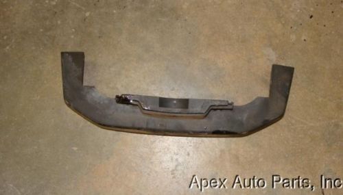

Does anyone recognize this part and know if it fits on a 96 turbo wagon? The seller thinks it came off a 95 turbo but doesn't know the specific location. It's listed as an engine cover guard on eBay.
I couldn't find anything in VADIS for my vehicle that looks like it but the photo is not very good for revealing the actual shape of the part. I'm trying to acquire all of the missing pieces for my wagon. Any help is appreciated!

That's the guard that goes up under the belly of the car to protect the radiator and AC components, etc from the road. I'd put it back in place - it helps with airflow and to protect those things. It's held in place by a screw at either side of the frame.
I can tell you it's NOT the one from a -70 series, so yes, it should fit :mrgreen:

I asked the seller the dimensions of the item and he responded approximately 8x3 inches. I finally realized it is the upper section of the timing case cover, PN 9146937. I know I need the front air guide, PN 6808693 and the protective casing, PN 9135445.

Whoops. They do look a bit similar without a scale to go by :D
