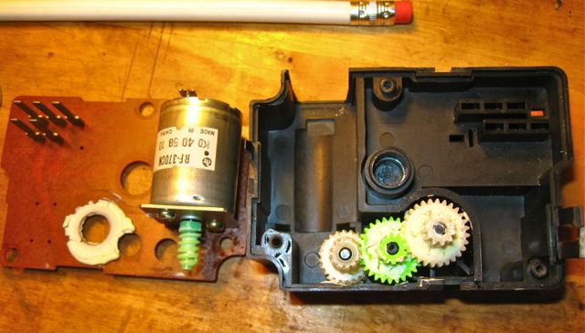

When I took mine apart I marked the position of the external gear on the case so I could replace it in the same position.
I looked through my photo archive for images of the position of the gear in the hopes that it would help you reposition yours, but I found that I didn't take any pictures of that stage of the work. Perhaps someone else can post up a photo of the gear in place.
I did find a picture of the caked-up, dried-out white lithium grease on the inside of the damper motor, which I think may have been the cause of the "Damper Motor Active Too Long" code I was getting. I cleaned out all the old grease and applied a light coat of fresh white lithium grease.
Old grease:
Old grease:
