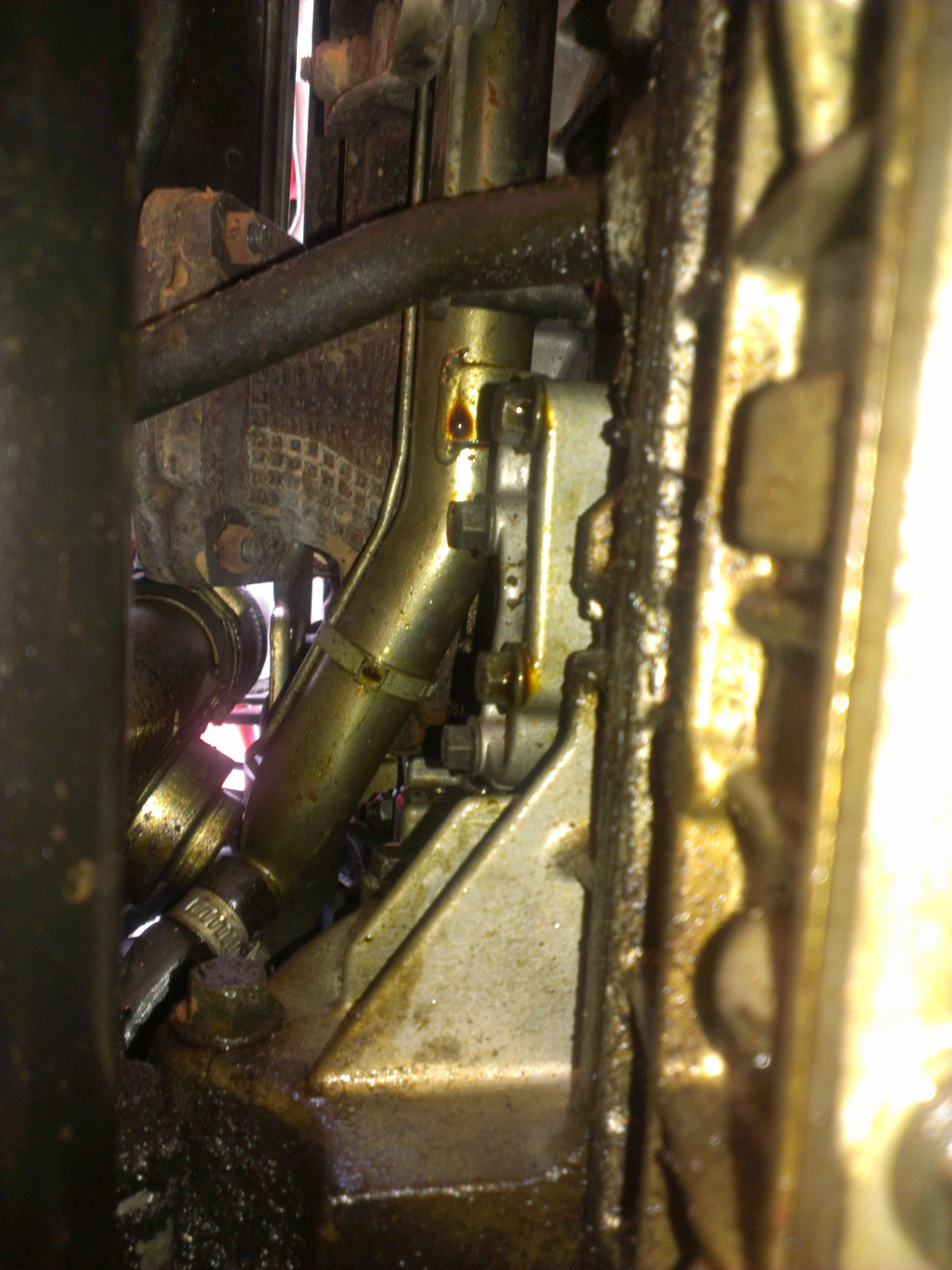

still have a small oil leak. maybe left over oil before PCV system was done. included a pic from where I think the oil is leaking from.
98 Volvo S70 T5 268K miles and counting.....!

Post by volvospeeds70 »
here is the pic
i tightened both of them bolts this morning, hopefully that will fix for now.

rspi
Posts: 7303
Joined: 5 November 2011
Location: Cincinnati OH
Has thanked: 34 times
Been thanked: 72 times
Post by rspi »
I had to replace the gaskets under those plates on the back of the motor on our S70 GLT. They are paperish and cost about $7 at the steeper.
volvospeeds70
Posts: 55
Joined: 2 January 2013
Year and Model: 1998 volvo s70 t5
Location: North Carolina
are you talking about the four 10 mm bolt plate? I tightened the lower two down.
